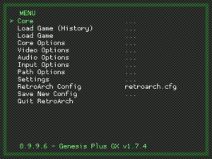

Once you open up the RetroArch GUI, you’ll see a bunch of options. In order to launch a game, all you have to do is navigate to the first option “core” and select the core you want to run.
Once that’s complete, you can navigate to “Load Game” and select the rom you want to launch. In some cases there are multiple cores that will work for one system. For instance, RetroArch comes with BSNES, SNESX9, and Mednafen cores for SNES emulation. Pick your favorite.

If not, you will need to load a core, change all your settings, and then “Save New Config”. This will create a config tied directly to the core you’re using and place that config in the retroarch/config folder. This is quite handy if you want to use different shaders for SNES than you do for NES. Let’s look at the two ways you can save config files in RetroArch, and when it’s appropriate to use either:
- You can set RetroArch to “automatically save configuration on exit”. This is under the “settings” option, and must be set manually. Once it is, RetroArch will save any changes you make to the settings in the retroarch.cfg (Or whatever other config you have open) every time you exit the emulator.
- You can also manually save a configuration by clicking “Save New Config”. This method allows you to save configurations for each core you’re using, and will save a config file named after the core in your retroarch/configs directory.

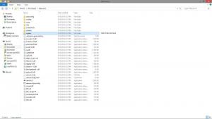

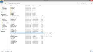

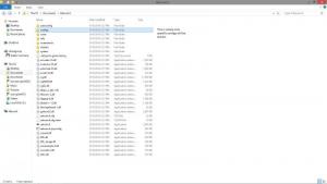

Saving Per Cores Settings For Use With Hyperlaunch:
This is the question most commonly asked. Once you have everything set up, you should have some per core configurations saved in your retroarch/configs directory. If you want Hyperlaunch to read those, make a copy of that file and rename the same name as your system name, and leave that file in the same directory.
Example: snes9x_libretro.cfg
(Copy this file into the same directory which will give you another file called ‘snes9x_libretro(1).cfg.’)
Rename ‘snes9x_libretro(1).cfg’ to ‘Super Nintendo Entertainment System.cfg’.
This process will have to be repeated if you change your settings again.
Remember, Hyperlaunch will then launch the Super Nintendo Entertainment System.cfg automatically. If you have "save changes on exit" ticked, RetroArch will save all your changes to that config and not the retroarch.cfg.

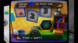

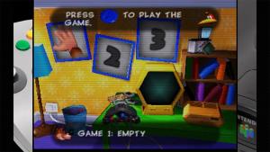

I personally think they look fine crystal clear; I also played originally on old tvs but that looks muuuuuch better to me than simulated scanlines. I prefer them without if the display is an Lcd.
I'm a ways off getting this fine tuned but here's a comparison. We should have a Scan lines, for and against pole.
With.
Without.

I have just set that up and was quite simple.
I just chose the core which is the picodrive core.
Went into settings>video and set aspect ratio to 4:3 (1.1 Par) I use bezels so I don't need full screen.
I then went back to the main menu and save the new config, you can then go in to the config folder and rename it to "Sega 32X" for Hyperlaunch.
To test select load content for Picodrive and chose a Rom.
I would recommend not choosing any shaders to begin with until you have it working.
It's also possible that you don't have the bios file which possibly go in the system folder. Please correct me if I'm wrong on that point.
