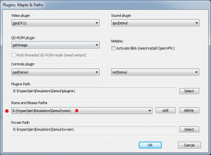

gigapig Posted October 9, 2014 Posted October 9, 2014 I'm guessing it's a bios issue,I looked inside and the bios file I had and unzipped into the rom folder is labelled different , all as "DC - BIOS. Bin" "DC - BIOS(all).BIN" Plus a few others such as flash but they all start with DC. I'm guessing that's the problem?! You'll need to either set the path to the bios or drop it into to where you specified. As you can see my dc.zip bios resides in with my Demul Roms.

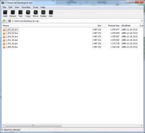

thenoob Posted October 9, 2014 Posted October 9, 2014 Yup the path is right, I think I just don't have the correct bios. Is there somewhere where the correct bios can be found? I've tried a few, and they are all different names, I obviously don't have the right set
gigapig Posted October 9, 2014 Posted October 9, 2014 The bios zip looks like this. A search for "Demul Dreamcast Bios" should get you what you seek.
