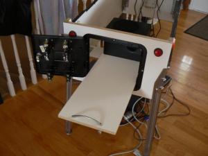

Typefighter01 Posted October 19, 2011 Author Posted October 19, 2011 Got computer drawer done. Here is a few pics...
Numiah Posted October 20, 2011 Posted October 20, 2011 Sweet ! **Each pinball machine is a tiny universe... that we control** My Build Overview My Computer Specifications

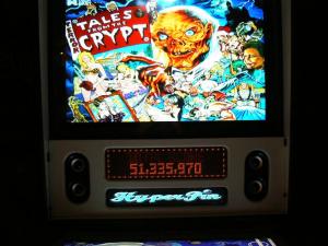

Typefighter01 Posted January 29, 2012 Author Posted January 29, 2012 Here are a few pics of it in action. I hit F11 during game play and this is what I got. At idle 1600, during play, between 1300 and peaking at 3000. Don't know how relevant these numbers are, but considering the ATI cards, might be useful to devs or someone else planning a cab. I love the little DMD I added below the regular one. I added the Hyperpin logo to it, and it adds so much character, I am so glad I did it. First pic cab in action, last pic the computer mounted to the drawer.
chriz99 Posted January 29, 2012 Posted January 29, 2012 can you test your fps with jp salas new white water: http://www.vpforums.org/index.php?automodule=downloads&req=idx&cmd=viewdetail&f_id=6092 tales from the arabien nights: http://www.vpforums.org/index.php?automodule=downloads&req=idx&cmd=viewdetail&f_id=3665 and attack from mars: http://www.vpforums.org/index.php?automodule=downloads&req=idx&cmd=viewdetail&f_id=4577 cheers chris [sIGPIC][/sIGPIC] * taito egret 29 candy cabs * indy & star wars pachinkos 17" bartop with ledwiz rgbleds * 10" bubble bobble & galaga bartop * arm champs 2 check out hi-res backglasses * best vpin performance * ledwiz config and software
Typefighter01 Posted January 29, 2012 Author Posted January 29, 2012 Having looked at the three tables, I think I see where you are going with this. I like the look of the White Water, so I will try it first, give me an hour. Just tried playing Star Trek The Next Gen, and it was a fail (not sure why, so I gave up)....
Typefighter01 Posted January 30, 2012 Author Posted January 30, 2012 Results are in: White Water (Alpha slider all the way to the right) 100 fps idle, 120 fps in play White Water (Alpha slider all the way to the left. ) 160 fps idle, 170 fps in play Also down loaded Funhouse Funhouse - 800 fps idle, 850 to 1000 fps in play I see a trend hear (you guys probably already know this), the more transparent ramps in game, the less fps. Having said that, I have to say, White Water looks and plays fantastic. All objects and ramps look to be rendered perfect. No stuttering, glitches, nothing. Ball looks the best out of all three games too. Chriz99, is there any particular changes you would like me to try (I am not experimenting with drivers though, they will stay at 11.10 ). I have to say, the ATI cards have been nothing but a dream since day one. Didn't even have to set them for monitors 1,2,3 in settings, they just happen to be defaulted that way. Chriz99, there is a setting in the AMD Control Center (its not call Catalyst Control Centre anymore) called "Use GPU for scaling", I tried it with Tales From the Crypt when I was trying to enable HD Rendering. Do you think there is any benefit to checking off this box, or will it probably not make a difference?

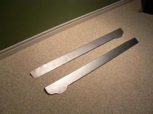

Typefighter01 Posted February 20, 2012 Author Posted February 20, 2012 Update! Playfield glass has arrived. Also, had a local machine shop bend me up some side rails. I did not want the flipper buttons to sit below the rails so they gave me some extra material to play. I cut the rails so there is a little pad for the buttons to sit on, should help it look a little more custom. Playfield glass is 3/16" or 5mm. Side rails are 20 gauge mild steel and cost me $60. I think side rails are probably thicker then 20 gauge (I am thinking 18) but any thicker and you will have a hard time cutting and forming them at home. Lockdown bar ordered, will post picks when it arrives.

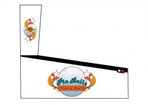

Typefighter01 Posted March 17, 2012 Author Posted March 17, 2012 Finally have a name for this build, "Pin Ballz". Searched Google to see if anyone has used this name, and the only hit I got was for a pinball/arcade located in Texas (website says it is BYOB, now that is my kind of arcade ). Since the cab is done in melamine, it dosn't make sense for me to do a full wrap (this was the whole point of using the melamine). I can print on adhesive vinyl up to 11 1/2 x 17. Basically make some big decals. I wanted a very generic theme that was 60's and 70's inspired. It is done in Inkscape SVG. I showed my wife, and she said "It looks OLD". This is how I knew I had done the job right. Here is an example of what it will look like....please go ahead and critique it.

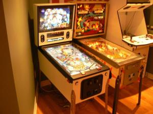

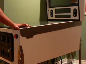

Typefighter01 Posted December 8, 2013 Author Posted December 8, 2013 Side rails painted and installed. Painted them in black hammered metal finish, matches the coin door perfect. Lock down bar is a Stern item in a textured black finish and I have all my buttons installed, just need to add labeled inserts. Still need to add side art, not sure if I will go with my original idea above or do a new theme with full wraps. Here is a pic of its current state sitting beside my real pin.
kizam33 Posted December 14, 2013 Posted December 14, 2013 very nice, looks clean! I have seen a blackie on here , maybe this one can just be Whitey.
