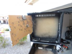

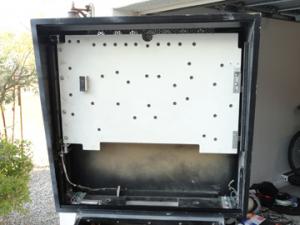

bublehead Posted January 22, 2012 Posted January 22, 2012 Well this is going to be my official build thread for my cabinet. The story so far: I have a gutted Rollergames cabinet with all hardware... I have my displays and my computer: Vizio E370VP LED 37" for playfield Samsung T27A300 LED 27" for backglass AOC E1621SW LED 15.6" for DMD Intel Core I5 2500K 3.3ghz MSI P67a-gd65 B3 motherboard G.SKILL Ripjaws Series 4GB (2 x 2GB) 240-Pin DDR3 SDRAM DDR3 1600 EVGA 01G-P3-1372-TR GeForce GTX 460 Superclocked 1GB Graphics Card (PF & BG Display) Galaxy - GeForce GTX 460GC Superclocked 768MB Graphics Card (DMD & 4th monitor) OCZ Vertex 3 VTX3-25SAT3-90G 90GB SATA III SSD Western Digital Caviar Blue WD5000AAKX 500GB 7200 RPM 16MB Cache SATA 3 Hard Drive ASUS BD-R/DVD-R/CD-R 12X/16X/48X SATA Combo Drive CORSAIR H80 (CWCH80) High Performance Liquid CPU Cooler CORSAIR TX750 750W PSU Still need: Mot-Ion Adapter board and Digital Plunger LED-Wiz H bridge Shaker motor LED's and heat sinks and lenses Cabinet switches Cabinet Art Backglass Bezel Speaker Panel (Mameman CNC) 26" Vizio E261VP HDTV 12V/24V power supplies force feedback contactors More info to come....

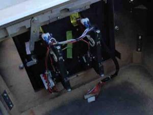

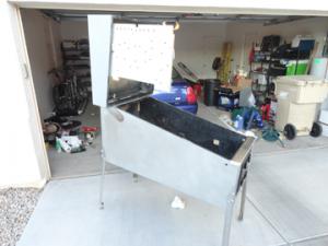

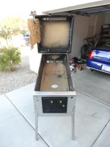

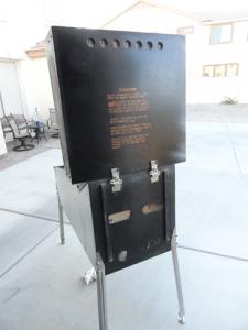

bublehead Posted January 24, 2012 Author Posted January 24, 2012 Just posted some pics of the Rollergames cabinet in the original post... BH
