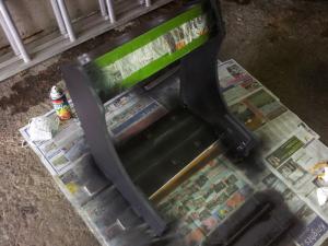

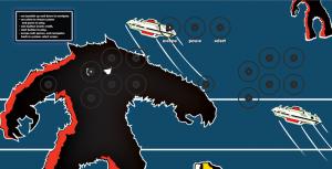

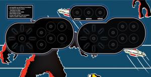

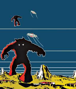

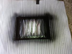

mikekim Posted February 18, 2012 Author Posted February 18, 2012 started spraying the glass bezel and cab today. using plasticote matt black & frog tape as per Chunksin's recomendation. I have also attached the final details of the side and control panel artwork. the left and right sides will be a mirror image (most of the empty Blue space will be cut out due to the side shape of the cab) if I have measured correctly the image should flow continuously from the control panel, to the front panel.

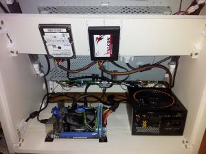

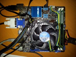

richie_jones Posted February 19, 2012 Posted February 19, 2012 Hi Love the cab. Ive been lurking around for a while. Ive bought all my bits etc and have my doner pc set up with hyperspin ready to go. i plan on a bartop similar to yours which i presume is based on the weecade. my question is do you think id be able to fit a full size atx motherboard inside, and if not how much more room do you think id need.. Think i might have to make a mockup out of cardboard first. Sent from my GT-I9100 using Tapatalk
adam763 Posted February 19, 2012 Posted February 19, 2012 Have you had the CPO printed yet..? I only ask because it looks kinda wrong where you've placed the P1 & P2 layout over character images... I'd suggest using the background with the monsters and space ships - i.e; plain blue with the horizontal white stripes. And then put your instructions/button layout back over the top... Just a suggestion, but I think It'll look way cooler like that... Building custom cabinets since 2006..!!
mikekim Posted February 19, 2012 Author Posted February 19, 2012 Have you had the CPO printed yet..? I only ask because it looks kinda wrong where you've placed the P1 & P2 layout over character images...I'd suggest using the background with the monsters and space ships - i.e; plain blue with the horizontal white stripes. And then put your instructions/button layout back over the top... Just a suggestion, but I think It'll look way cooler like that... Adam, the cp hasn't been printed yet, so it shouldn't be a problem to change. HiLove the cab. Ive been lurking around for a while. Ive bought all my bits etc and have my doner pc set up with hyperspin ready to go. i plan on a bartop similar to yours which i presume is based on the weecade. my question is do you think id be able to fit a full size atx motherboard inside, and if not how much more room do you think id need.. Think i might have to make a mockup out of cardboard first. Richie, this is a slightly different design to the Weecade. I should be able to scan in some measurements of the plans, the only dimensions missing are the sides on the instructions. the unit base is 470mm x 230mm for reference.
richie_jones Posted February 19, 2012 Posted February 19, 2012 Adam,the cp hasn't been printed yet, so it shouldn't be a problem to change. Richie, this is a slightly different design to the Weecade. I should be able to scan in some measurements of the plans, the only dimensions missing are the sides on the instructions. the unit base is 470mm x 230mm for reference. Thanks a scan would be great, id like to keep the same proportions youve got but i think ill need to add a few inches on all dimentions. i could mount the power supply on the side above the motherboard and have the whole base for the motherboard.
Guest mrbell1984 Posted February 19, 2012 Posted February 19, 2012 @richie_jones I don't think a full ATX board will fit in as this is a very tight case. I used a mATX board.

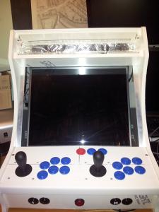

richie_jones Posted February 19, 2012 Posted February 19, 2012 My board measures 300x240 but i presume your measurments include whats lost under the control panel. it would be tight but as im building it myself i can hopefully add some inches on without losing the nice lines that this case has..

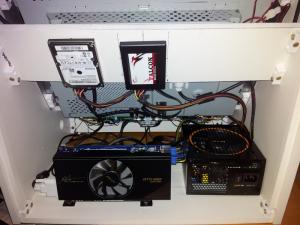

adam763 Posted February 19, 2012 Posted February 19, 2012 Keep an eye on the cooling. I fitted an ATX mobo inside one of my control panels (also a cramped space) and two fans (one sucking, one blowing) were not sufficient to keep it cool!! Building custom cabinets since 2006..!!
richie_jones Posted February 19, 2012 Posted February 19, 2012 Thanks for the tip adam..its a duel core duo 2.5g no overclock. Im hopeing to cram in a fan controller that ive got spare that will hopefully ramp the fan speeds up and down as needed. Ill be posting a build thread when i finally get started so if theres fire then ill hopefully get some pics!!!

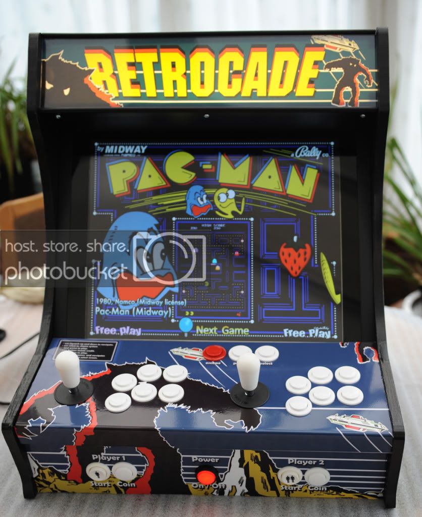

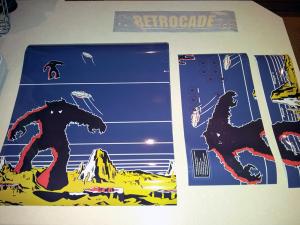

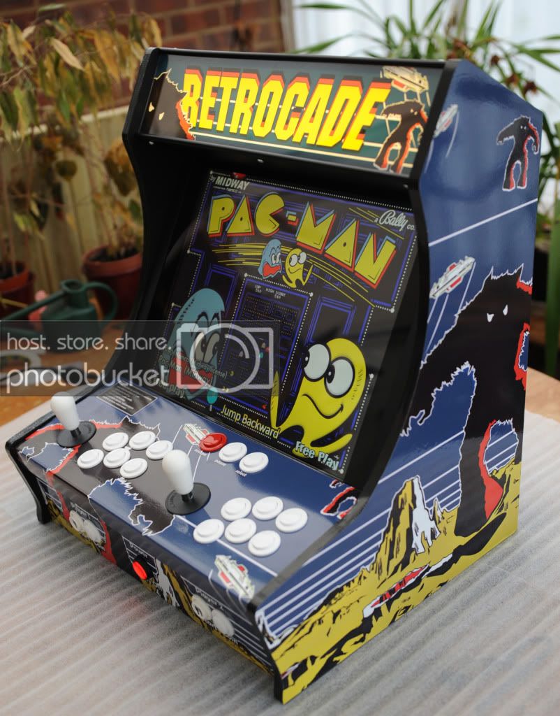

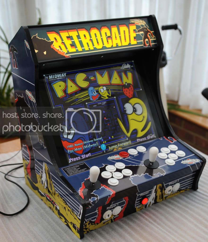

mikekim Posted March 12, 2012 Author Posted March 12, 2012 Update of work so far: Major progress today...... The artwork has arrived. Many thanks to Lucian045 for all his work with printing and prompt shipping, a fantastic service that for anyone looking for artwork printing for their cabs. I have also finally gotten around to sorting out all the Megadrive (Genesis), Playstation and Dreamcast roms that will be run in my cab (around 50 for each system). So hopefully i should have it pretty much finished by the weekend.

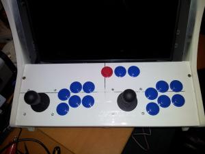

Guest mrbell1984 Posted March 14, 2012 Posted March 14, 2012 Ah mike. Is it possible to have a copy of your control panel decals please? I was unsure how to start since you have the same control panel layout as me it would help a lot. I am going to share my artwork in my thread and once I am done make a long write up. Thanks mate.
mikekim Posted March 15, 2012 Author Posted March 15, 2012 Mrbell, I can upload a photoshop template for you to use. You will need to move the button layer slightly as my panel arrived blank (on request) as at the time i wasn't sure what layout i was going to use. Sent from my GT-I9100 using Tapatalk

Guest mrbell1984 Posted March 15, 2012 Posted March 15, 2012 ah damn! I wish I requested mine to be blank. Mine come pre-drilled. I tried to contact the developer of the kit but got no reply regards to the panel layout designs!
richie_jones Posted March 15, 2012 Posted March 15, 2012 ah damn! I wish I requested mine to be blank. Mine come pre-drilled. I tried to contact the developer of the kit but got no reply regards to the panel layout designs! You could always plug the holes then when covered with your artwork you'd never know. Screw thin ply underneath and fill top with wood filler...
mikekim Posted March 15, 2012 Author Posted March 15, 2012 link to template https://www.yousendit.com/download/M3BsOGNhU1BCSWZFdzhUQw
mikekim Posted March 17, 2012 Author Posted March 17, 2012 update: 95% completed. just the single power lead to sort out and a couple of videos and wheel images to download.
richie_jones Posted March 17, 2012 Posted March 17, 2012 Wow mike. I think this is the best looking bartop I've seen. artwork really brings it to life. job well done !! Where did you put your speakers?? Also how are you controlling volume..
