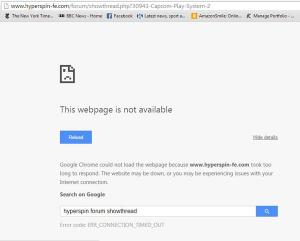

strawdog Posted January 14, 2015 Posted January 14, 2015 Can you post the output you get when trying to connect? sure,
phulshof Posted January 15, 2015 Posted January 15, 2015 It seems to be a problem caused by the combination of a reverse proxy (to handle both websites at the same IP address) in combination with DNS. You might want to contact your ISP, and ask them to help you solve this riddle (after setting back your original DNS settings of course). I'm afraid this goes slightly beyond my knowledge.
