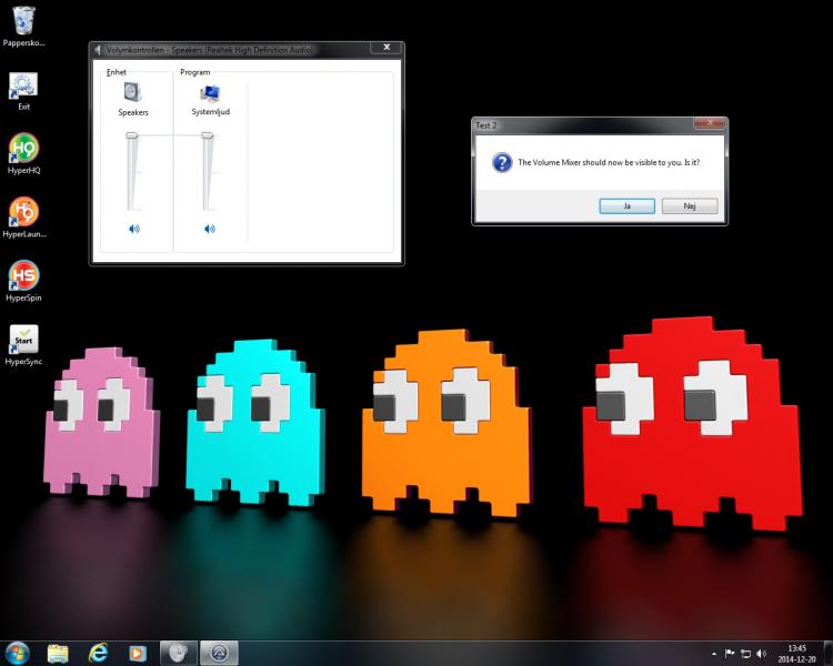

Note2: You can download Tur-Test_AnotherIdleVolumeAdjuster.zip first. It will run a number of tests to make sure all features of the program works on your machine.

I can run SndVol.exe Before starting the app. When running the app nothing happens when I try to run it. I can however see the SndVol.exe in processes. And after killing the process I can access the volume Control again. I can't find Volume Control options in applications.
Ok. One more test if you would.. On the FTP in my signature in Tur-AnotherIdleVolumeAdjuster\Test_Versions, download all of them. The ones marked _1 opens SndVol.exe in the same way as the Anti Idle program.
So first
Run open_sndvol_1_x86.exe. Check that it does not open SndVol.exe (If it does, let me know). Kill SndVol.exe in processes.
See if running open_sndvol_1_x64.exe makes any difference. Its the same program ,just compiled for 64 bit.
Also let me know the result from open_sndvol_2_x86.exe and open_sndvol_2_x64.exe - Interesting if they produce the same result.
Also check if there is a difference if you run it as administrator.

When Test 2 is running and it opens the volume mixer, can you have a look at the Volume mixer? What is the exact title of it? If possible, take a screenshot...
In the meantime, I'll make a new testfile..
