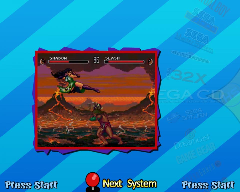

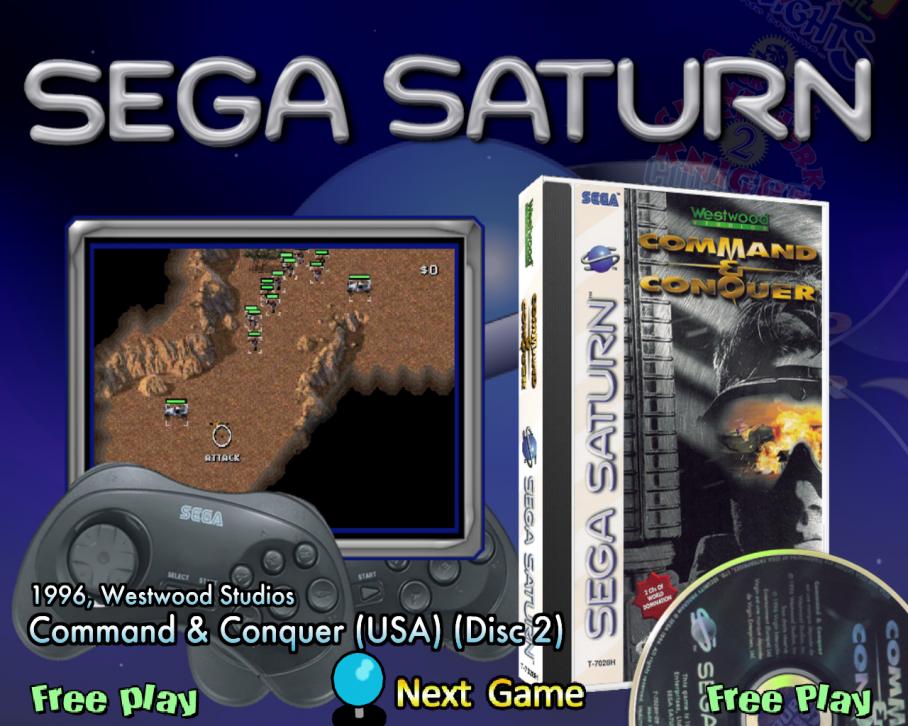

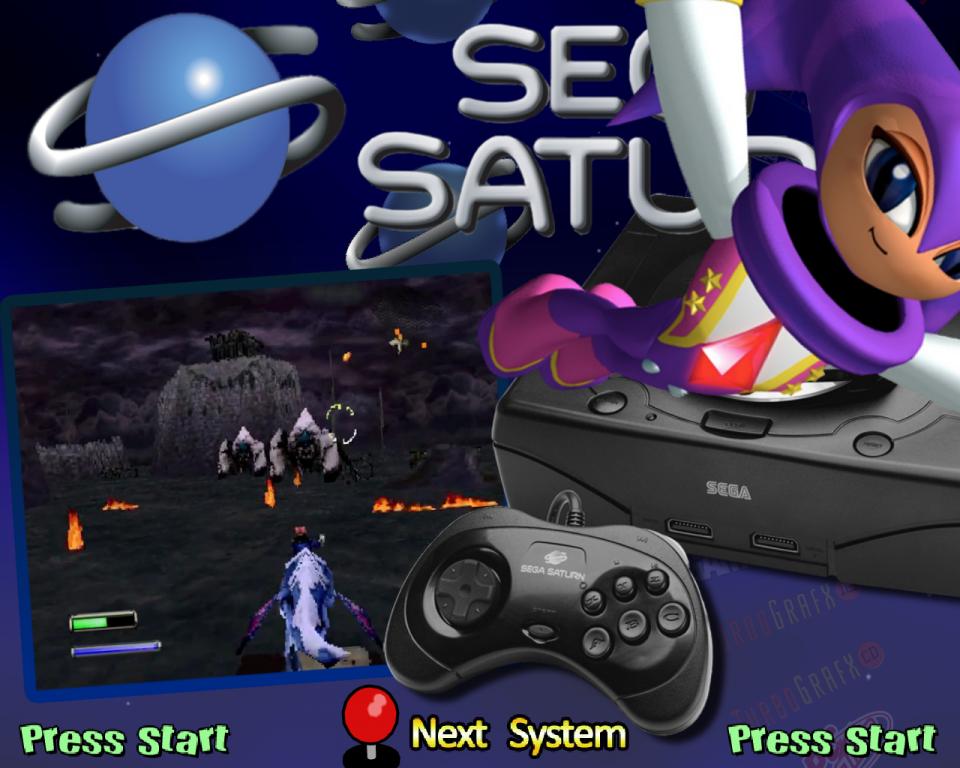

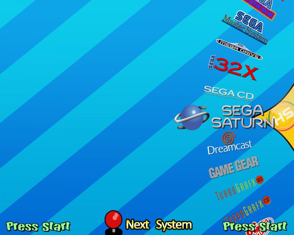

Dime333 Posted December 21, 2014 Posted December 21, 2014 I don't have reload backgrounds set for any of my Wheels. But there is no such setting available for the main menu. You have to choose a system for it to appear. I did some more testing. I started the app and switched between Sega CD and Sega Saturn 25 times. Worked flawless every time. I then waited for the volume to go down Before switching between the two and every single time, I got the theme load error. See Pictures. Picture 1 is normal Sega CD theme. Picture 2 is what happens when the volume has gone down. Picture 3 is normal Sega Saturn theme. Picture 4 is what happens when the volume has gone down. I tried to set reload backgrounds on my Sega Saturn Wheel. But the problem is still there. The Cover and Disc is not showing. If i switch Before or during the volume fade, it works as normal. But if I do it after the fade, I get this error every single time.
Turranius Posted December 21, 2014 Author Posted December 21, 2014 No idea what could be causing that.. Grab 1.3.1 and see if it makes a difference with NeverCloseSndVol=True (see previous post) Could be something with IdleFlash perhaps.. also try EnableIdleFlash=False Can not replicate it no matter how much I try.. Hyperspin windowed or fullscreen etc. Nothing wrong with any wheels.. main wheel or system wheels all work fine after coming out of idle. Mame related stuff: FTP: grandis.nu, port 21, user:misc, pass:misc http://grandis.nu/software Tur-Matcher - Match your roms/media/XML files. Another Idle Volume Adjuster - Automatically control the volume. How to: Use MAME Extras as material for HyperPause How to: Use eXoDOS 2.0 as material for HyperPause
Dime333 Posted December 21, 2014 Posted December 21, 2014 You nailed it, man! With 1.3.1 The freeze is gone and no more errors when loading themes. I don't even wanna Think about what the hell could have caused that issue, but it's prefect now. Thank you very much.
