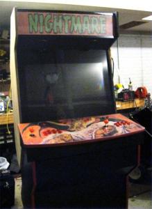

TheIronRachel Posted March 24, 2012 Author Posted March 24, 2012 Found a mounting solution for the monitor finally, and the thing sits in there pretty as can be. Also got the bezel cut to size and put in place. I can't wait to take that damned protective coating off so it doesn't look so dirty and grungy. I'm gonna wait until the very end to remove it, just so I don't run the risk of scratching the plexi all to hell. Those who restrain desire do so because theirs is weak enough to be restrained

TheIronRachel Posted March 25, 2012 Author Posted March 25, 2012 Removed the gross plastic film from the bezel, and it looks SO much better! Also tried out the monitor, and installed the marquee light. I get to pick up my CPO art tomorrow, and then I start drilling some holes for buttons! Does anyone know if it would be okay to drill a 1 1/8" hole for a Sanwa JLF stick, or should I try to adhere to the 24mm suggestion? Those who restrain desire do so because theirs is weak enough to be restrained

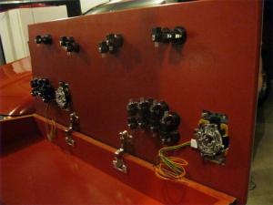

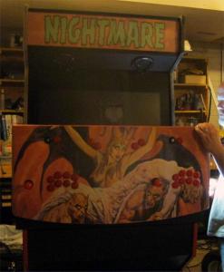

TheIronRachel Posted March 26, 2012 Author Posted March 26, 2012 Some more progress. Used forstner bits to drill the CP holes. Used a RotoZip to rough out the holes in the plexi, so that we could get the flush mount laminate router bit in there and finish it off. Also used the RotoZip to help install the slightly recessed hinges for the CP box. And we FINALLY have some artwork! Unfortunately, I have to rebuild the %$#&!@* control panel box tomorrow because I didn't move the joysticks and buttons in enough, and there's not enough room inside. Live and learn, I suppose. Those who restrain desire do so because theirs is weak enough to be restrained

gbeef Posted March 27, 2012 Posted March 27, 2012 If you go this route make sure the whole cabinet has dots including side and marquee so the style fits. Nice work so far. TheIronRachel said: So, as I mentioned before, I have a contact who was able to scan the original cover art that I want to use for my sides and CPO. He scanned the images at 1200 DPI and sent them over. Since these magazines were printed in the 70s, they used dot patterns instead of solid areas of color. This is a closeup of the image, zoomed in to 75% to show the dot pattern.All that said, do you guys think this will make for a nice print, or is it gonna look like crap? My Cabs My Pin Cab Attack of the PINZ cab My Racing Cab OutRun Racing
TheIronRachel Posted March 27, 2012 Author Posted March 27, 2012 gbeef said: If you go this route make sure the whole cabinet has dots including side and marquee so the style fits.Nice work so far. I actually printed the CPO already, and you can see the dots, but they're not distracting. If you view it from a distance, you can hardly even tell it has a dot pattern at all. The whole thing is going to look really good when I get all of the artwork printed. Right now, there's a $1,200 shipping bill staring me down, so it's gonna be a while before I can finance the art. I gotta send out issues of my comic, so I can keep the day job thing going. Those who restrain desire do so because theirs is weak enough to be restrained

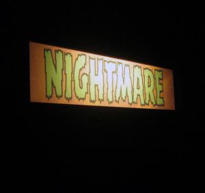

TheIronRachel Posted April 11, 2012 Author Posted April 11, 2012 Sorry for the crap quality on these pictures, but I finally received the marquee, joysticks, and buttons! All that remains now is the side art, IPAC, and LEDWiz. I am selling my comic and signing at a convention in Chicago this weekend, so maybe I'll make enough scratch to buy those last few components! Here's hoping! Those who restrain desire do so because theirs is weak enough to be restrained
