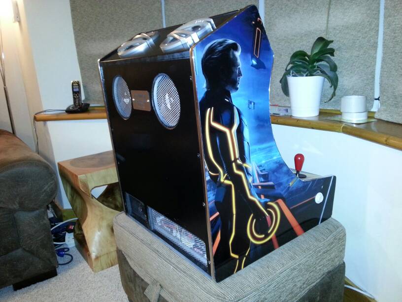

Lucian045 Posted November 4, 2012 Posted November 4, 2012 Nice job on your build Rich! To get that bubble out of the marquee, poke it with a new exacto knife blade and press. Otherwise, leave it out in the sun for a couple of warm days and the material should tighten a bit and the bubble will come out eventually. Poking the bubble shouldn,t damage the graphic though so I would just do it that way. Great job applying the graphics.
richie_jones Posted November 4, 2012 Author Posted November 4, 2012 Thanks Lucian...I'm afraid we don't get any sunshine in the UK so definitely gonna have to burst it with a knife..
Johns Uncle Posted November 4, 2012 Posted November 4, 2012 wow congrats thats a mighty fine looking bartop !
spec Posted November 4, 2012 Posted November 4, 2012 this is sick!! probably gonna be one of my next builds..check out my cab the green machine, just posted great work

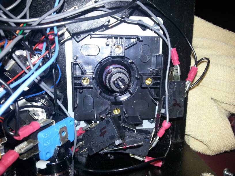

richie_jones Posted November 4, 2012 Author Posted November 4, 2012 Thanks for the comments guys.. I have a issue with my P1 joystick. It's started to feel really rough and Unsmooth in its travel. I've stripped it down as in the picture and am looking for advice on how to solve it. Can I slack Some tension off the spring
richie_jones Posted November 4, 2012 Author Posted November 4, 2012 Fixed now.......Just greased them up and there fine..Doh!!

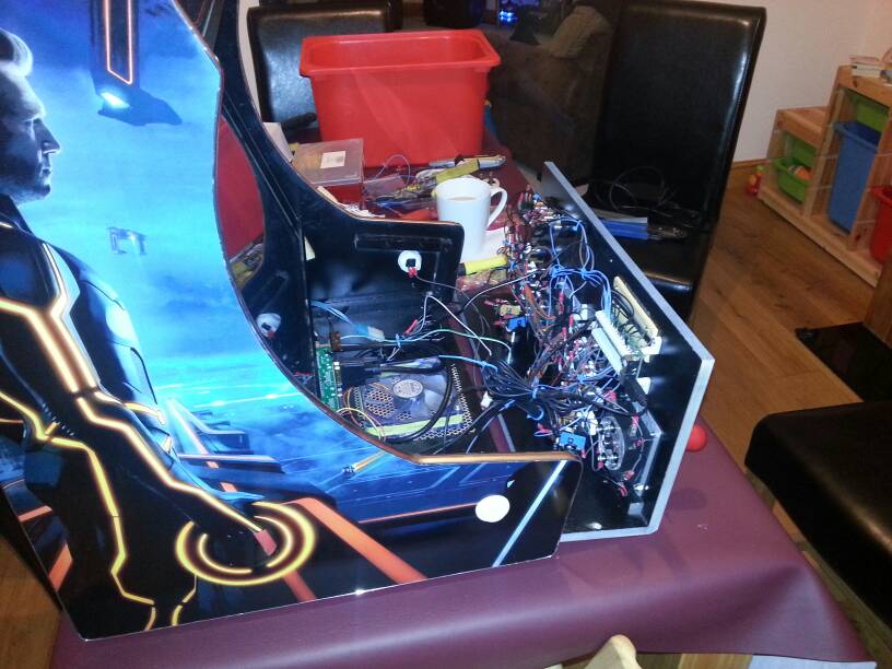

richie_jones Posted November 4, 2012 Author Posted November 4, 2012 Shot of the cp. Just before refitting. .
Lucian045 Posted November 5, 2012 Posted November 5, 2012 Damn that artwork is sexy! Glad to see it arrived in one piece to the UK

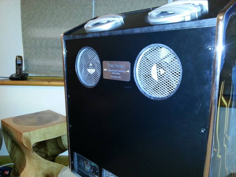

richie_jones Posted December 10, 2012 Author Posted December 10, 2012 Some back shots with acrylic etched name plate.. Starting some work on the rear panel to fix some neutrix usb ports and a network port. The cab is wi fi but I'm not impressed by my download speeds..
ericleroi Posted December 10, 2012 Posted December 10, 2012 Very nicely finished off at the back there and the name plate is a nice touch. Great job
monkeychunkuk Posted December 11, 2012 Posted December 11, 2012 Looking really good, were did you get the etched plate done?????
jq_quint Posted December 11, 2012 Posted December 11, 2012 Very nicely finished off at the back there and the name plate is a nice touch. Great job Agree with eric, love the meshing, simple yet effective...... Can't wait to start my bartop (need to finish my main cab first), love the "detail touches" on this build Rich....
richie_jones Posted December 11, 2012 Author Posted December 11, 2012 Thanks guys Link to eBay for etch acrylic I cant recommend this guy enough, his etch plates are top quality and really leave your mark for years to come on your arcade machine, be it a bartop or full size. Who knows who will own your machine in the future allways nice to have your name on it... http://www.ebay.co.uk/itm/150940003530?var=450138736894&ssPageName=STRK:MEWNX:IT&_trksid=p3984.m1439.l2649
