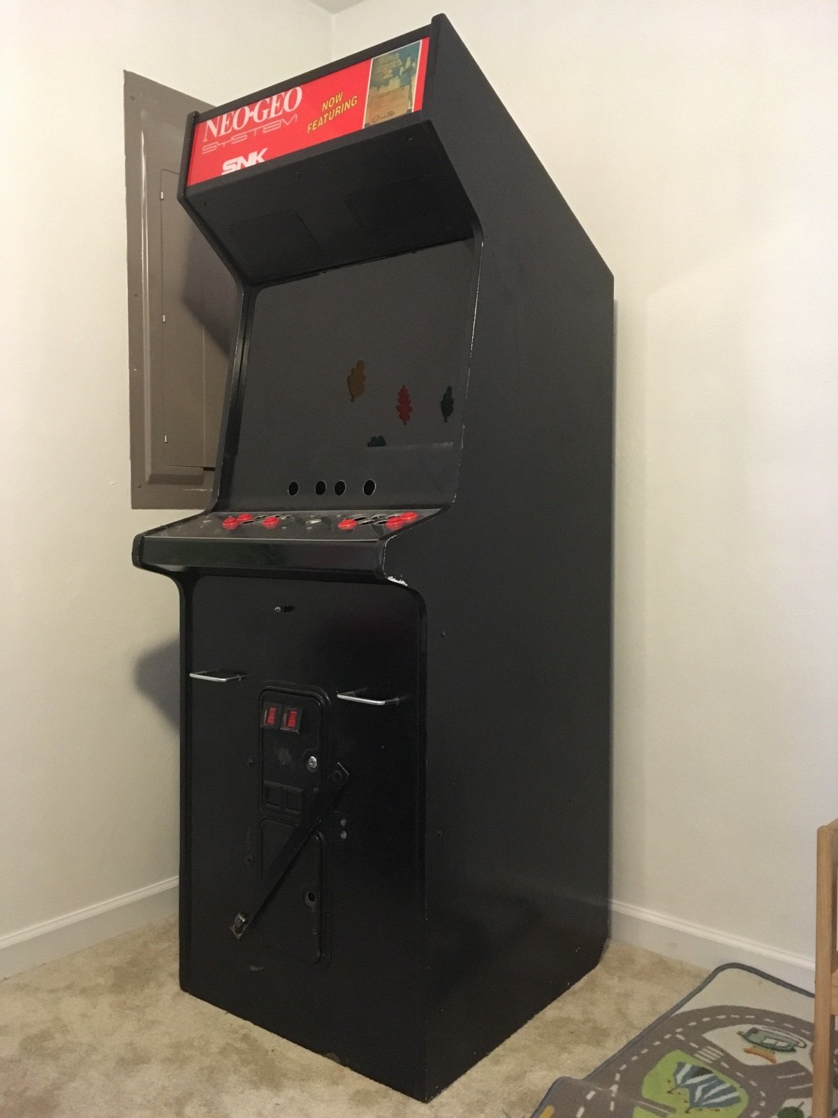

cowbells Posted February 22, 2015 Posted February 22, 2015 It's an Atari cabinet. Black Widow, Gravitar, Quantum, Space Duel and a few others use the same cab design. This is correct. It looks like you have a Space Duel based on the location of the holes under the CP. At some point is was crappily converted to a Neo. Could have been any number of JAMMA games before that too. Edit: Actually, this is partially correct. Those four games all use that cab, but they are the only four. No other games originally came in one of those Atari vector cabs, but you will see Major Havoks and Tempests in them occasionally. Not original though, those are conversions. Normally I'd plead with you to restore this back to original, but your vector monitor is probably gone and it's the cheapest of the 4 games that came in that cab. If you had a Quantum, I'd be screaming bloody murder about your project. ($4K game) But it's just a Space Duel and it's pretty far gone. By the time you restored it, you'd have spent enough money to just buy a complete one. This is actually a great candidate for a multi vector cab, but looks like you're going the MAME route. Good luck with the build! I also agree about welding the CP instead of bondo. Bondo is great for rebuilding parts of the cabinet, but not for fixing control panels. One drunk friend is all it will take to undo your hard work. Virtually any machine shop could help you spot weld a new piece of metal in there or just completely rebuild the whole panel and drill new holes. The cheap way out would be to just reinforce with plexiglass on both sides and use the Control Panel Overlay to hide the existing holes. I see this kind of thing all the time. But if you're going for quality, then you gonna need to rebuild dat!

shaybe Posted February 20, 2016 Author Posted February 20, 2016 It has been a long time since I updated this! Life has been real busy between the Navy, having another baby, and serving in the High school youth group at my Church with my wife. I decided to buy a $2 fence post from Home Depot and cut it down to mount the monitor I had a real hard time trying to figure out power. I ended up wiring a regular power strip to the original power switch on the cabinet. I just popped out the switch on the power strip, and had a friend solder some wires to the cabinets power switch. My PC is mounted in the cabinet, and I have a push button wired to the pins that start the computer, However the settings for the PC power make it so that once I apply power via the power strip it automatically starts! So as long as that keeps working I will not need a second button to start up the machine! I got curious one day when I saw white peaking out behind the black paint on the side. I took a little nail polish remover to it and discovered this was a Space Duel! It makes me sad to see that someone painted right over the beautiful side art. I had played with the idea of recovering the art and going with a theme to match it, but I think I have decided against that now. I am in the process of designing some artwork for the cabinet.
shaybe Posted February 20, 2016 Author Posted February 20, 2016 I had some fun Arcade times with friends, and game nights with the High School youth group, but I have decided that the four buttons is not going to cut it anymore. I decided to get back to work on the cabinet. First step was to get that control panel overlay off! Crappy Neo Geo conversion overlay Turns out this was at one time a Vendetta, which explains the even more holes under there! Pretty cool artwork This was a very tough task to get this off of here. But this method worked really well! (Would not recommend on a wooden control panel! haha) I am still in the process of scraping off the goo left behind from this! I bought some bondo and am going to try and fill in some holes, and then drill some new ones. I hope it all works out! I also had some new plexi cut at Home Depot, so that should also help strengthen things a little bit!

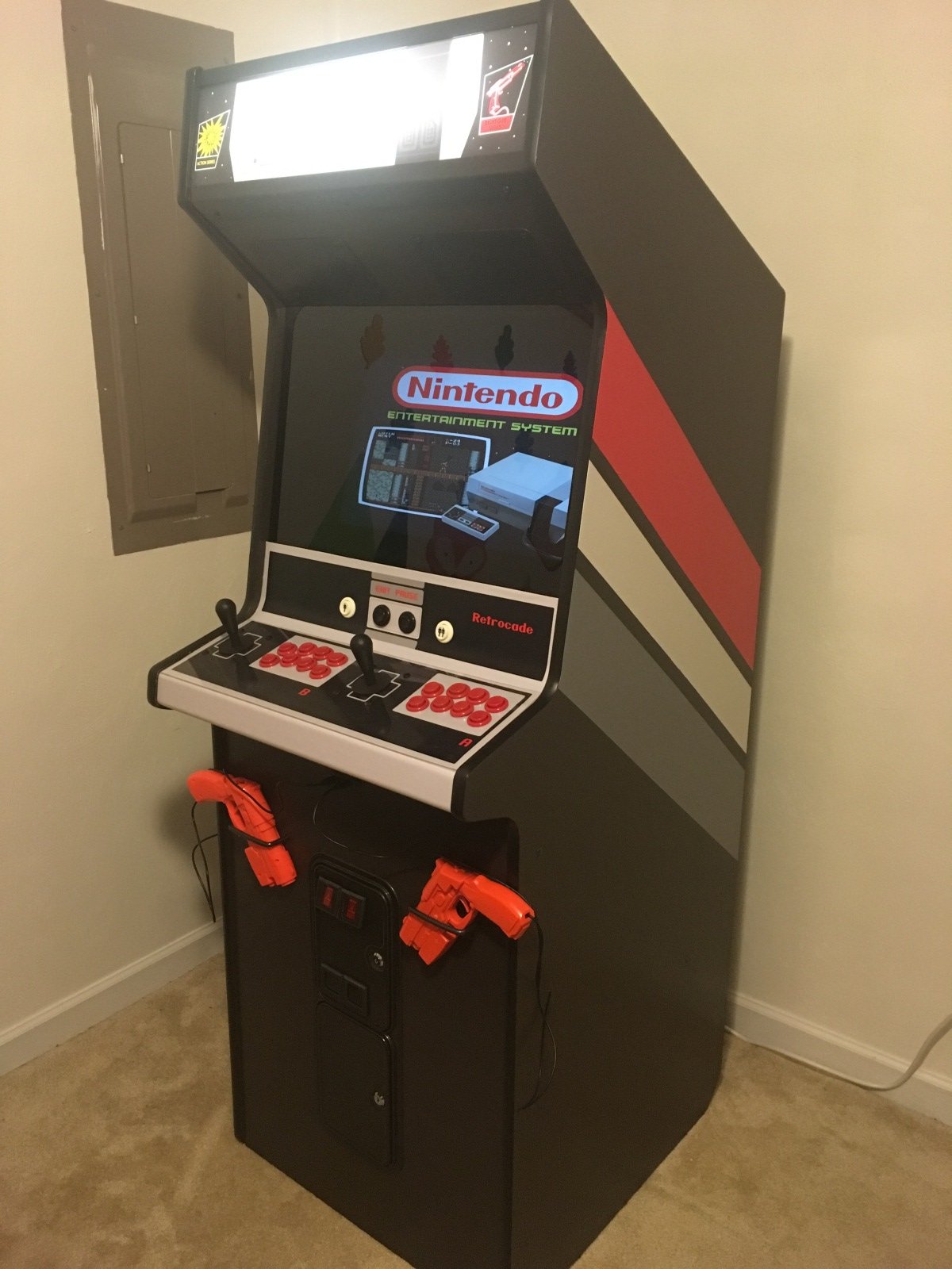

shaybe Posted February 20, 2016 Author Posted February 20, 2016 Made some rough mock ups for some artwork ideas. I have not fully decided on a name yet, but I do like retrocade. The dark gray in the design will probably be black, but for contrast reasons I left it dark gray. #1 - The bezel is a sort of mimic of the original NES game boxes #2 - Very rough bezel design. Thought it might be cool to have "cords" running from the CP up to the NES marquee #3 -Combo of #1 and #2 I am playing with the idea of throwing some character on the front edge of the control panel, but I may like the solid light gray better And a coin reject insert I made up. Maybe this or a coin from Super Mario? Let me know which # you think looks the best! I may not even do a bezel since I have tinted glass and don't really need one, not sure it's worth the $41 gameongrafix charges.

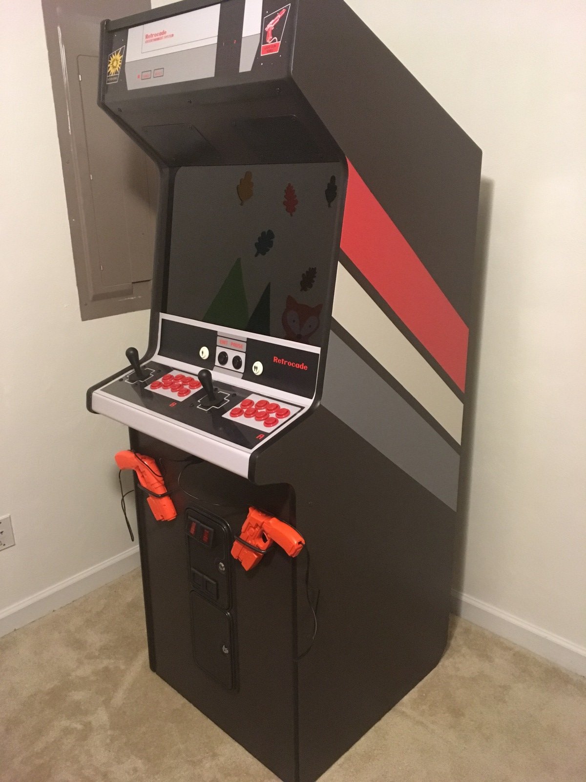

shaybe Posted June 18, 2017 Author Posted June 18, 2017 Finally got around to finishing everything up (Minus some programming still to be done)
