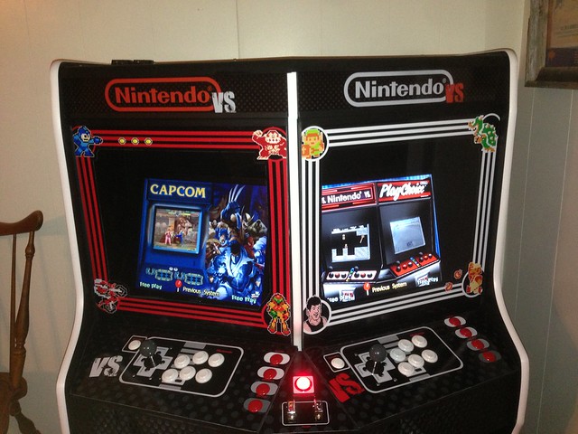

SORHP Posted April 29, 2012 Posted April 29, 2012 EDIT: Go here to see progress of the build... http://www.flickr.com/photos/sorhp/sets/72157629793066224/ I have to give a shout out to Koolbrez! and RidicRick! dude your'e nintendo vs theme was the inspiration behind this build, it took over a year, and I almost didn't finish it, I put the cab in storage for 6 months, and then one day I was back in HS and played some Rush-n-Attack in your Nintendo theme, and it brought me back to wanting to finish this cab, even though there are several mis-cuts on the wood and the design I had in mind never seemed quite right when I started to get things put together, I actually went back to the drawing board several times during the building phase, because I was so pissed at how the progress was going. The angle of the lower coindoor panels was off, the glass was not lining up with the lines of the cab, which caused me to have to make a major cut on the top that killed the chance of adding t-moulding to to top and embedding marquee's into the wood, but it all worked out in the end, a little wood glue, some expensive hardware from mikesarcade.com and great graphics from ridic rick made this pop like corn on christmas! what the hell am I saying?!? It's late, thanks again RidicRick, Koolbrez67, jeepguy81, donnei1979, cmoses, chillinwater, BBB, nitussi, THK, boohiss, s1nharvest, and others that I will have to edit this post for once I can wake back up... and countless others I will add to this list in the years to come for yalls help along the way! stop reading this crap and go play some video games!!! arcadeskin.com go get you some graphics for your rad arcade! Its so bad! :End EDIT alrighty, I'm about to start a new arcade build that will be a smaller version of the Nintendo versus machine *using MAME only: I intend to have player one be able to "turn the monitor" vertical or horizontal. It will need a switch (ahk maybe) to activate the cocktail mode, but I need some help wrapping my mind around what I should implement to make this happen (to be able to go from vertical (cocktail mode) to horizontal mode (and back))... sets of games, cocktail themes and controls all need to change, or am I goofy, and should not try to implement this into the new build? here's the ultimate idea: have a set of light up "mode of play" buttons, when activated that mode is switched to... mode 1: (player 1 only) vertical mode... only player 1 is activated and the screen is in vertical orientation, (jeepguys themes) controls are in vert mode also mode 2: (player 1 only ) Horizontal mode... only player 1 is activated and the screen is in horizontal orientation (normal themes) normal controls mode 3: (player 1 vs player 2) two monitors, same image (both players enjoy their own screen but play only horizontal versus games (fighting, windjammers, etc) only player 1 can choose the game (one computer handles all of the controls, processing and the monitors) mode 4: (player 1 and player 2) two complete separate systems each with their own computers, sound, screen, everything possible scenarios: make player 2 be able to go vertical also and have the ability for player 1 and player 2 to play vertical games vs, or together (more difficult to implement) or... take away the ability for player 1 to be able to turn monitor vertical and play vertical games on a horizontal screen (easier implementation, but not as cool) My Arcade Machines...

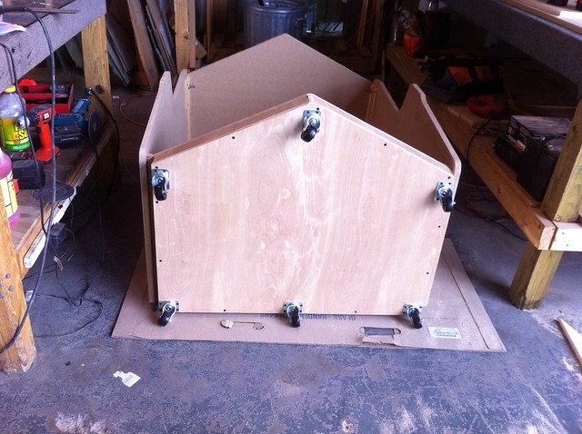

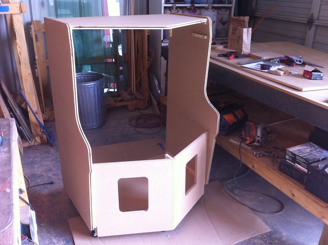

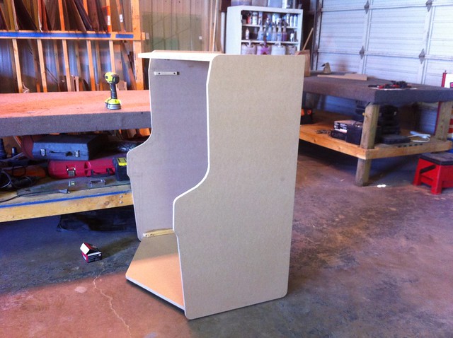

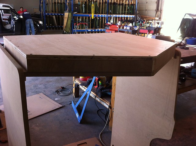

SORHP Posted May 23, 2012 Author Posted May 23, 2012 A little more progress... the base... ... I added the big casters because I have learned from experience that it is a biatch to roll heavy cabs that need to be moved (even if just a little) to be updated... My Arcade Machines...

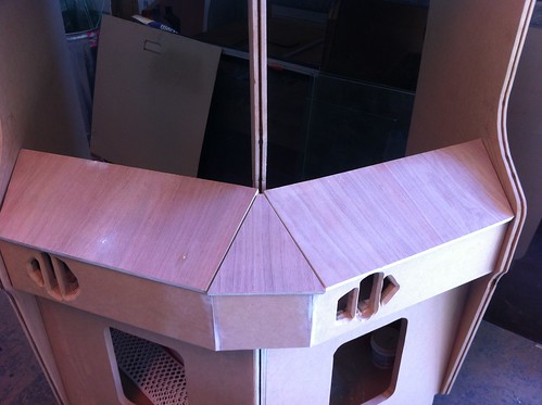

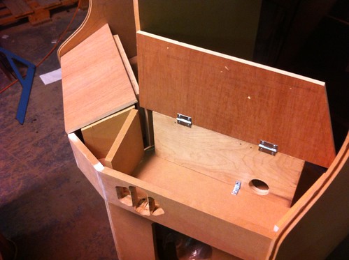

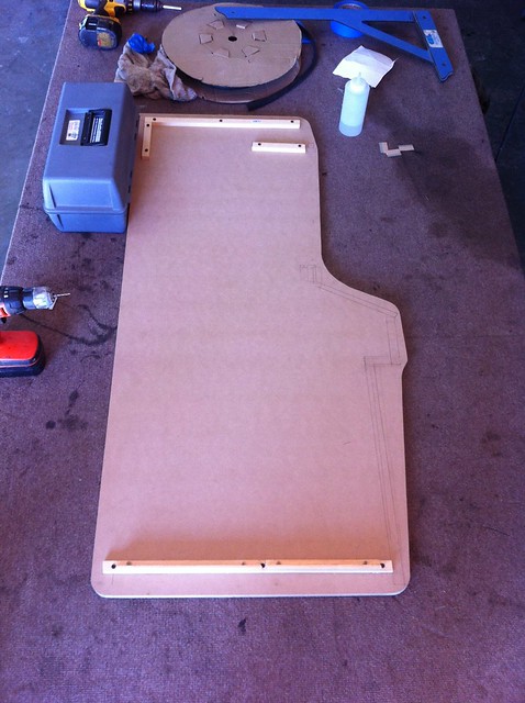

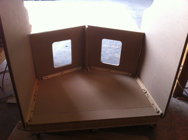

SORHP Posted May 24, 2012 Author Posted May 24, 2012 A little more progress... bottom coin door panels, and got the t molding inserts routed, ( I hate routing those, they imo, are the worst thing to route, pretty difficult to get it going good without screwing something up Edit: Remember to turn the router off while still on the wood, when you remove the router when on cutting T slots, you risk bumping the wood and gouging the interior of the wood panel, check the top left corner of this first pic... My Arcade Machines...

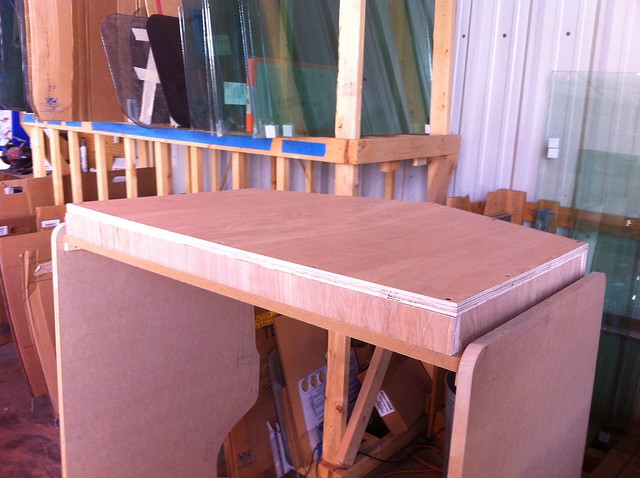

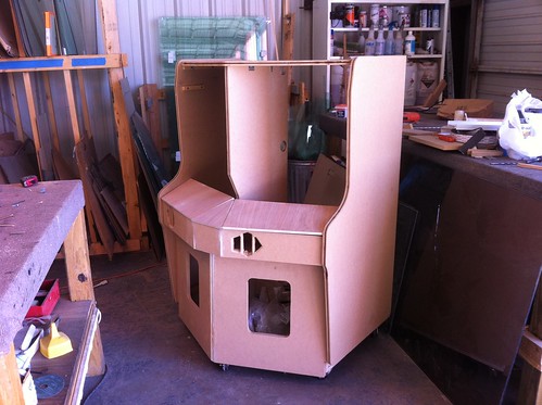

SORHP Posted October 2, 2012 Author Posted October 2, 2012 some more progress after a long bout of not wanting to work in the blazing west texas heat My Arcade Machines...

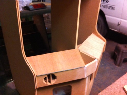

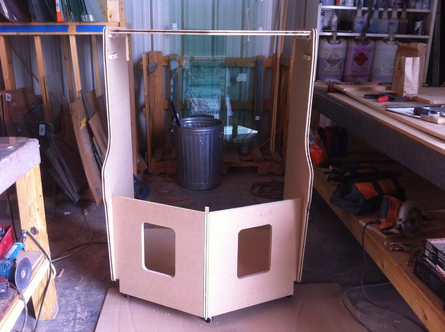

SORHP Posted October 4, 2012 Author Posted October 4, 2012 more progress... more to come These angles are crazy difficult, I am not a cabinet maker, but if I was, Im sure it would look a little better, but Im doin the best I can... hope yall enjoy My Arcade Machines...

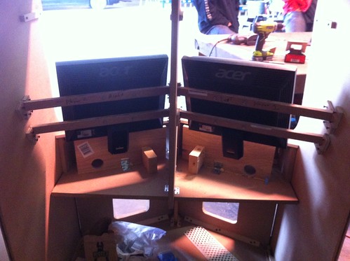

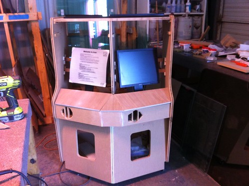

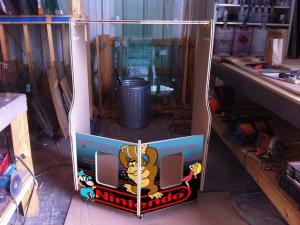

SORHP Posted October 10, 2012 Author Posted October 10, 2012 Got the monitors mounted, next is bezels, then glass, then marquee glass, then paint! My Arcade Machines...
cmoses Posted October 10, 2012 Posted October 10, 2012 Great looking project. Are those 20" 4:3 monitors?
SORHP Posted October 10, 2012 Author Posted October 10, 2012 almost!, 17" 4:3... this is a pretty small machine, its hard to tell by the pictures, the whole unit is about 4.5 feet tall, casters and all My Arcade Machines...
