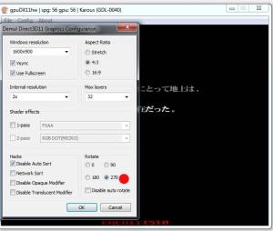

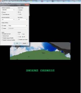

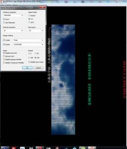

gigapig Posted January 21, 2015 Posted January 21, 2015 If I load that game then the setting is automatically set to 270 degrees. If I then add 1 shaders pass all is fine, but adding a second pass rotates the screen I tried the shader pass options in HLHQ but at the moment nothing is working, if I add shader passes the game is normal, no scanlines are added. Normal. 1 shader pass 2 shader passes

Yardley Posted January 22, 2015 Author Posted January 22, 2015 If I load that game then the setting is automatically set to 270 degrees. If I then add 1 shaders pass all is fine, but adding a second pass rotates the screen I tried the shader pass options in HLHQ but at the moment nothing is working, if I add shader passes the game is normal, no scanlines are added. Thanks so much! That is so odd and I would have probably never figured it out. I set ShaderUsePass2 to false in HLHQ for all my vertical games and they all launch properly now.
