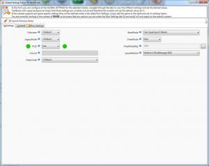

SIMPLYAUSTIN Posted February 13, 2015 Author Posted February 13, 2015 Still no joy, Im bewildered As I have full games for xml I did not fill in the extensions etc in HyperHQ. Was just going to leave it to HLHQ. So I have gone in and set the details... lets say for example MAME.... Heres my Emulator settings.... Filters.... And the only other thing that I changed which may have done something.... I just cant see whats out of the ordinary?? All my systems work fine and they were doing well until today Simply Austin's YouTube

SIMPLYAUSTIN Posted February 13, 2015 Author Posted February 13, 2015 Ok figured one silly mistake. I moved the location of HLHQ folder which made the relative paths different. Prob could not make the link between HyperHQ and HLHQ. Now I get to the fade and for MAME it just ahk errors out... Aaaaaaargh, Im sure it wasnt this hard the past 3 times of doig this Simply Austin's YouTube
SIMPLYAUSTIN Posted February 13, 2015 Author Posted February 13, 2015 Jeeeeeeeeeeeez!!!! When I moved HLHQ it reset all of my working dirs out of whack.... should have know but its wierd at there was no lil red ! mark like you get when links no longer work... strange... but oh well. ITS WORKING NOW!!! Not to try and get the bezels sorted before the missus comes back from work Simply Austin's YouTube
