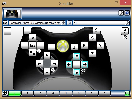

Yardley Posted March 11, 2015 Posted March 11, 2015 Is that possible? I thought MAME only recognizes joystick inputs, even if you have an xpadder profile running? I've never been able to get it to recognize xpadder keyboard inputs. Do you know a way to do that? A google search didn't turn up a viable solution for me. Thanks Yardley! Of course it's possible. Open MAME and map all of the inputs with your keyboard only, then create an Xpadder profile to match that mapping.

maks Posted May 3, 2015 Posted May 3, 2015 Of course it's possible. Open MAME and map all of the inputs with your keyboard only, then create an Xpadder profile to match that mapping. What else have you done on your setup to get it working like this? The strange thing is that I do have one command working while im in game, the ESC key which exits the emulator. Nothing else works. I even went through every setting in mame and unbinded everything that referred to the xbox controller. I replaced it with keyboard keys. Setup xpadder 2013.7.18 xbox 360 wireless controller mame .149 EDIT: Got it working. I downloaded Mame Plus with DirectInput already compiled. Thanks guys.
