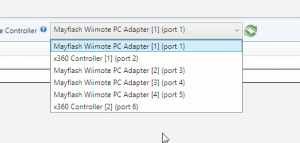

ChrisKant Posted February 21, 2015 Posted February 21, 2015 Hi everyone, my Hyperspin Setup works great with one xbox 360 Controller - thanks for so many advice from the hyperspin and hyperlaunch community. After a few months I start thinking of making my HTPC ready for 2-Player Games just because the good old Beat'em Ups needs player vs player sessions. First of all - it should not be as easy as it may read like with buying a seconds xbox360 wireless controller and setting it up in hyperlaunch via xpadder. there are many problems I couldn't solve yet. Hopefully the community has some more advice for me. I did read https://sites.google.com/site/hyperlaunch2/home/features/keymapper but this didn't helped me. Problem No1: how can I set up the controller to assign that Controller 1 is always and the other would always be controller 2. the newer controller always get the First Controller Spot while I am booting up system - and I have no idea why or how to chance it No2: I understand that one controller spot is number 1, then there are 4 controller spots for the mayflash dolphin bar and then the Spot 6 is for the second controller. In those case I have to configure in xpadder a p1 (= controller 1) and a p6 (= controller 2) profile, haven't I? Hyperlaunch only load one profile in xpadder and leave the other one (controller 1) blank. I could not find any yt videos or other threads here... that helped in those case of problems. how did you guys set up two xbox 360 controllers on your hyperspins????

ChrisKant Posted February 22, 2015 Author Posted February 22, 2015 thanks for this tip, sadly this not solve my problems at all. I cannot assign the Xbox 360 Controllers to the right order - I guess it has to configure directly in windows, but where? and even with your tip there is still a straight order that will not chance the used Ports in Hyperlaunch I put a picture to this post, maybe this will help understand my problem. and I want to have the xbox 360 Controller as port 1 and port 2. update: also have problem that the profiles will not load as needed. start HS and nothin happened. and when I have luck with one profile than the profile for the seconds x360 controller is not loaded (as usual)... I will loose my mind before finishing one System Set (trying NES so far)
