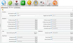

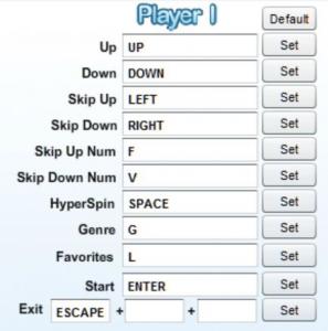

32assassin Posted February 22, 2015 Posted February 22, 2015 not sure what you mean by save but I can help you with the other two load (Game) --> done by Hyperspin the default is the Enter (P1)OR "E" (P2) key. you can change it if you like under HyperHQ -->Controls Tab --> Start line Exit (to exit out of a sub wheel or exit (close) Hyerspin --> default Esc (P1) OR Q (P2) you can change it under HyperHQ --> Controls Tab --> Exit. to Exit a game you need to change your controls in HyperlaunchHQ the default is Esc, if you like to use your own key combo HyperlaunchHQ --> Global --> General Settings TAB--> Controls sub-TAB under Emulators --> Exit Emulator key --> change the: ~Esc to whatever exit combo key you like to have. their is no need to remap or use any AHK key remapping to your ipac encoder. Unless you run any emulators that don't like the service keys (alt,shift,control or space)

vampirolatino2 Posted February 27, 2015 Posted February 27, 2015 If is working fine in HLHQ and not when HyperSpin is on, then HS is using/interfering with the keys. Go look at HHQ the controls section and make sure C or V isn't repeating there.
djsim Posted February 27, 2015 Author Posted February 27, 2015 Hi Vampirolatino2, I thought you had it there as V was mapped as something else I changed it to something else but no joy, I would have thought there would have to be a few xtra steps to get it working within HS?
djsim Posted March 2, 2015 Author Posted March 2, 2015 Hi Lads, I was playing around with this nearly all weekend, and I made a slight step forward. What I did was change the exit key in the global settings in HQ to V, so now I can at least exit the emulator with a different key. However, I am not having much luck the save \ load buttons. Can I ask, do you configure these at the emulator system level within HQ or in the global settings? What I tried was enabling keymapping in the global settings to true and then tried to create a custom AHK (system profile) and set it locally (set AHK to external) and now I am getting a conflict when I launch the emulator in Hypespin? Can I ask what are the steps involved in this?
