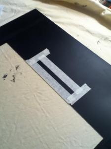

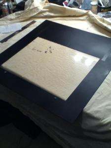

Yes, Top Center. Only one sensor bar even if you have multiple guns. I have a homemade cabinet and it is installed right over the screen. I have a bezel plexiglass painted black on one side and I had to scratch off the paint to make a rectangular window to let Infra-Red pass.
