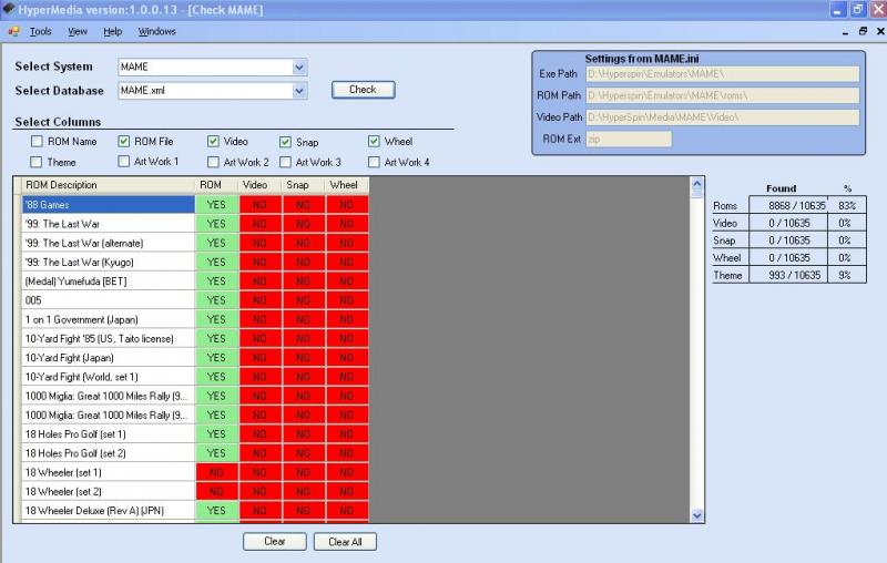

gixxerrider73 Posted November 11, 2012 Posted November 11, 2012 Hi All! I had created an MS Excel to to check the existance of files against the HyperSpin databases. I received some really good feedback on the tool. One popular request was to build a stand alone tool. I've published a stand alone version. Benefits of this tool. -see what files you're missing. -match media files to menu items -Edit your menu items disable games that don't work -preview media items as you select menu items -Easy to install and update -update to the latest version of the tool automatically, no more downloading re-dowloading. The tool installs as any other Windows program and can be removed via the control panel. -I'm working on a feature to rename files in a directory and it will be posted soon. You can view a the instruction manual by downloading it from here before installing the software http://www.hyperspintools.us/HyperMediaManual 1.0.pdf If you want to try out the program you can download it here. HyperMedia Install If you need help or run into an issues, please post them in this thread. If you have ideas for a new feature, please post it here or semd me a PM. I want this to be an all in one tool for all of us. Thanks for your time, GixxerRider73

gixxerrider73 Posted November 20, 2012 Author Posted November 20, 2012 Drkdweller, I fixed the issue with the two file extensions I just ran this to check my MAME xml with 10635 games and it completed with no errors. Here is a screen shot. I added some code to handle exceptions, it should at least show a message box with the description of the error. Also, since I only have WinXp32 if anyone is running on Windows 7 etc, please let me know how it works. Just a couple of notes: This is not setup to search subfolders, I think I may need to add that function. would a feature to move "orphaned" roms to a special folder be helpful? how about a tool to search selected folder to find a matching rom, media file then copy to correct folder for selected system?

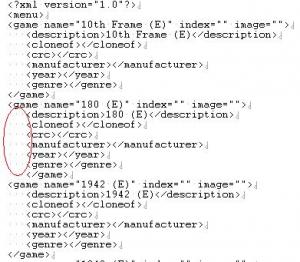

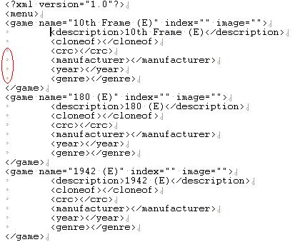

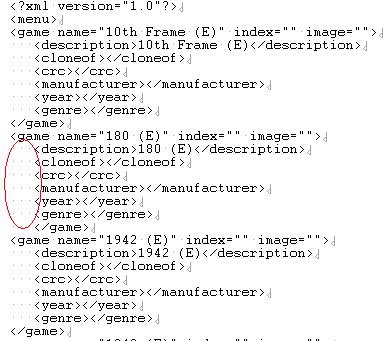

gixxerrider73 Posted November 21, 2012 Author Posted November 21, 2012 So tonight I did some testing with a user's file created in rom2xml. This file would not run in my program and here is why. I analyze the file using TextPad. you can see the image on the left from rom2xml uses "tab" to space over the lines. this formatting creates an issue in the xml file. xml files should not have any formatting and should be plain text. My program uses the built in module in vb.net for xml so the files have to be fully xml compliant. If i were to read the xml as a text file then this probably would not be an issue however the System.XML function is faster. the image on the right is the same file where i removed the "tabs" and replaced then with "spaces" via the space bar. This file works fine. If you open a xml in notepad the formatting should look organized, the rom2xml file shows the text in one large paragraph so to speak with small squares indicating the "tabs". This issue also drove the arithmetic error Piper got. with the System.xml function I get the count of the nodes without looping through them, do to the formatting it could not get the count of the nodes so it was trying to divide by zero.
ghutch92 Posted November 21, 2012 Posted November 21, 2012 I don't know if this helps, but I fix the rom2xml formatting with notepad++ by replacing all \n\t with \r\n (in extended mode). How to Install HyperSpin and more RocketLauncher HyperSpin Startup Script
djvj Posted November 21, 2012 Posted November 21, 2012 Tabs are not compliant in xml files? I'm not so sure about that as just about every xml file I have uses tabs, even ones that are created/compliant from xmlspy. I actually prefer the look of tabs instead of spaces. "Computer games don't affect kids; I mean if Pac-Man affected us as kids, we'd all be running around in darkened rooms, munching magic pills and listening to repetitive electronic music."RocketLauncher's Official Home If you appreciate my work:My Apps:Window LoggerIdle Volume AdjusterExplorerRestorerRom Folder CleanerModule UpdaterMy Guides:How To Mod Guncons with Aimtrak
dustind900 Posted November 21, 2012 Posted November 21, 2012 Tabs are not compliant in xml files? I'm not so sure about that as just about every xml file I have uses tabs, even ones that are created/compliant from xmlspy. I actually prefer the look of tabs instead of spaces. You are correct, tabs are compliant with xml. I also use xmlspy. Just to be sure I downloaded a couple freeware xml editors and parsers to test and had no issues with tabbed xmls. Rom2xml double tabs some of the lines that's why it throws errors. In notepad++ -- Edit > Select All - then - Edit > Indent > Decrease Line Indent. Same thing as ghutch said just a different method.
Drkdweller Posted November 21, 2012 Posted November 21, 2012 Rom2xml double tabs some of the lines that's why it throws errors. In notepad++ -- Edit > Select All - then - Edit > Indent > Decrease Line Indent. Same thing as ghutch said just a different method. Tried method. did not resolve the problem
ghutch92 Posted November 21, 2012 Posted November 21, 2012 rom2xml doesn't do correct line carriages. A line carriage in notepad++ looks like \r\n. I only see \n when looking at a file from rom2xml. I think the problem is here and not the tabs. How to Install HyperSpin and more RocketLauncher HyperSpin Startup Script
