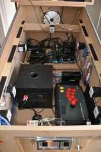

Pinball999 Posted February 24, 2013 Author Posted February 24, 2013 My Hori stick found its place in the cab. This will be great for the vertical shoots!
Pinball999 Posted March 2, 2013 Author Posted March 2, 2013 Still waiting for the DMD, but I'm finally getting there.

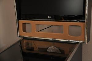

Pinball999 Posted April 17, 2013 Author Posted April 17, 2013 Breaking news, the Vishay arrived... or at least the customs dared to inform me yesterday. Almost one month after it was shipped! Now back to work.. it's time to cut the speaker panel!

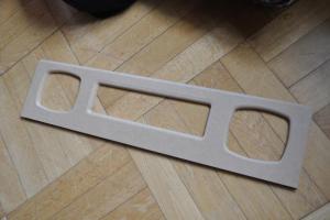

Pinball999 Posted April 21, 2013 Author Posted April 21, 2013 Did some work on the Speaker panel, and managed to test the DMD in place. This is like day and night!
scottpe Posted April 22, 2013 Posted April 22, 2013 Speaker panel looks great! What did you use as a template for the speaker holes?
Pinball999 Posted April 22, 2013 Author Posted April 22, 2013 Thanks Scottpe. I'm quite pleased with the result so far. Looking forward to putting the speaker cover and painting it. For the template, I've used a classic Williams template and enlarged it a bit to better fit the bigger panel. A jig was then created with my router after finding the radius to match the size I had in mind.

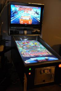

Pinball999 Posted April 27, 2013 Author Posted April 27, 2013 Glad you like it Russ, it's thanks to youthat this is possible Installing the PinDMD2 and the drivers was a piece of cake. And the results are beyond my first expectations! I have just uploaded another video showing the DMD on Big Bang Bar, with the BAM static view. Please forgive the poor video quality... in real conditions, the DMD looks much darker. BTW. I have never explained why there is no glass in front of the backglass... The reason is quite simple.. Since the Pincab is in my living room, I did not want to have 3 TVs in the same area and decided to use the 32" to watch TV programs. As a consequence, the TV front button had to be accessible, and no glass had to be used to avoid reverberations. This allows to save some money on the HW side, and ALSO some place in your living room. So in a way, the cab is now a big TV furniture that can be switched between TV and gaming modes
Pinball999 Posted May 12, 2013 Author Posted May 12, 2013 A short vid of the cab in action https://www.youtube.com/watch?feature=player_embedded&v=B-ZAiOjRJds
