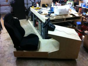

Fursphere Posted February 2, 2013 Author Posted February 2, 2013 Got the seat today. Very nice quality - now I just need to come up with a paint scheme to match. It'll need to be raised up probably two to four inches. Came with sliding rails too. The box it came in is huge, so I'll be able to use that to mock up one of the sides for the top section.

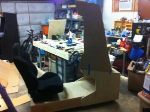

Fursphere Posted February 2, 2013 Author Posted February 2, 2013 Mocked up one of the sides. I put one of my tool boxes under the set that added 4", that "loose" plans I have called for 5.5". The steering wheel needs to be moved up about 1" - 2" from where it sits right now - which is going to have automatically when I frame in the top. The overall height of the cabinet is about 68" - Feels tall, but its probably ok. The screen is about 22" tall, and the "screen" area in the cardboard cutout is about the same, with my eye level being really close to the center of that. So I think it'll work out nicely. It needs to be tweaked a little, and I can't cut out the wood panels under I get the Daytona dash here to make sure the height it correct on the lower edges - I guessed at 10" for the cardboard. Feels right, but I want to be sure. The dash should be here around Wednesday next week. Overall it feels like its really coming together.

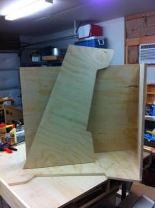

Fursphere Posted February 4, 2013 Author Posted February 4, 2013 I was able to get a little time this weekend to cut the sides out. I just started truing them out with the belt sander when I realized I desperatly need a new belt for the thing. So I'll pick up a couple tomorrow and finish it up.

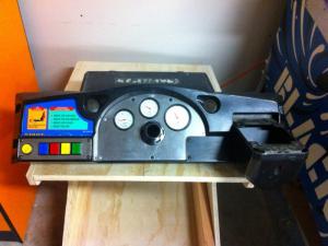

Fursphere Posted February 9, 2013 Author Posted February 9, 2013 Picked up the dashboard this morning from the post office. I didn't realize from the auction (it was vague at best) that it still has the metal bracket attached to it - so its pretty heavy for what it is. The harness for the buttons and speakers is in tact as well, so I might actually be able to use those. The "start" button's bezel is broken - but that's easy to replace. I really like the way it looks right now - so I'm really doing to have to think about how I want to incorporate the Logitech G27 into it before I go hacking. Here's a quick pic of it sitting on the lower cabinet.

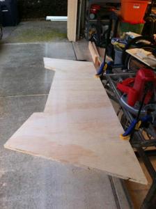

Fursphere Posted February 10, 2013 Author Posted February 10, 2013 Had to buy another 4x8 sheet of plywood. I was able to have Home Depot rip this one in half though - so my back was saved. Getting ready to put the upper cabinet together.

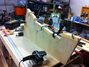

Fursphere Posted February 10, 2013 Author Posted February 10, 2013 Progress! Finished sanding out the sides, then glued, screwed, and biscuit'd three sides together. I didn't want to use screws, but I only have two four-foot clamps, so using screws was cheaper / faster than buying more clamps that I really don't need. After everything dries, I might actually pull out the screws, drill out the holes a little larger and glue / hammer in dowels - they'll finish better in the end.
