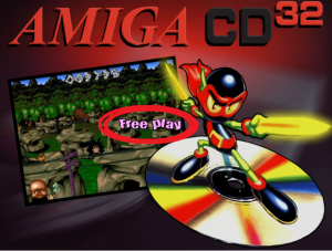

CroCop Posted May 12, 2015 Posted May 12, 2015 How can i remove that "Free play" from Hyperspin? Its really annoying in the middle of my screen and i want to remove it, but how?
32assassin Posted May 12, 2015 Posted May 12, 2015 HyperHQ --> Wheel settings tab --> select Main Menu Wheel --> special art sub tab remove Enable check Special Artwork A --> joystick Special Arwork B --> Free play if you like to change them to another image (swf or png format) you can also permanently delete them C:\HyperSpin\Media\Main Menu\Images\Special

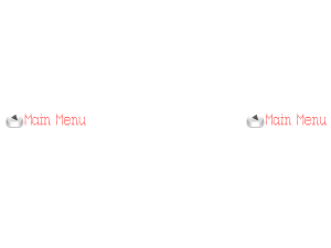

32assassin Posted May 12, 2015 Posted May 12, 2015 by other images I mean to make one that fits your needs. this are zerojays (I think) if you are using other type of joysticks; or your keys are mapped differently. this images will not look good on your system. I use this

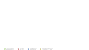

ChrisKant Posted May 14, 2015 Posted May 14, 2015 this are some great buttons. but how can I configure them to be on the right place. I tried it in the Hyper HQ but all I get is some jumping pictures that are just seen for milliseconds :-(
ninja2bceen Posted May 14, 2015 Posted May 14, 2015 Each ini in the settings folder in hyperspin. Each system needs adjusted at the bottom Man that's sick! I love what you made here and would love to add it to my set up! Don't forget to upload it to the download page! (Tapatalk signature) Advance the cause to 100%. http://hyperbase.hyperspin-fe.com/ Planet Geekdom, Subscribe for Tutorials! https://www.youtube.com/channel/UCdcby-s2GwriaOHGmVC2vGA?sub_confirmation=1&app=desktop
ChrisKant Posted May 14, 2015 Posted May 14, 2015 Each ini in the settings folder in hyperspin. Each system needs adjusted at the bottom can you be a bit more specific, because I still don't know what to do :-(
scooter1974 Posted May 14, 2015 Posted May 14, 2015 can you be a bit more specific, because I still don't know what to do :-( In HyperHQ, go to Wheel Settings, then choose a wheel from the drop down list and make these settings to every system. These are the settings I have for the Xbox buttons, and fade in and out nicely. Check out my MAME Arcade classics themes!

ChrisKant Posted May 14, 2015 Posted May 14, 2015 Now I come closer to what I might want for my System, but Now I figure out, that the resolution of these XBOX Buttons are too low. Resizing makes the graphics look bad... I am using my HyperSpin with 1280x720... and with that it is a bit ugly... does anyone have some new buttons with a higher resolution? thanks to all for your help
ninja2bceen Posted May 14, 2015 Posted May 14, 2015 enjoy http://www.hyperspin-fe.com/files/file/8112-special-art-work/ Advance the cause to 100%. http://hyperbase.hyperspin-fe.com/ Planet Geekdom, Subscribe for Tutorials! https://www.youtube.com/channel/UCdcby-s2GwriaOHGmVC2vGA?sub_confirmation=1&app=desktop

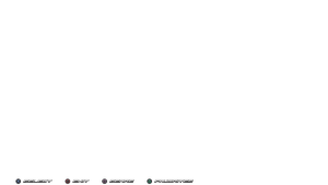

ninja2bceen Posted May 14, 2015 Posted May 14, 2015 enjoy http://www.hyperspin-fe.com/files/file/8112-special-art-work/ Just download this folder and drop it in a system folder to replace you special folder to watch the magic happen. Don't forget to change ur system ini. In my download a art is at the top, b art is at the bottom and c art is in the top rightArt c is genre messages when you select a new genre. You'll find the art in the top right corner if you go to my download page Man that's sick! I love what you made here and would love to add it to my set up! Don't forget to upload it to the download page! (Tapatalk signature) Advance the cause to 100%. http://hyperbase.hyperspin-fe.com/ Planet Geekdom, Subscribe for Tutorials! https://www.youtube.com/channel/UCdcby-s2GwriaOHGmVC2vGA?sub_confirmation=1&app=desktop
