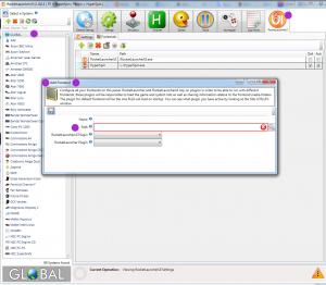

The only way I was able to get past this issue on my system was by following the instructions here. http://www.rlauncher.com/wiki/index.php?title=Transition_From_HyperLaunch3
If you scroll down until you see the picture they have for HyperHQ below the section titled "B: HyperSpin v 1.3 - Transitioning HyperSpin inis to work with RocketLauncher" and follow the directions listed below you should be good to go. Here is how each executable should look for each system your Enter key is not working on. Refer to the link above for more details.
656x519xHsrlsettingtihrompath.png.pagesp
