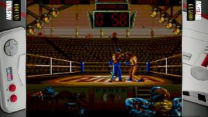

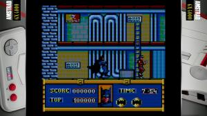

Styphelus Posted May 29, 2015 Author Posted May 29, 2015 I'm talking about this. Some games will fill up the whole screen, some have black borders all the way around. Still others like Dick Tracy will have a black bar on the left.
