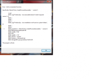

C_Wilson009 Posted May 31, 2015 Posted May 31, 2015 hey guys, does anyone know why im getting this error when I try to load mame in hyperspin? I attached a pic of it. Error: call to nonexistant function the emulator works fine in rocketlauncherUI.

mikty Posted June 1, 2015 Posted June 1, 2015 hi, any idea? is there a problem with java ?. it's needed? thank you for your answers bye edit: I have install java without sucess to launch mame through hyperspin
mikty Posted June 1, 2015 Posted June 1, 2015 to complete the previous tread, i use the last mameuifx 0.161. the mame.ahk module is still 0.160. i use rocketlauncher and hyperspin 1.3 is that the problem ? (launch game through rocketlauncher is ok)

nimpa Posted June 1, 2015 Posted June 1, 2015 What happen when u try a game in hyperspin? U get that error popup? Tried in hlhq?
mikty Posted June 1, 2015 Posted June 1, 2015 thanks for your help yes, i use the romset 0.161. and the databases 0.161 and error popup on hyperspin when I launch a game. it work fine launching games in rocketlauncher. I don't know what happen.

32assassin Posted June 10, 2015 Posted June 10, 2015 this is not a MAME or missing programs error, this is a user error, Your Hyperspin setup is trying to use Hyperlaunch 2 to load your MAME game if you are trying to use HL2; you do not have HL2 fully configured. if you want to use RL; you need to add the correct path to your Hyperspin Settings.INI Rocketlauncher folder for Hyperspin version 1.3 Rocketlauncher exe for Hyeprspin version 1.4
