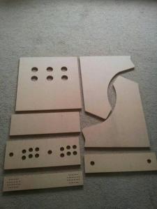

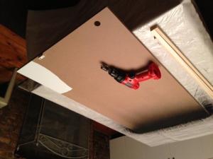

Yardley Posted March 6, 2013 Posted March 6, 2013 Hello! I want to start by thanking everyone for all of their help! The amount of knowledge and resources on this site is incredible. I've been on a mission to finish my bartop arcade cabinet ever since I found about Hyperspin hehe. I finally received my kit from Tippers27 this week and I'm eager to get started. I'm basically replicating mikekim's Retrocade, he was kind enough to supply the PSD files for his artwork and my goal is to make it look as close as possible to the original Tinyarcade kit and Mikes build! Below is Mikes build, its beauuuutiful! lol http://www.hyperspin-fe.com/forum/showthread.php?17297-Retrocade-bartop This is the kit I bought: I got a blank control panel so that I could drill the holes same as the Retrocade. Today I bought a scrap piece of MDF so that I could try out the half inch drill bit, fixing blocks I ordered separately, applying the vinyl and painting. Tried to spray paint it and it looked terrible, I did some research and priming with Kilz and applying latex paint with a smooth roller seemed to be the most recommended option so I think I'll go with that. Is the half inch hole right for happ competition and Sanwa JLW-UM-8? Here's the artwork printed on Vinyl. I fix Epson printers and a client was nice enough to print these out gratis after I fixed the machine Printed on an Epson SureColor SC30 solvent printer. Unlike the Tinyarcade, Tippers kit doesn't come with the plexiglass or brackets or marks on where to screw the fixing blocks so it will take some figuring out. Any advice from owners of this kit or the Tinyarcade on assembly would be great. (I believe the dimensions of both are about the same) I also ordered 1/2" Black T-Molding from Gremlin Solutions that I want to install, problem is I don't own a router... Was also looking for a plastic marquee lip similar to the one in the tiny arcade kit but the only thing I could find are ones that are wider and cover too much of the art. The one below seems close but the company is in the UK and they don't ship to the US. http://www.wickes.co.uk/white-pvc-edge-lip-5x25x2400mm/invt/162670/ Anyway, thanks again to everyone and I look forward to sharing my build!
mikekim Posted March 6, 2013 Posted March 6, 2013 nice start so far Yardley. The fixing blocks are quite easy to work out, just use two on each end of each piece of wood (the rear base panel ones are slightly in from the edge at the rear to accommodate the rear panel) section and join them to the sides of the cab. if you have a copy of my plans it shows on the drawing where the fixing blocks are positioned. I used the same size hole drill for the joysticks, as i did for the button holes - it will be covered by the plastic washer that comes with the joystick. i used a 28mm (1- 1/8 inch) cutter to drill the holes. i applied the t-molding using a dremel and cutting bit, as i only had to cut a 1mm slot into the sides for the t-mold to fit. as for the marquee edging try this site - they will ship worldwide you might want to ask them if they will spit the pack, as i'm not sure you want 12!!) http://www.stock-plastic-profiles.com/products/rigid-edgings.html. if you want to google search for it try "upvc hockey stick molding" or "upvc hockey stick moulding" hope this helps. Mike..

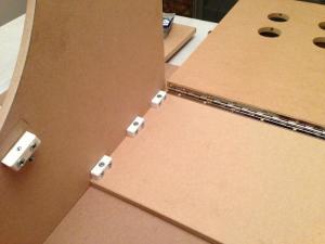

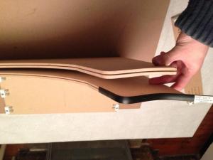

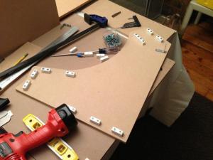

Yardley Posted March 7, 2013 Author Posted March 7, 2013 Got some things going today. Installed a piano hinge for the back panel, clamped everything down for positioning, made some marks, and started to installed the fixing blocks. Keeping my fingers crossed that everything will align ok. I think I'll do some painting tomorrow.
Frosty Posted March 7, 2013 Posted March 7, 2013 Looking good! Where did you find those fixing blocks? I couldn't ever find them in my area. Sent from my iPhone using Forum Runner
Yardley Posted March 7, 2013 Author Posted March 7, 2013 Thanks. Got them on ebay: http://www.ebay.com/itm/130813943545?ssPageName=STRK:MEWNX:IT&_trksid=p3984.m1439.l2649 Also available here: http://www.wickes.co.uk/fixit-blocks-white-pk24/invt/164410/

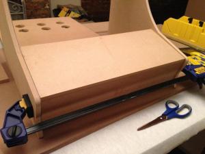

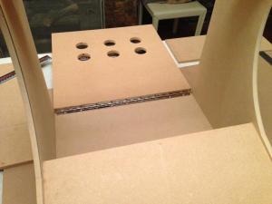

Yardley Posted March 8, 2013 Author Posted March 8, 2013 All pieced together without clamps, got everything lined up pretty good. Ordered the marquee art from Lucian, picking up some plexiglass tomorrow and hopefully getting the t-molding groove done at a local wood shop. Any recommendations on a light for the marquee? Was also wondering about how to wire the lighted power button to the motherboard.

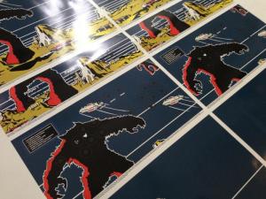

Yardley Posted March 10, 2013 Author Posted March 10, 2013 Put the art work on today! The control panel didn't align perfectly but I'll have to live with it.
mikekim Posted March 11, 2013 Posted March 11, 2013 Looking good. My bad, I should have mentioned that the artwork was designed for the tinyarcades kit, which has a lipped control panel, so the front art would be slightly off if there is just a standard join.
monkeychunkuk Posted March 12, 2013 Posted March 12, 2013 Looking great welcome to the Retrocade club nice paint job. I dont wanna put a spanner in the works but i noticed your cp art is lower down than mine its looks like your Joystick is going hit with the bottom have your tried lining it up?
mikekim Posted March 12, 2013 Posted March 12, 2013 Looking great welcome to the Retrocade club nice paint job.I dont wanna put a spanner in the works but i noticed your cp art is lower down than mine its looks like your Joystick is going hit with the bottom have your tried lining it up? It looks ok, might have to bend the microswitch contacts though. Sent from my Samsung Galaxy Note II.

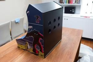

mikekim Posted March 12, 2013 Posted March 12, 2013 if you look at this reverse control panel shot you will see the joysticks fit with a couple of mm to spare (the footprint of the sanwas is a bout the same, if not smaller than the x-arcade sticks here) the board is the standard control panel dimensions and the holes where made with the .PSD template file. (the only difference on the file layout was an additional button on the top) you might have to bend the microswitch contacts to get it to fit but it should be ok.
