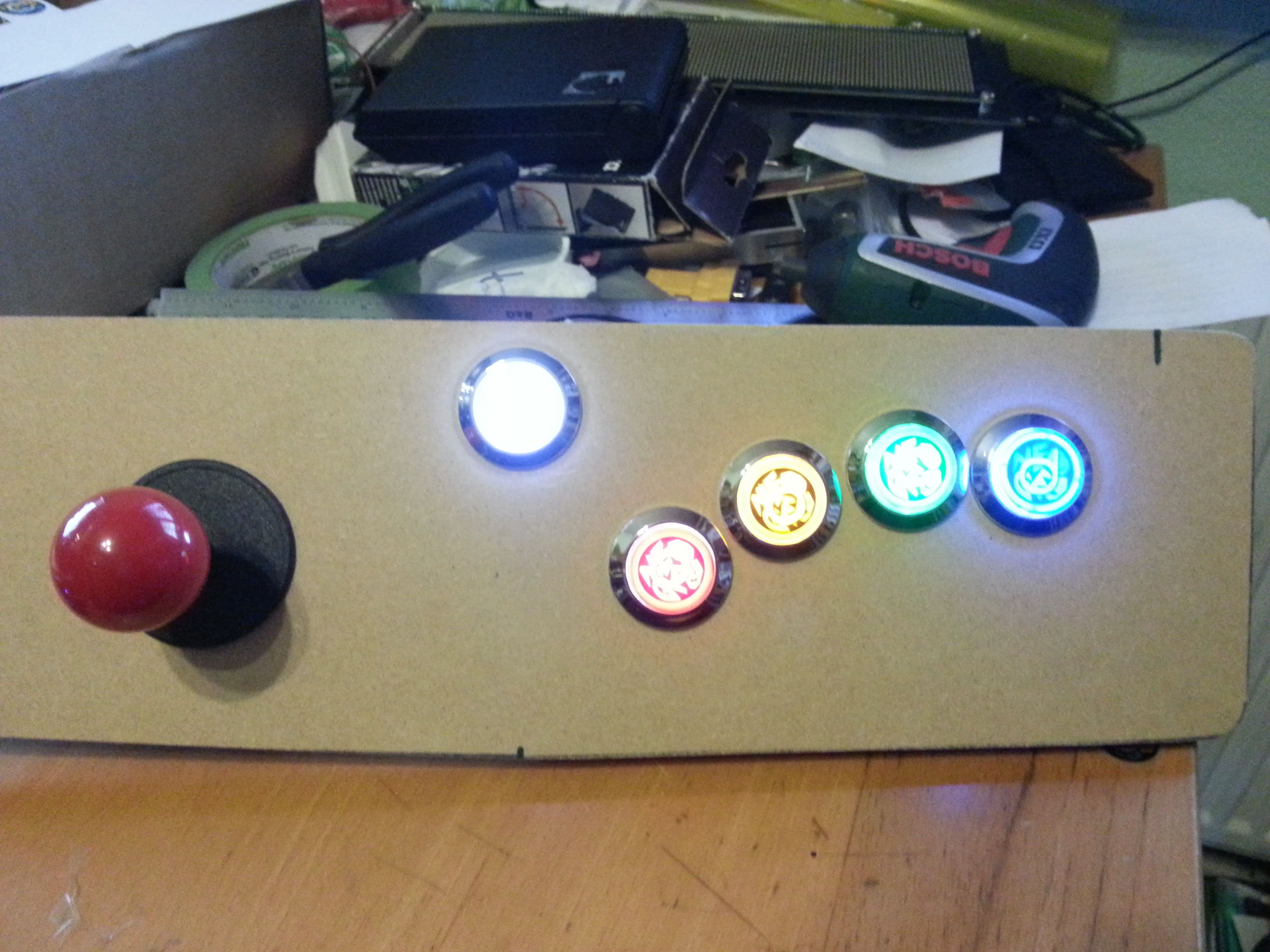

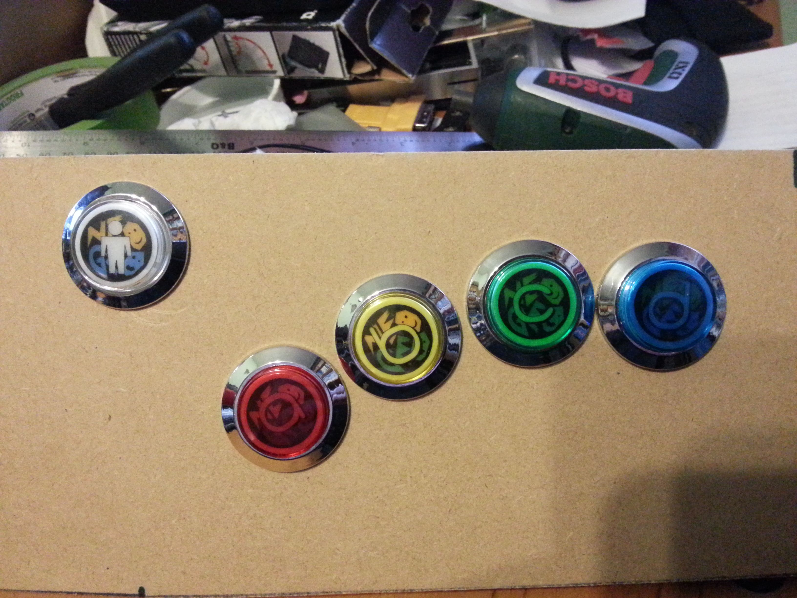

mikekim Posted March 30, 2013 Author Posted March 30, 2013 designed some button inserts today did a test fit of the control panel with one of the designs. buttons lit coin button for the front of the cab
markelhombre Posted March 31, 2013 Posted March 31, 2013 Wow, looks neat! Is that translucent glossy paper?

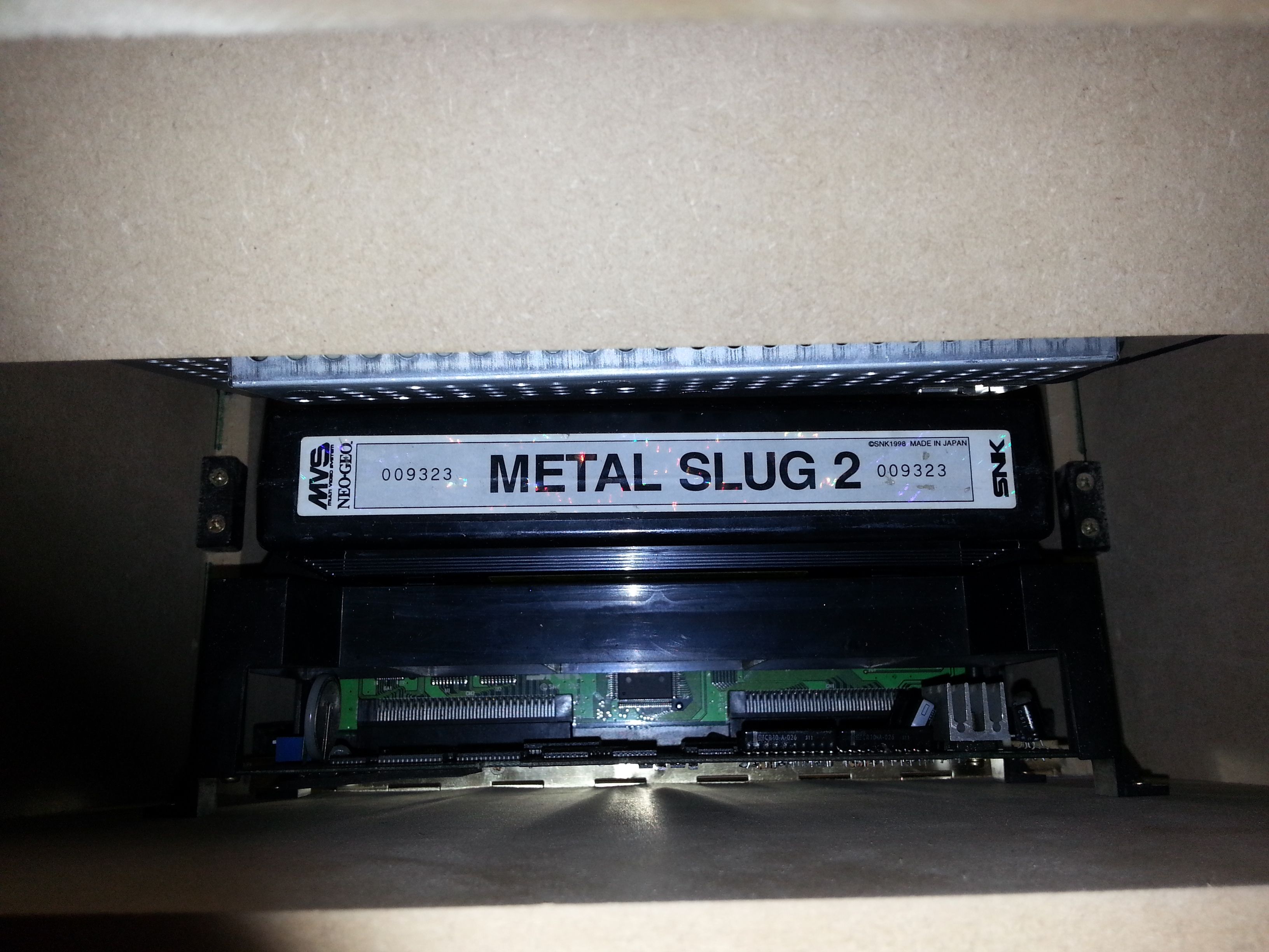

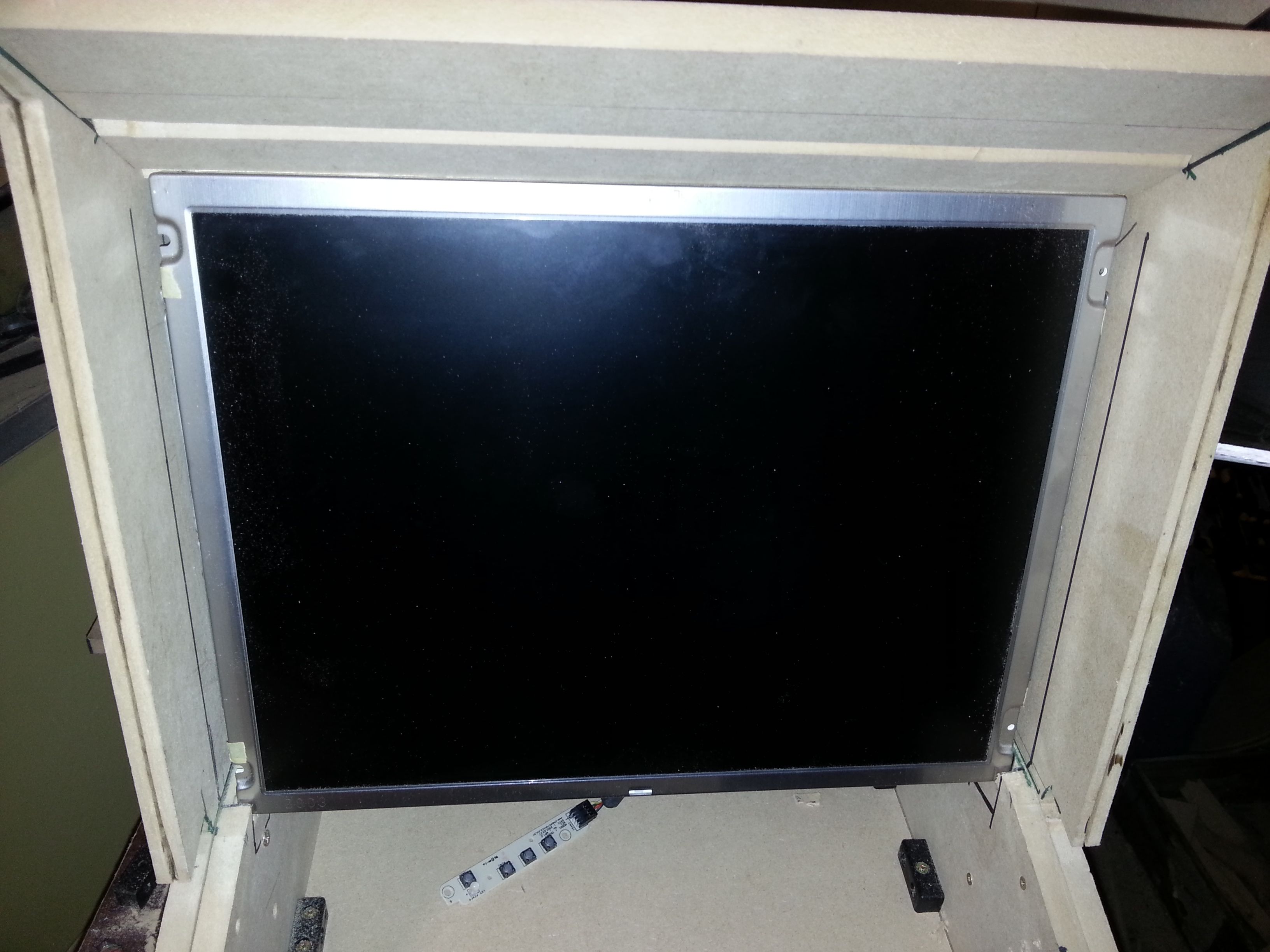

mikekim Posted March 31, 2013 Author Posted March 31, 2013 Update only got a couple of hours work done today.. Managed to fit the 15" screen though - had to de-case it, as their was no space for the MV-1B to fit other wise. didn't realize how little space there is inside this cab.. even after de-casing there is only a couple of mm gap between the cart and the back of the screen. one major tip measure twice and cut (or order in this case) once... The Bronze polycarbonate screen i ordered is 15mm too short.. oh well another £4.00 down the drain..
Unstupid Posted March 31, 2013 Posted March 31, 2013 Looks pretty tight back there.... where are you going to mount your power supply and the gonbes? Will you still be able to change carts with everything installed?
mikekim Posted April 1, 2013 Author Posted April 1, 2013 There is space in the bottom of the cab for the power supply, vga scaler and slg. The rear of the case is on a piano hinge, so it opens up to change the cart. I'll post pics later when it's all painted.

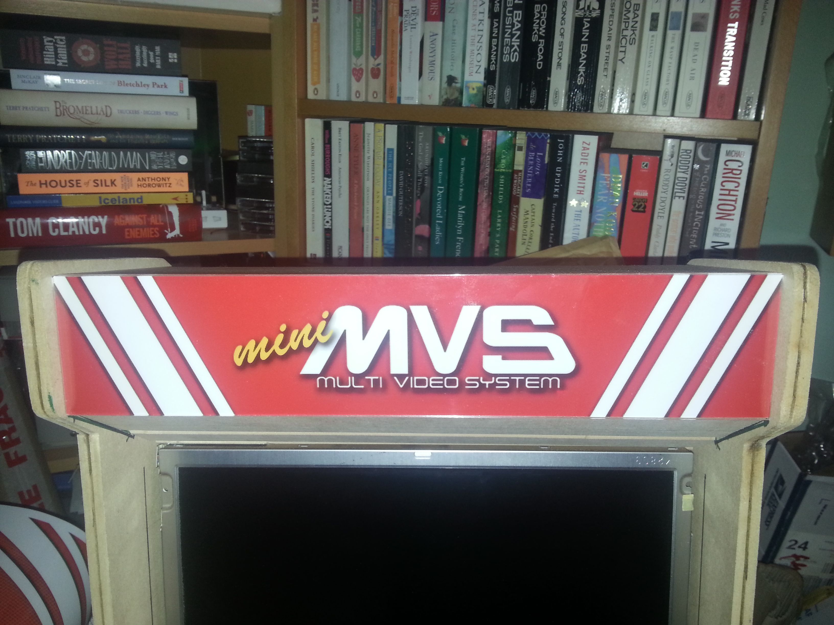

mikekim Posted April 6, 2013 Author Posted April 6, 2013 picked up the artwork this morning.. currently in the process of allowing it to uncurl - will post pics of the sides and cp artwork later on. applied the marquee to the lexan - quick test fit on the cab looking good so far!! also picked up the correct size polycarbonate yesterday, so will now be able to proceed with fitting the screen, and then painting, prior to artwork application edit: Polycarbonate screen fitted
monkeychunkuk Posted April 6, 2013 Posted April 6, 2013 Wow looks great! I feel like it gives a machine character when you fit the marquee Now teach me about polycarbonate oh wise one ; ) how much ETC ?
