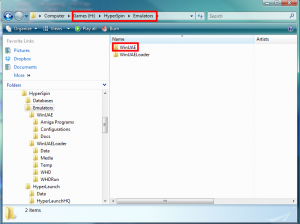

Extract WinUAE into your H:\HyperSpin\Emulators directory and rename it to WinUAE:

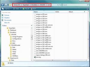

Next we need to install the Amiga boot and OS roms. Create a directory inside WinUAE called rom and place your files there:

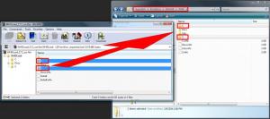

Next we will extract the required files from the WinUAELoader archive you downloaded into the WinUAE directory. Open up the WinUAELoader archive and extract the WHD directory and it's contents in the WinUAE directory:

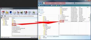

Next we will update WHDLoad to the most current version. Open the WHDLoad archive you downloaded and extract the S and C directory into your H:\HyperSpin\Emulators\WinUAE\WHD directory. When prompted, overwrite all the files:

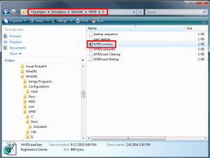

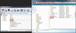

The next step is optional. If you have purchased WHDLoad, place your WHDLoad.key file in the H:\HyperSpin\Emulators\WinUAE\WHD\S directory:

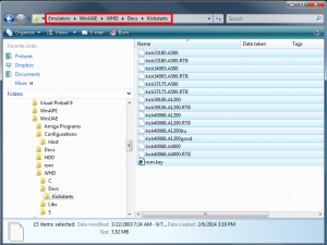

Ok, almost done with the initial setup. You will need to copy all of your kickstart roms into H:\HyperSpin\Emulators\WinUAE\WHD\Devs\Kickstarts:

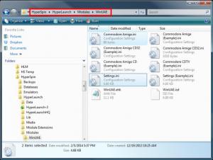

Navigate to H:\HyperSpin\HyperLaunch\Modules\WinUAE and there you should see a bunch of files:
If there is not a Commodore Amiga.ini or Settings.ini, copy the Commodore Amiga (Example).ini and rename it as Commodore Amiga.ini. Do the same for the Settings.ini file.

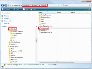

Navigate to H:\HyperSpin\Emulators\WinUAE and run the file winuae.exe

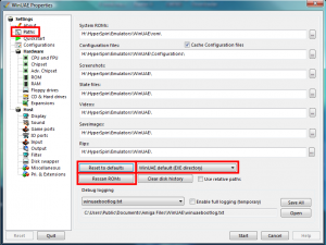

Select Paths on the top left. Below all the path settings is a drop down box, change it to WinUAE default (EXE directory) and hit the Reset to defaults button. That should set all the above paths to your WinUAE directory:

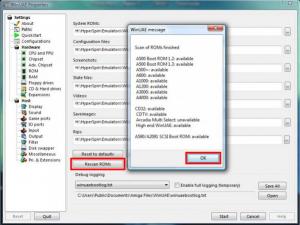

Click the Rescan ROMs button and it should find the boot and OS roms. Click the OK button:

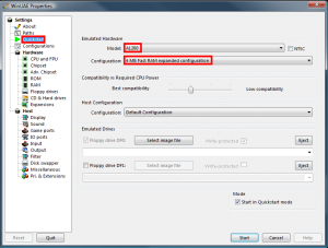

Some of the following steps are optional also, but you will see all the configuration options. Click on Quickstart on the top left. Set the Model: to A1200 and Configuration as seen below:

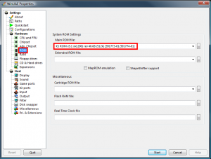

Next, click on ROM and choose KS ROM v3.1... as shown below:

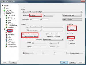

Now select Display on the left. Choose your options:
NOTE: As quoted by vindic8r here: http://www.hyperspin-fe.com/forum/showthread.php?31472-Complete-Guide-for-Commodore-Amiga-in-HS-and-RL-Using-WinUAE-Only&p=305000&viewfull=1#post305000
[sNIP]
3) This is probably only of interest to a handful of weirdos like me who are using standard resolution arcade monitors in their cabs w/ an ArcadeVGA, but I found I had to use very specific Display settings to get WinUAE to work properly. Fortunately, there was a thread over on BYOAC that had what I needed:

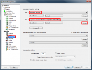

On to Game ports to configure your controller:
[sNIP]
1) Remapping controls in WinUAE isn't necessarily intuitive. It took me a while to realize that you need to double-click on the key assignment listed under the function, i.e. "Joy 1 Left", to start the remap process.
[/sNIP]

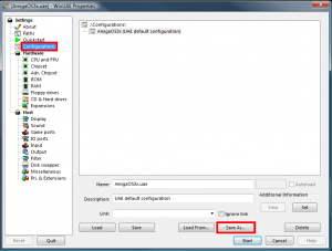

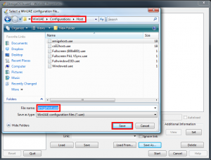

Almost done! Now to save the configuration. Click on Configurations on the top left. Click the Save As... button:
You should now see a save as dialogue box. We want to save the configuration file as amigahost.uae in the H:\HyperSpin\Emulators\WinUAE\Configurations\Host directory:

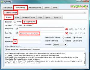

Click the Main Menu Wizard tab and add your system. Once the wheel is created, click Wheel Settings and choose Commodore Amiga in the dropdown.
Set your "Rom Path:" and "Extensions:" as shown below:

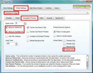

Note: The next step is only required if you use HyperHQ for filtering your roms.
If you are using HyperHQ to filter your roms. Click on Navigation/Themes as make the following changes:

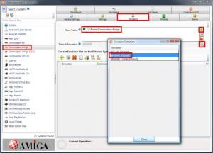

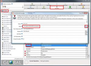

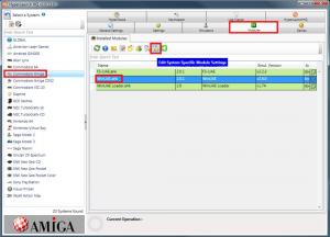

Make sure GLOBAL is selected on the top left. Then select the Emulators tab on top. Scroll down and find WinUAE and double-click.
Set your Path to WinUAE and close out that window:

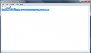

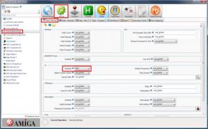

Select Commodore Amiga on the left and Settings across the top. In the Main Settings sub-tab change 7z Enabled to false:

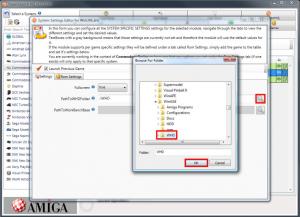

Now we need to set the PathToWHDFolder. Make sure Commodore Amiga is selected on the left. Click on Modules on the top. Select WinUAE.ahk and click the Edit System Speciffic Modules Settings button:
Use the browse Magnifying Glass to browse to H:\HyperSpin\Emulators\WinUAE\WHD and hit the OK button:

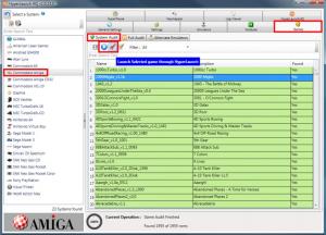

Close out that window and click on the Games tab on top and make sure the System Audit is selected. Click the blue play button to audit the games. Select one and hit the Launch Selected game... button to see if it works:

Seems good to me, nice work. Just a couple of notes:
- PathToWHDFolder shouldn't be enclosed by double quotes, kinda surprised it actually works that way. Also I don't like users to be editing ini files manually as that will eventually lead to problems, would be better if you include setting this up in the HLHQ part of the guide. That's why HLHQ was created in the first place ;);

Brolly,
Thank you for your review and input. I didn't see a place to put in the path. Dug around some more in HLHQ and found it!! Nice! I will fix that. Wow, never saw those settings before. I thought that would be in Global Module Settings not System Specific Settings.

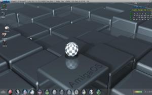

Once you see the desktop:

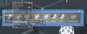

Double click the Work icon. That will open the Work drive. Right click somewhere inside that window, click on Window, go over to Show and click All Files:

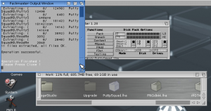

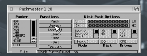

Find the Putty Squad.lha icon and double click it. That will open up Packmaster. Hit the Unpack button:
That will extract the contents into your Ram Disk. Click the Close button as described in the window. Then close Packmaster and the Work folder.

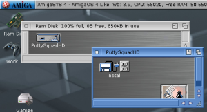

Open the Ram Disk by double clicking on it's icon at the top left of the screen. Then open the PuttySquadHD drawer. There you will find the Install program.

Hit Start for the last time. It will read the second disk and finish out. Close the last Install box by hitting the Proceed button.
Thats all. Its done. You can check your work by opening the Work Drive from the icon on your desktop and run the game. If everything works. Close out the AmigaSYS workbench and Amiga Forever Player.
Now, navigate to your AmigaSYS4-Work folder and there should now be a PuttySquad folder and PuttySquad.info file. Zip both these up and you now have a Working Putty Squad WHDLoad install!!!
