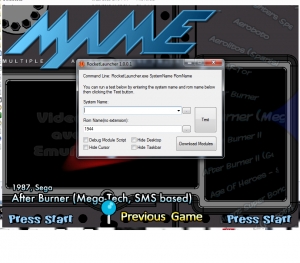

zerocool420 Posted June 24, 2015 Author Posted June 24, 2015 yes, I have the paths set correctly in rocket launcher for both mame and the roms. When I run hyper spin, I can hit enter on mame and it will show all the games but when I hit enter on a game it brings up a rocket launcher script asking to check a game. Im so lost, ive loaded hyper spin and rocket launcher 3 different ways that ive found on the net and none of them have worked yet. I would really appreciate any and all help, thanks!!

zerocool420 Posted June 24, 2015 Author Posted June 24, 2015 I have a screen shot and a log file but I don't know how to upload them here, can I get some instructions?

zerocool420 Posted June 24, 2015 Author Posted June 24, 2015 here are the log file. I don't know about the transition tool in rocket launcher, none of the setup pages have said anything about it. do you mean a transition tool for hyper launcher to rocket launcher, I never had hyper launcher installed, I started with rocket launcher. log.txt
zerocool420 Posted June 24, 2015 Author Posted June 24, 2015 heres a screen shot of what it looks like.

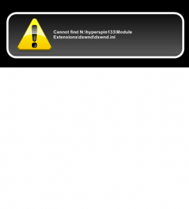

zerocool420 Posted June 24, 2015 Author Posted June 24, 2015 hey simply Austin, I have been trying to load rocket launcher but I watched your video and found the link to hyper launcher and did a fresh install of hyper spin and hyper launcher. now when I start hyper spin and go to select a mame game I get this screen. What do I need to do now?
criscrow Posted June 24, 2015 Posted June 24, 2015 i was stuck at that same point earlier and i found the missing file in my computer and added it to the directory.... I was then able to launch games from the launcher but im still stuck with launching from hyperspin
