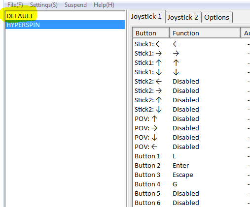

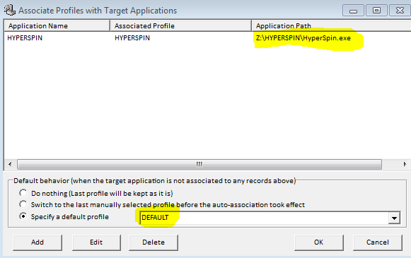

Spawk Posted June 21, 2018 Posted June 21, 2018 Tip if anyone goes this route: Create a totally blank "DEFAULT" profile that will be used when windows starts (HS uses "enter" and "esc" which can open/close all kinds of windows programs so best to do this!) Then under "Settings" --> "Associate profiles with applications" make sure the path to HS.exe is set (program can capture app but best to copy paste path in I think) and the default profile is set to the DEFAULT one you created.

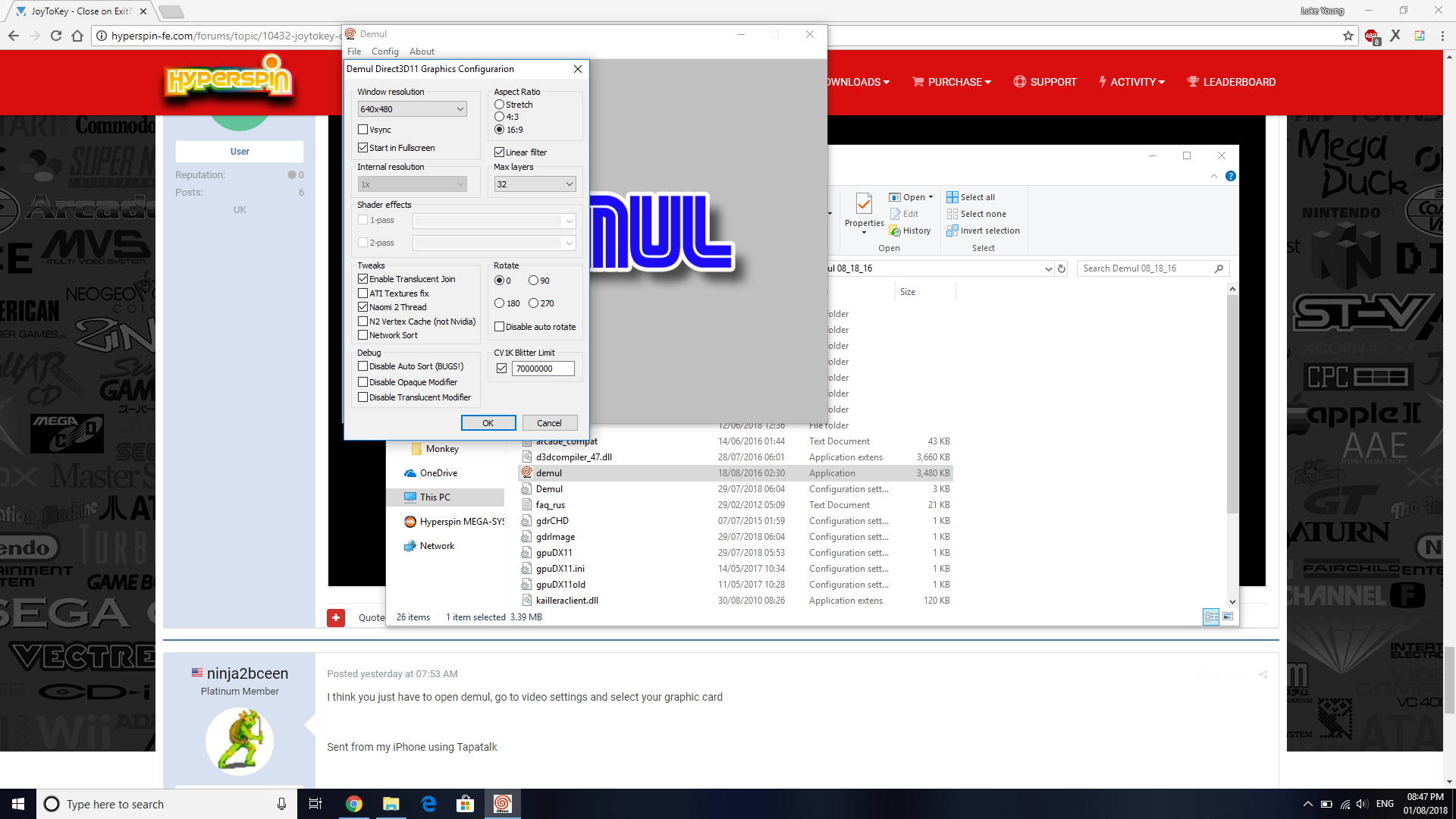

Zancou Posted July 29, 2018 Posted July 29, 2018 Can anyone help with this error i have tried what it says but wont work.
ninja2bceen Posted July 31, 2018 Posted July 31, 2018 I think you just have to open demul, go to video settings and select your graphic cardSent from my iPhone using Tapatalk Advance the cause to 100%. http://hyperbase.hyperspin-fe.com/ Planet Geekdom, Subscribe for Tutorials! https://www.youtube.com/channel/UCdcby-s2GwriaOHGmVC2vGA?sub_confirmation=1&app=desktop
