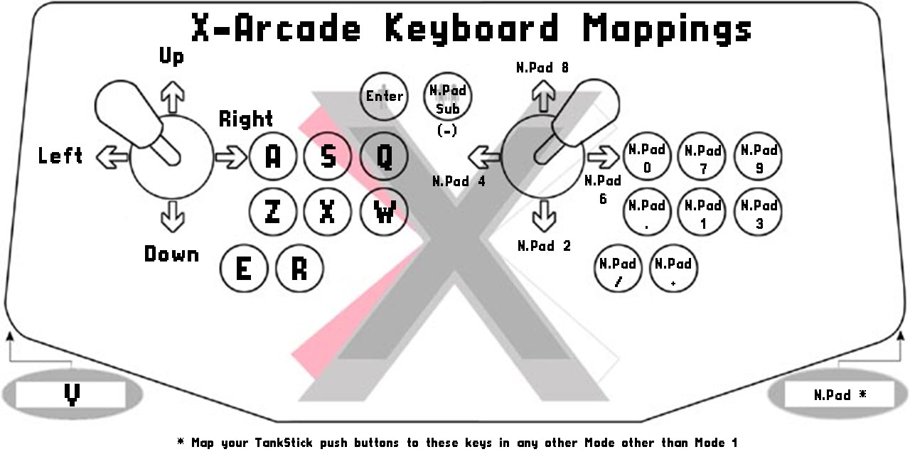

So essentially what you need to do is do a one-time program a set of keys in a mode of your choice, such as Mode 2 (You can't modify Mode 1 which came pre-programmed in factory). The main key bindings is based on the default input setttings for RetroArch.
A thing to note that this script is not only limited to be used with the Tankstick layout and you can simply use it in your own usual 6 buttons layout too. The key placement is tailored for the X-Arcade 6 buttons layout and an additional 2 more at the third row. Many had complaint about the third row buttons, but I found it to be a blessing which I can conveniently map to other hotkeys such as RetroArch rewind and slow motion.

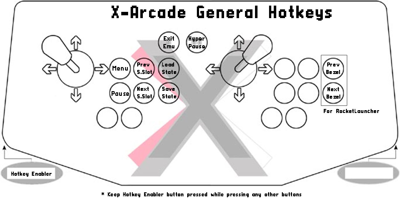

The keys function are divided into two sets:

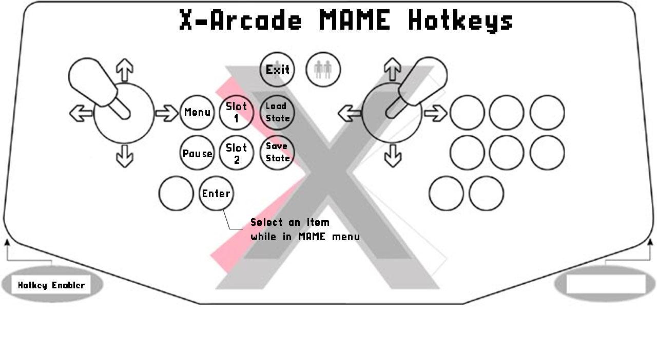

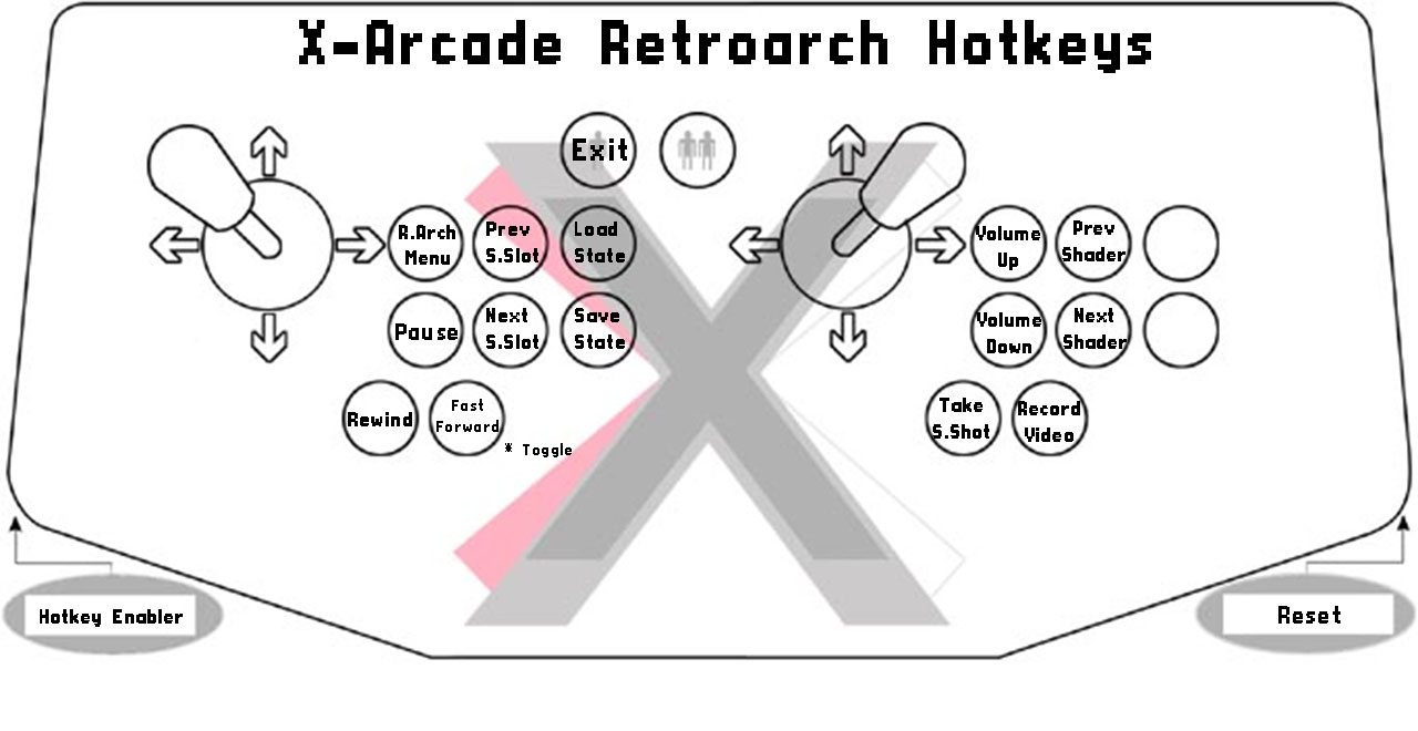

1. Hotkeys
Keys that are not related to the game, but rather emulator (e.g. save state, load state, previous save state, test mode, service mode...)
To enter to this mode, keep the Hotkey Enabler pressed while pressing any other buttons.

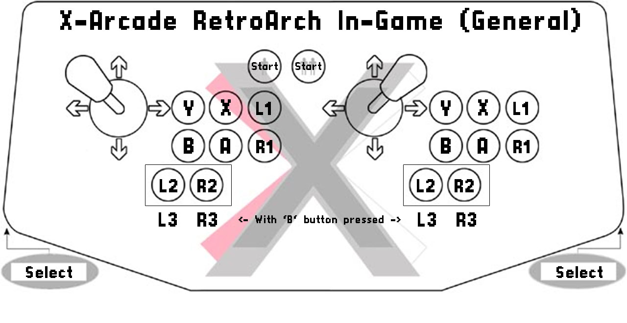

2. In-Game
Keys that are mapped to the game controller.
It does not requires the Hotkey Enabler to be pressed.
Most of the emulators have key set for Player 1, future release will include bindings for Player 2 as well.

Make sure you switch your TankStick in Mode other than the default Mode 1 and program each buttons with the following keys.
And that's it. Oh and you'll of course have to configure some emulators keys too that binds to the programmed keys.

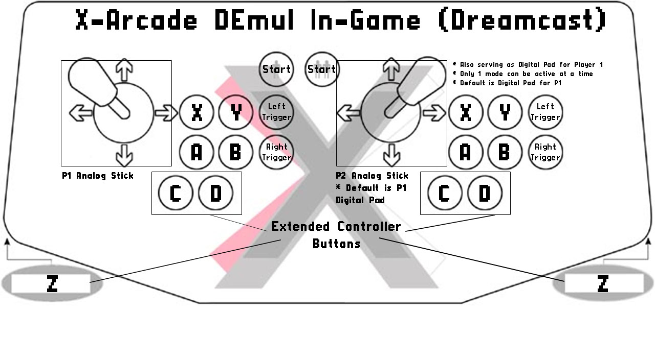

Completed 2-Player Keyset Bindings
ePSXe
MAME
RetroArch
Layout

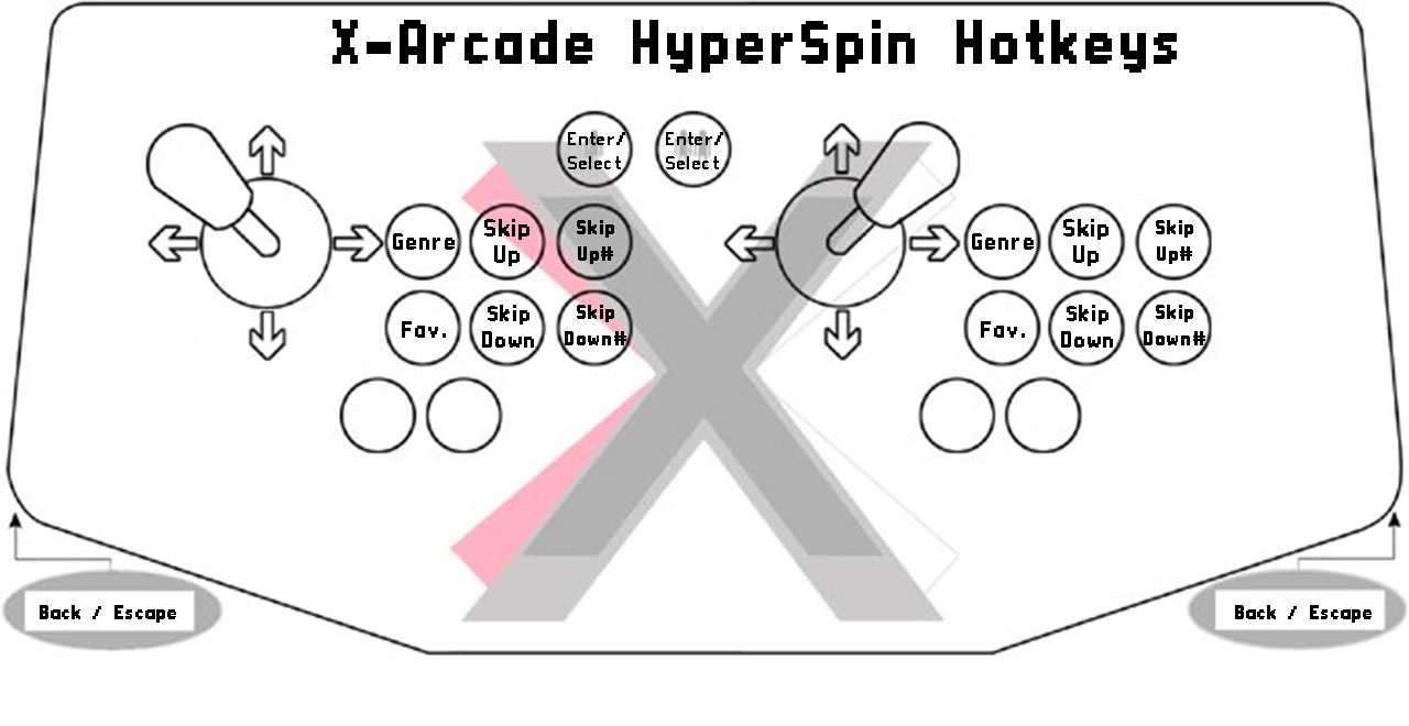

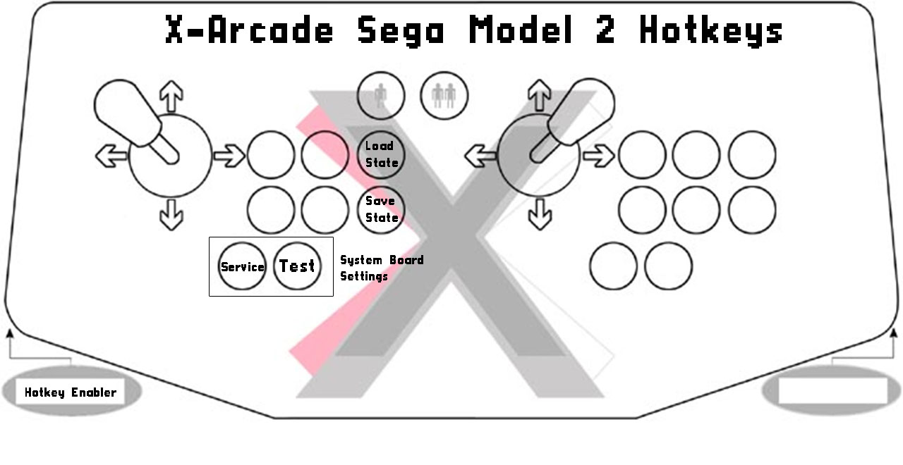

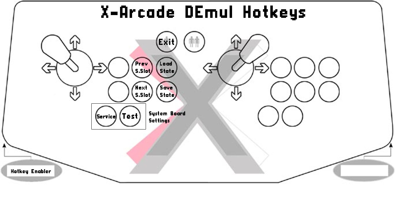

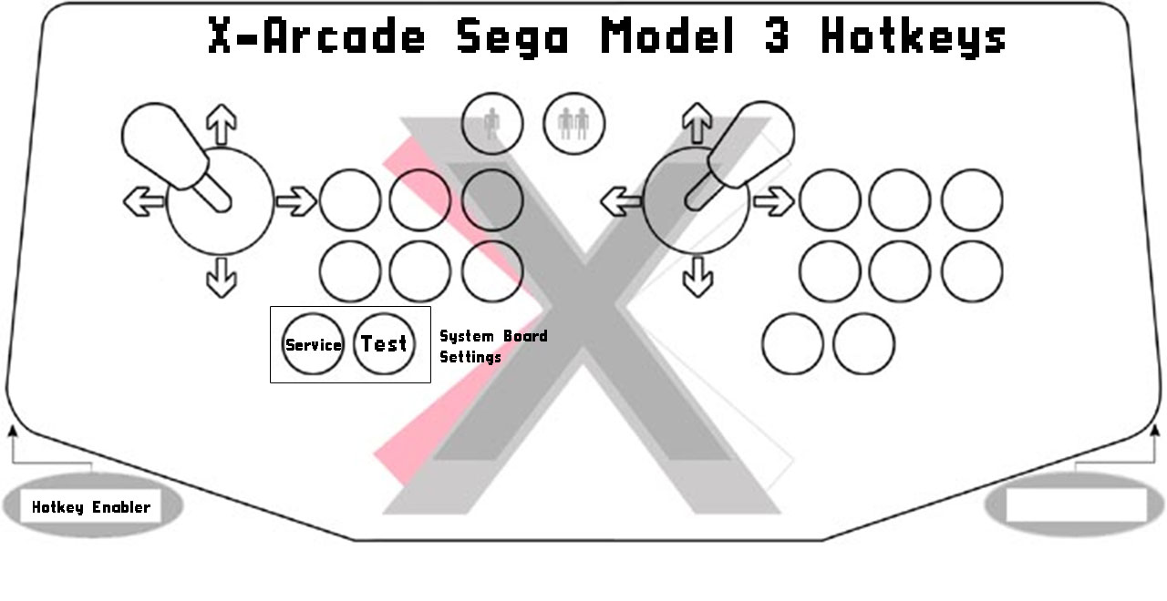

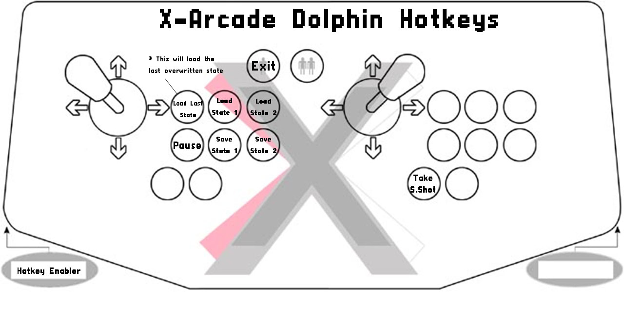

General Hotkeys
HyperSpin Front End
MAME
RetroArch

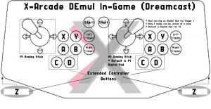

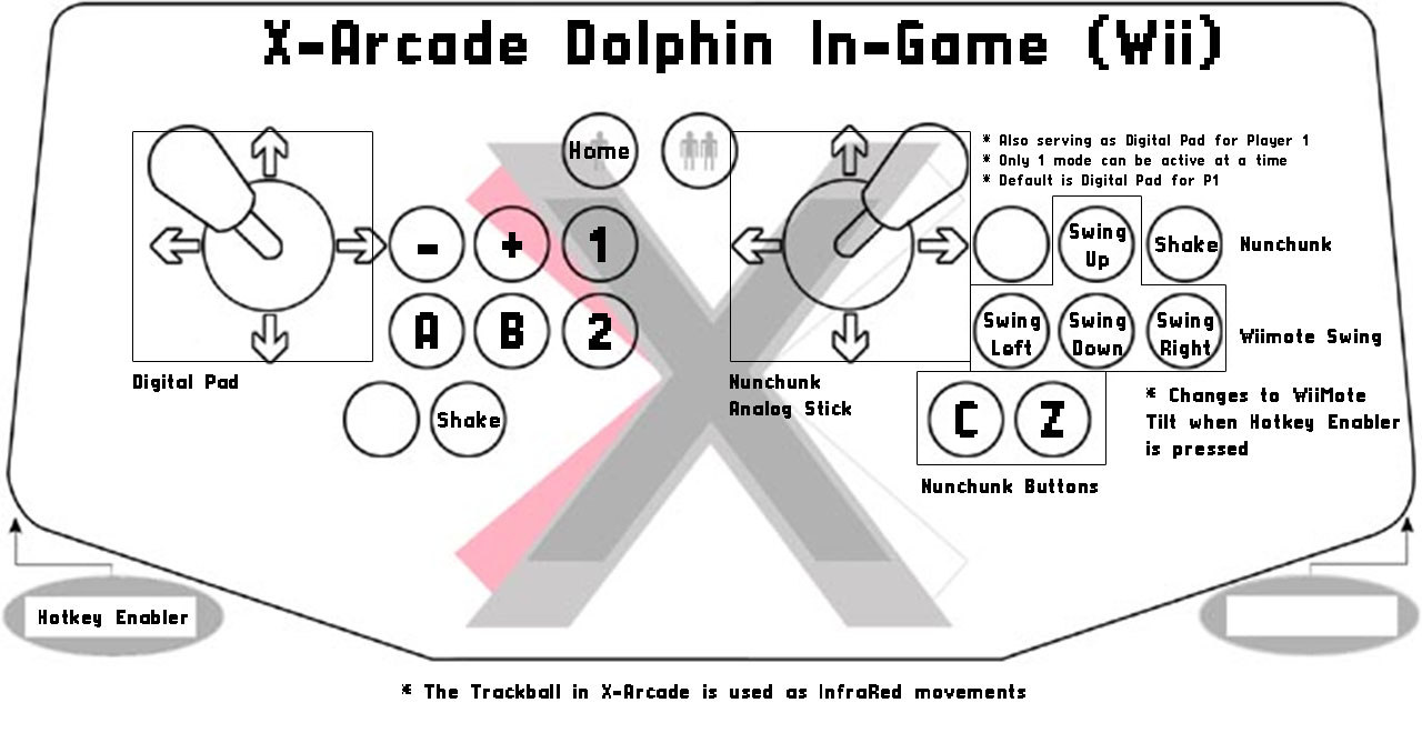

DEmul
Dolphin

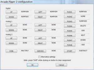

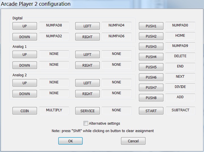

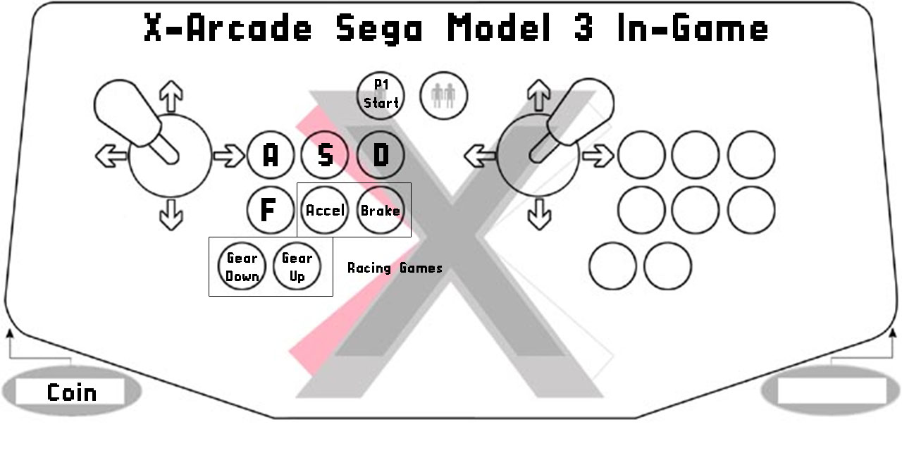

Sega Model 2 Emulator
Supermodel
ePSXe

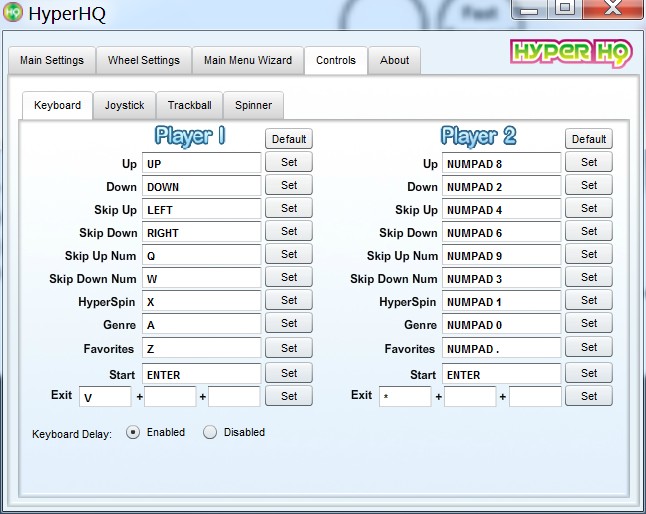

Front Ends Key Bindings Configuration

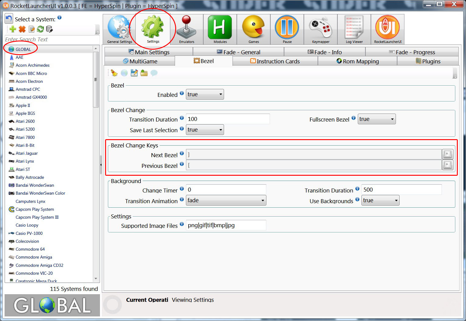

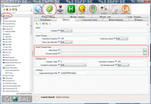

HyperHQ (HyperSpin GUI Config)
RocketLauncher

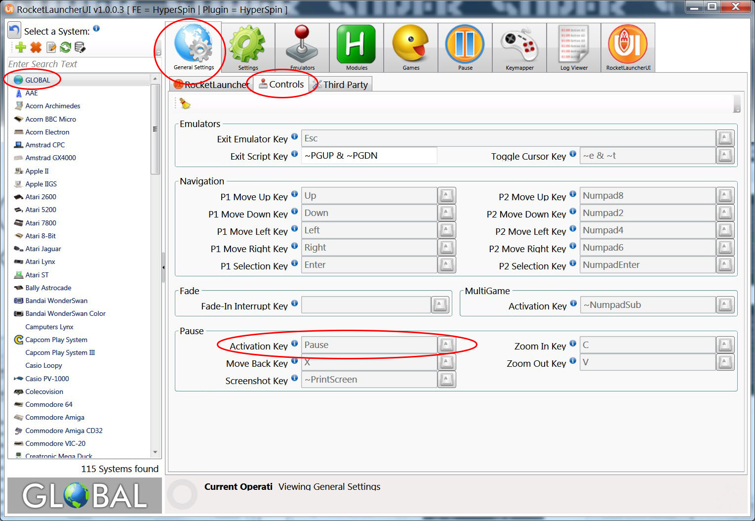

This is completely optional. Only do this if you want to switch bezels or activate HyperPause

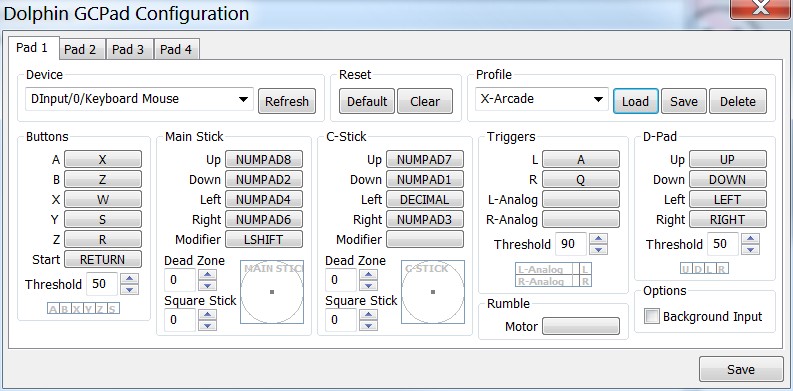

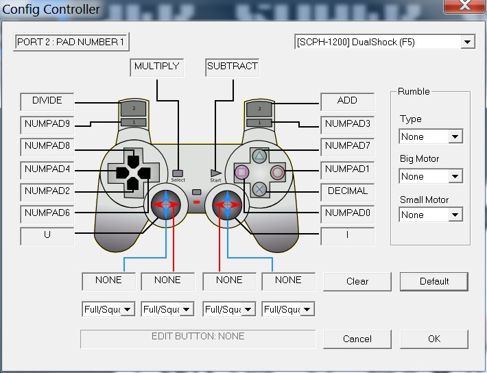

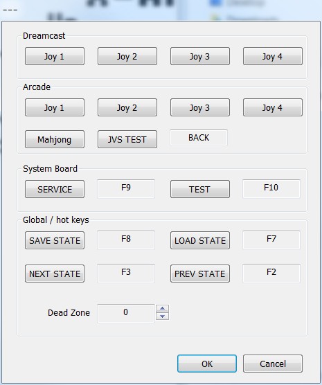

Emulator Key Bindings Configuration
Make sure you open up each of the following emulator and go to the Input settings and configure each keys to match the screenshots below:
* Not all emulators required configuration.
* When configuring the keys, make sure the NUMLOCK is ON to register Player 2 Numpad inputs correctly.

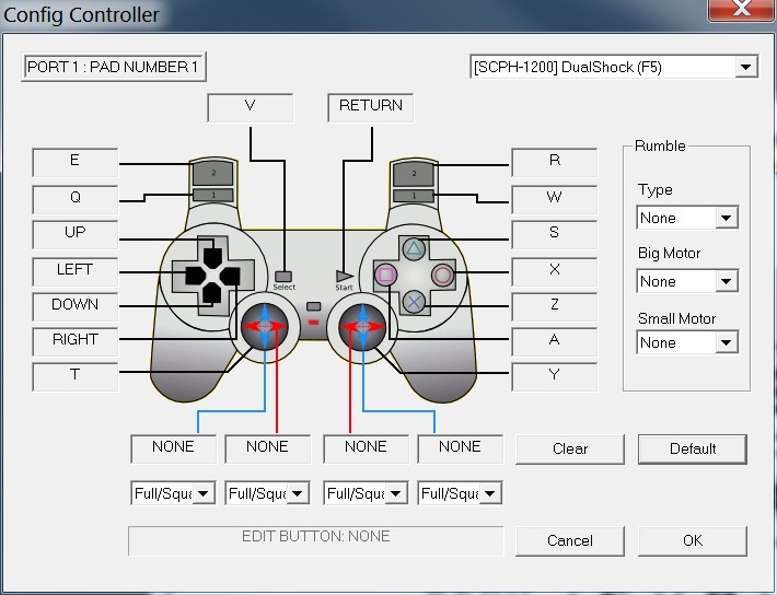

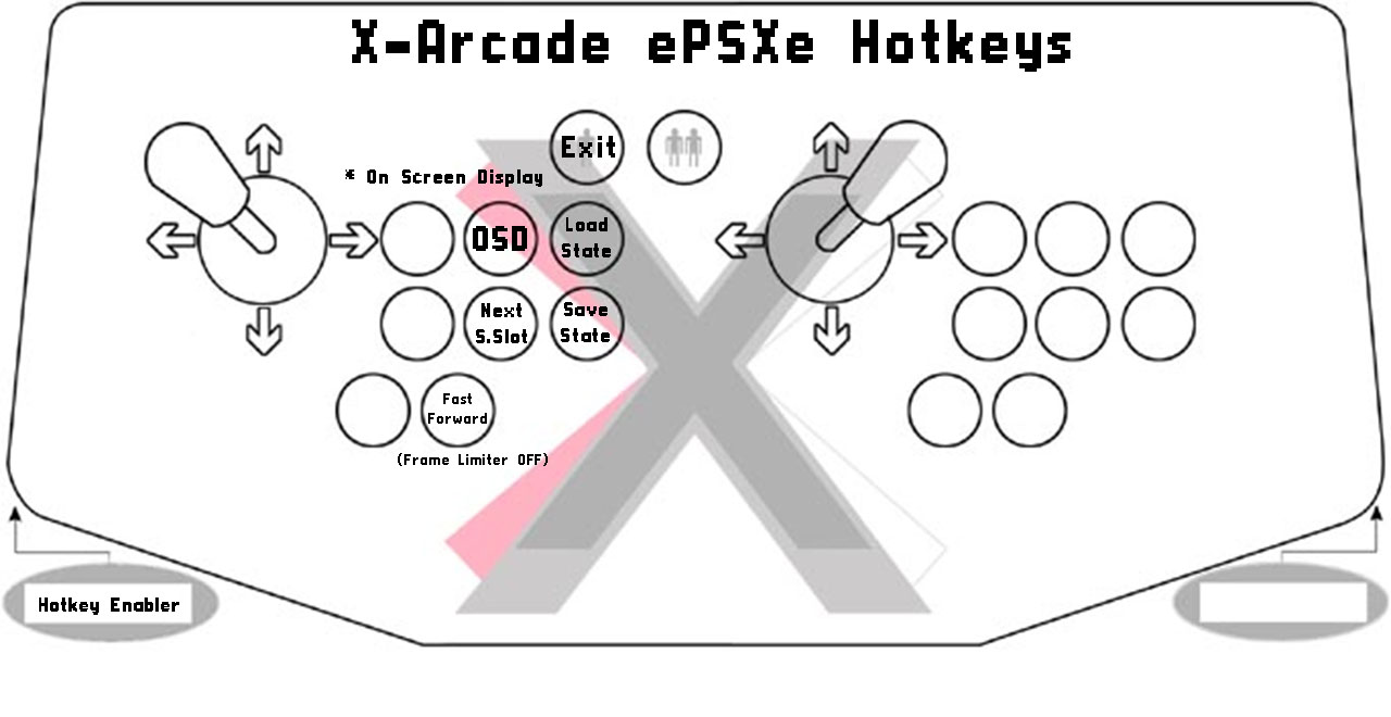

ePSXe

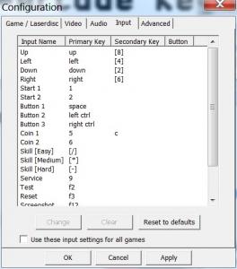

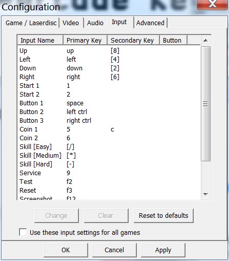

Daphne
No configuration needed.
X-Arcade keys are mapped to Daphne default keymaps.

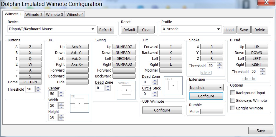

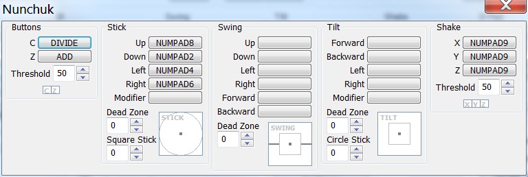

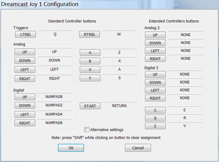

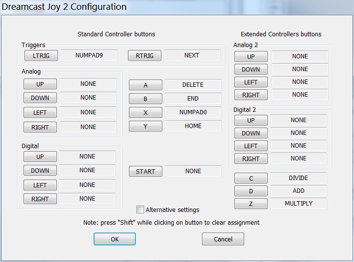

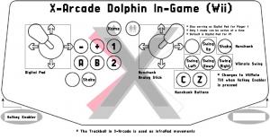

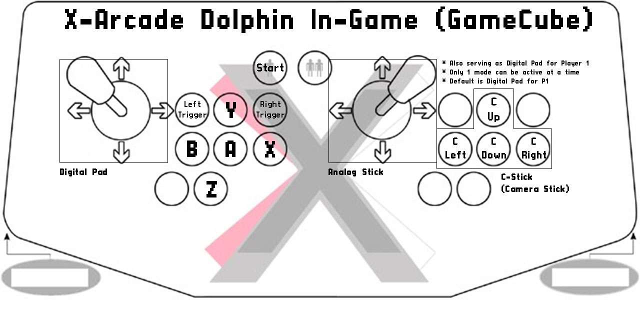

Dolphin

RetroArch

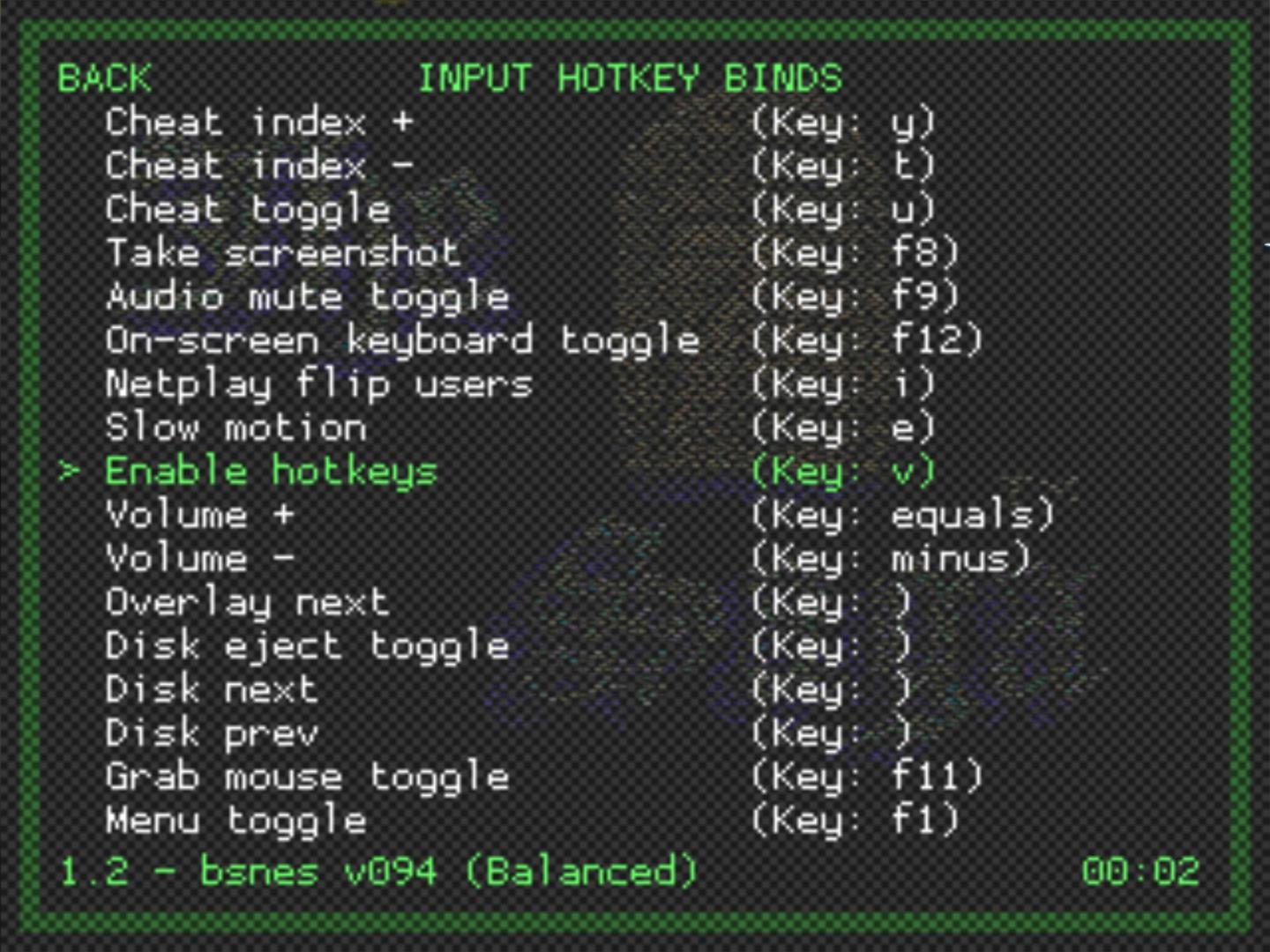

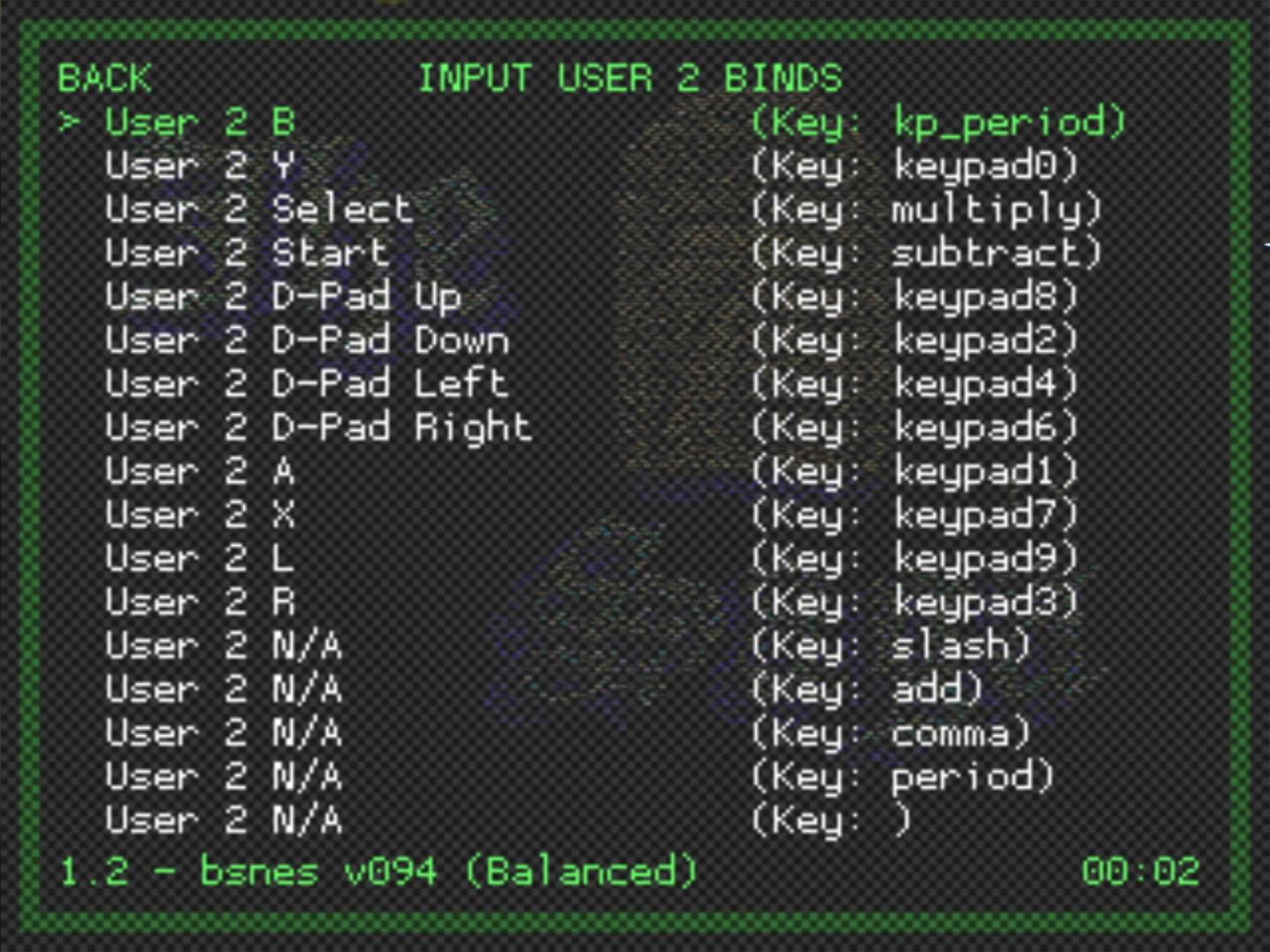

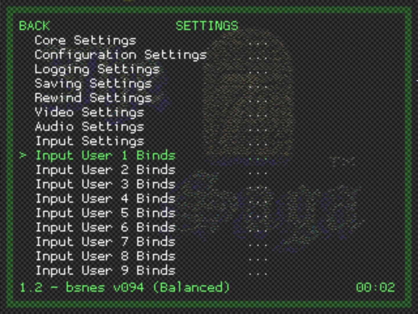

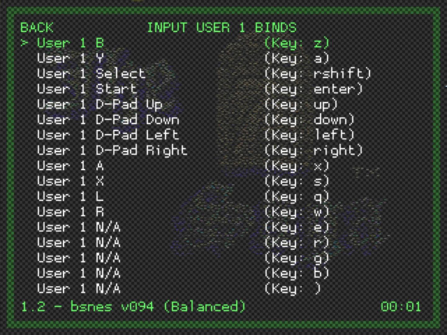

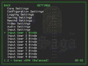

There are two ways to modify the key bindings in RetroArch:
Method 1 - Modify the .cfg files manually.
1. Open retroarch.cfg (or <corename>.cfg inside the /config folder if you're using Per-Core Configuration settings) and replace/overwrite the existing key values with the following:
input_player1_b = "z"
input_player1_y = "a"
input_player1_select = "rshift"
input_player1_start = "enter"
input_player1_up = "up"
input_player1_down = "down"
input_player1_left = "left"
input_player1_right = "right"
input_player1_a = "x"
input_player1_x = "s"
input_player1_l = "q"
input_player1_r = "w"
input_player1_l2 = "e"
input_player1_r2 = "r"
input_player1_l3 = "g"
input_player1_r3 = "b"
input_player2_b = "kp_period"
input_player2_y = "keypad0"
input_player2_select = "multiply"
input_player2_start = "subtract"
input_player2_up = "keypad8"
input_player2_down = "keypad2"
input_player2_left = "keypad4"
input_player2_right = "keypad6"
input_player2_a = "keypad1"
input_player2_x = "keypad7"
input_player2_l = "keypad9"
input_player2_r = "keypad3"
input_player2_l2 = "slash"
input_player2_r2 = "add"
input_player2_l3 = "comma"
input_player2_r3 = "period"
input_volume_up = "equals"
input_volume_down = "minus"
input_enable_hotkey = "v"

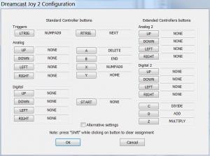

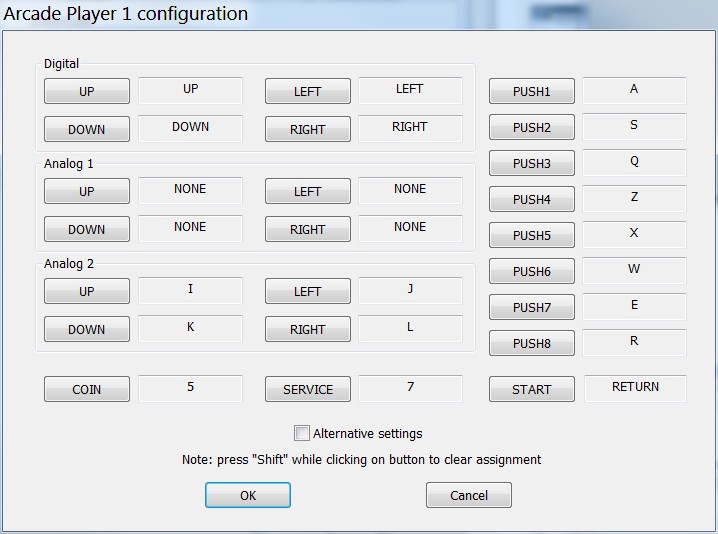

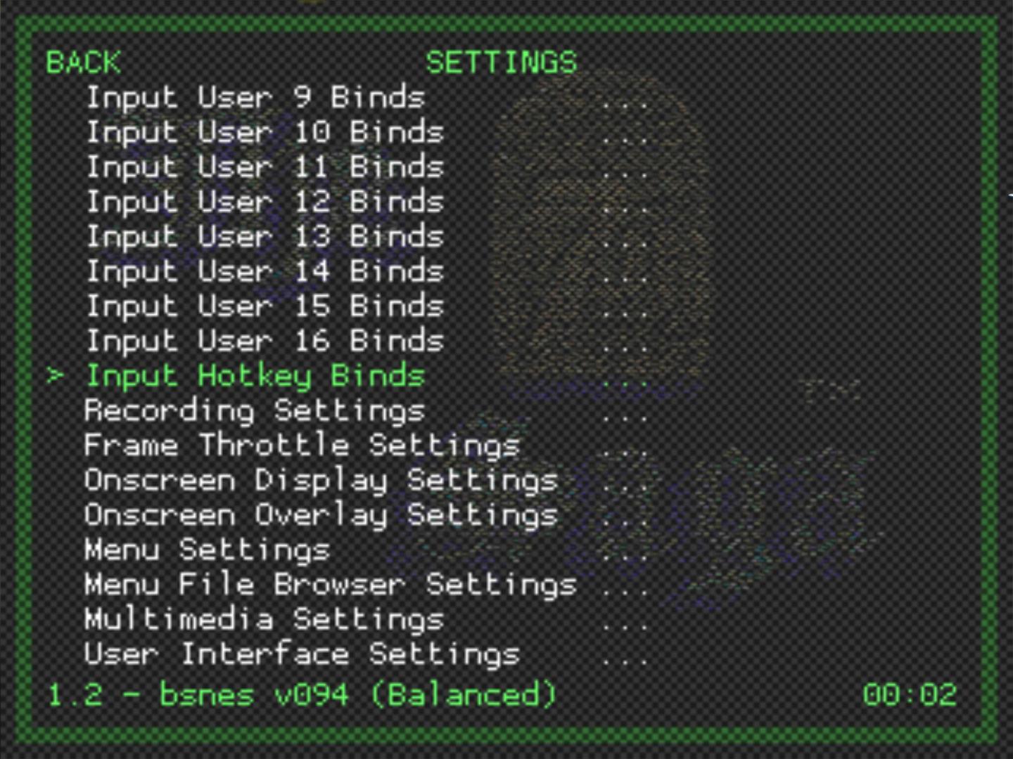

Method 2 - Use RGUI and go to Input Bind Configurations and set up these keys accordingly. Make sure NumLock is ON
post-62687-0-87709500-1437671964_thumb.jpgpost-62687-0-89705000-1437667452_thumb.jpgpost-62687-0-92799700-1437667467_thumb.jpg

As above mention
Which is the Hotkey enabler button?
It's the second left side button (or Pinball button) closer to the bottom. The upper side button is used to simulate left mouse click.

I am clueless.  I am using Hyperspin, HyperHQ and HyperLaunch.  At this point all I really want to be able to do is open Hyperspin, select MAME and play games that are in the MAME selection.  Once in MAME play a game and then EXIT back to MAME to select another game.  I can not EXIT without using the keyboard.
From the instructions above, I set MODE 2 to match QUICK START and the Front Ends Key Bindings configurations in HyoerHQ, no luck.  Am I missing a step?

And how under the Rocketlauncher configuration, how do you get "Pause" in the Activation key?

Reprogramming the escape key is one of the few things I figured out. This page has the instructions:
http://www.xgaming.com/support/questions/99/Using+X-Arcade+With+Hyperspin
Within hyperhq, under controls/keyboard reprogram "exit" for player 1 to be two or three button pushes - something you wouldn't normally expect to hit when playing a game. When in a game, you have to hold down these three buttons for a second or so and that will exit.

2. I go to try and configure RocketLauncher, EXACTLY like Dysncs tutorial, and the same options do not show up. This is where I feel like I am missing something, I have tried to read up on all of the Keymapping, AHK, etc, but am a bit lost. I sort of understand the profile thing, but not really. Do I need to set up some sort of systems hot key?
3. According to D.Syncs tutorial, the "HotKey/Modifier" would be the "V" key correct?
4. I understand that Rocket Launchers Mapping functionality isn't great, so I even bought Xpadder, but I don't think that's what I need. That being said, if it is an option for me...I will def go that route.
5. Where/How would I set up AHK profiles through RocketLauncherUI?
