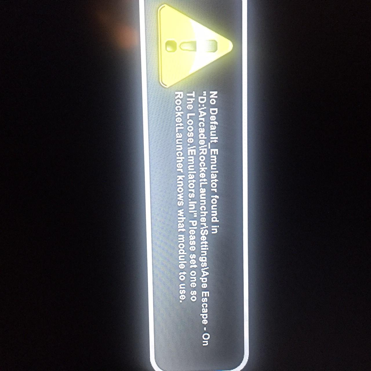

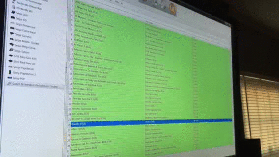

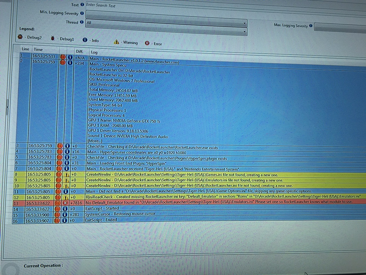

rdyott Posted July 20, 2015 Posted July 20, 2015 CAN launch games via rocketlauncherUI, CAN NOT launch games via hyperspin using rocketlauncher. Im sure it has to be something simple i did wrong. or a simple file needing to be edited. Please help. Long time lurker. n00b poster. It seems that the from hyperspin its messing up the command? its putting the rom name where the emulator folder name should be. Im using hyperspin 1.4 (latest rev) rocketlauncher (auto updated) But when I attempt to launch ANY game via hyperspin. i get this error: (gif of what happens) http://i.imgur.com/iBur9KC.gif (photo of error image) (sorry for sideways) http://i.imgur.com/kg61fc6.jpg But when i use rocketlauncherUI i can launch games fine. (gif of it working) http://i.imgur.com/uMJnEEJ.gif here are my log files: http://i.imgur.com/cIj9Eml.jpg http://i.imgur.com/zXhgnj6.jpg

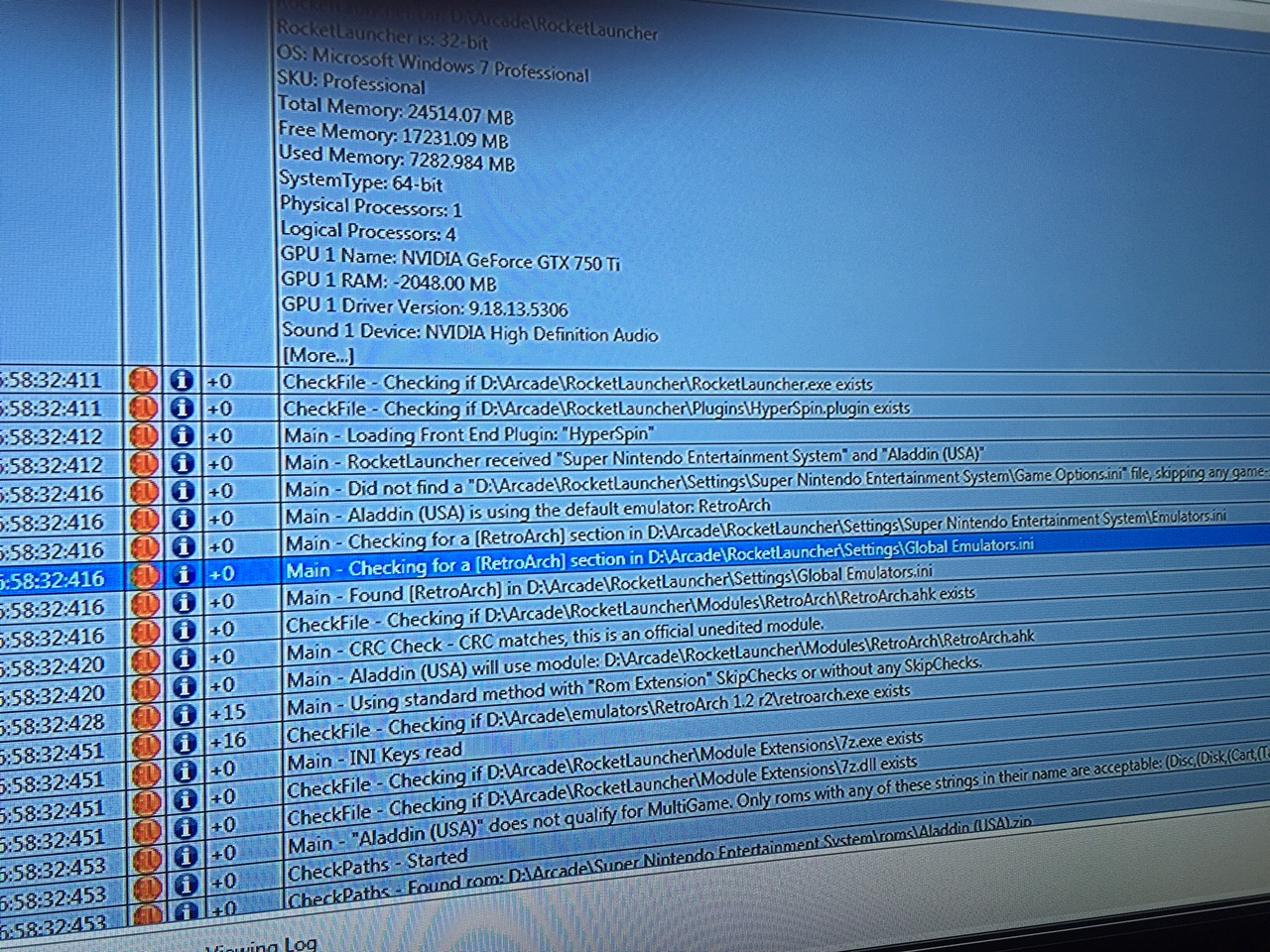

gigapig Posted July 20, 2015 Posted July 20, 2015 Strange how it launches fine with RLUI and then RL throws up an error when run through HyperSpin. Have you got another install or something? Post your logs, thanks.

32assassin Posted July 21, 2015 Posted July 21, 2015 CAN launch games via rocketlauncherUI, CAN NOT launch games via hyperspin using rocketlauncher. Im sure it has to be something simple i did wrong. or a simple file needing to be edited. Please help. Long time lurker. n00b poster. i understand HS1.4 is a beta.. but HS1.3 doesnt have this problem. when i use the other Hyperspin.exe everything works. I would use HS1.3 but HS1.4 fixes the horizontal scroll bugs. and i love the horizontal views (namely Dark's Aeon Nox theme) ( since I use Aeon Nox on my Kodi HTPC, what hyperspin is on) seems to me that you ran the transition tool and then updated to HS v 1.4 you can't just switch back and forth from v 1.3 and 1.4 without adjusting your HyperHQ settngs. this is why you are getting the No default emulator found error.
rdyott Posted July 21, 2015 Author Posted July 21, 2015 seems to me that you ran the transition tool and then updated to HS v 1.4 you can't just switch back and forth from v 1.3 and 1.4 without adjusting your HyperHQ settngs. this is why you are getting the No default emulator found error. You spying on m me in my house? Yes sir.. thats saddly what i had done. How do i go about fixing it? make adjustments in HyperHQ? or am i too far gone & borked eerything up?

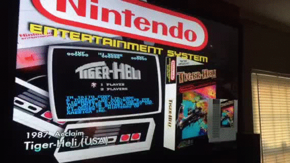

(gif of it working)
