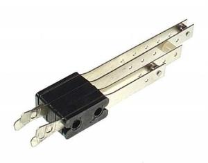

You could use one of these: http://www.marcospecialties.com/pinball-parts/SW-2010A
