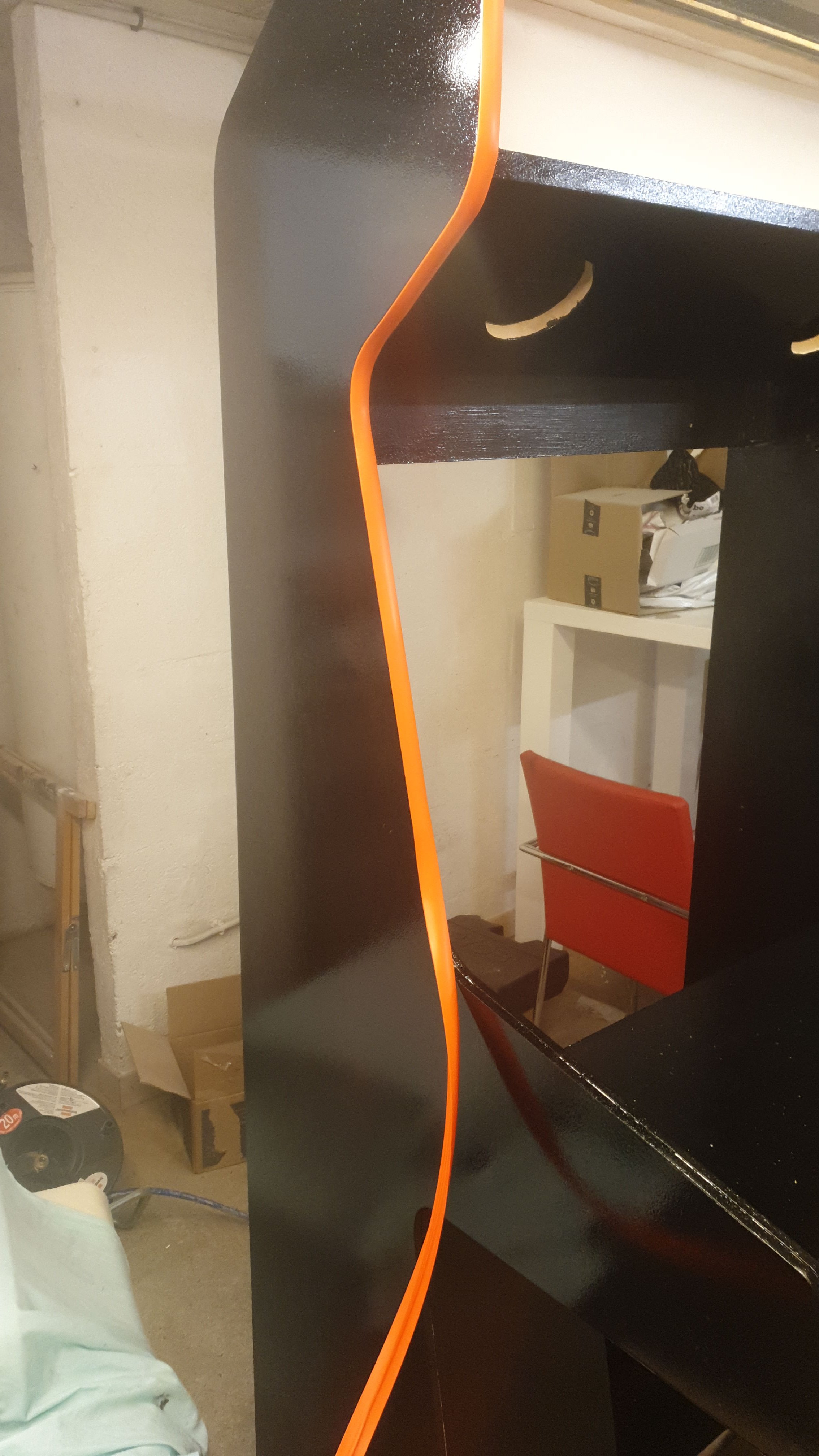

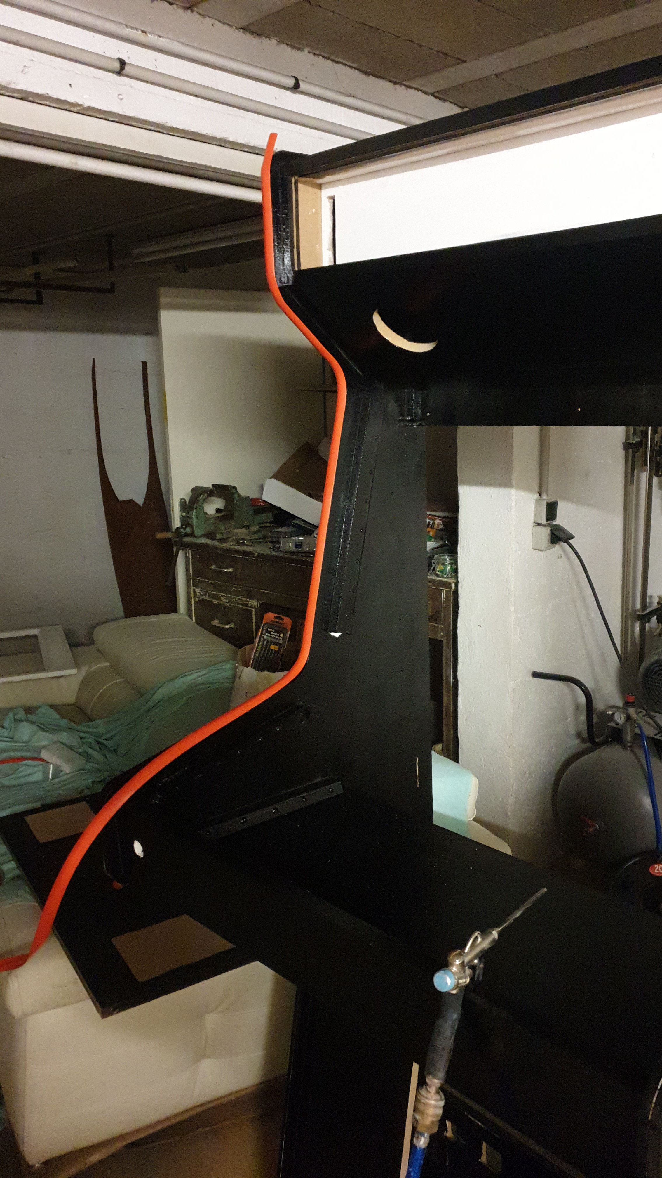

ripleyxlr8 Posted July 13, 2019 Author Posted July 13, 2019 Trying out the T-molding. Everything is flush!

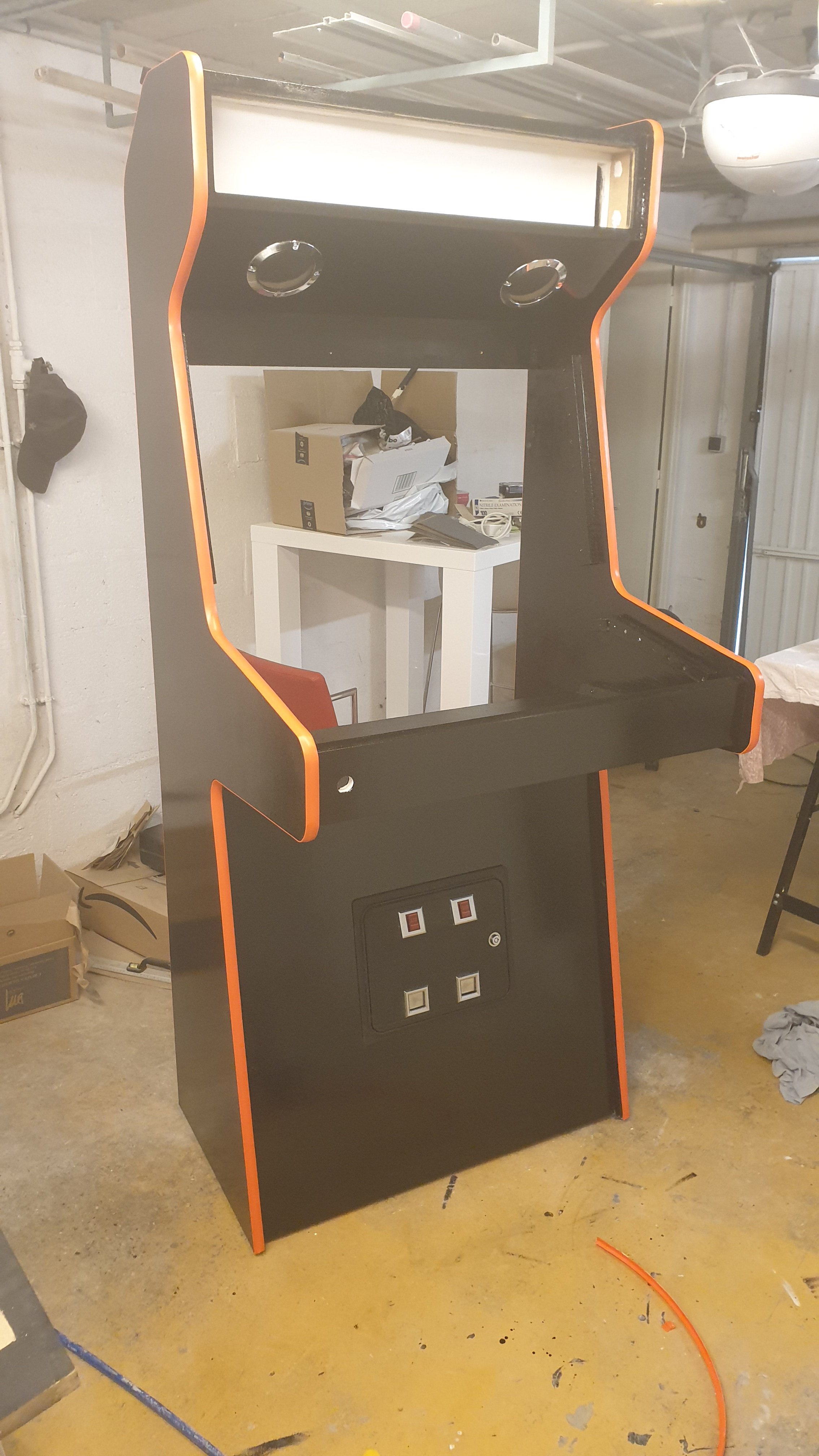

ripleyxlr8 Posted July 14, 2019 Author Posted July 14, 2019 It's starting to look like an actual arcade cabinet... Since i can't have a nice paint finish on the part where wrists will lay, i'm thinking about putting some t-molding on it.
