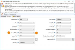

gigapig Posted September 19, 2015 Posted September 19, 2015 You know I never really noticed it and like Dougan I was probably blind to it, but yeah it happened on mine. The key setting under "Edit Global Module Settings" for DC is "alwaysOnTop" so make sure it's set to off. Here are my settings, I also use Fade and Bezels. P.S. You will need to use fade with the above or you will see the splash screen.

demonseed Posted September 19, 2015 Author Posted September 19, 2015 Ok So I set my module to all the same. I checked fade I have it set to TRUE.. splash screen still shows. What settings are on your fade setting screen? I turned on Bezels and it now works!! thank you so much!! Now I need to find good bezels!!! Where do we get those I do not see them anywhere. I tried copying my Black bezel I used with PS2 but it is not working.. its all black and I can here the DC game in background, but nothing on screen. Also, is there a link or how to set up those DC games (I think called CE games) that need to run on alternate emulator? Thanks again! this was such a pain in the b*lls for the longest time!!

ninja2bceen Posted September 20, 2015 Posted September 20, 2015 I turned off noconsole to match what the pic showed and moved always on top to no. I have bezel on and fade. Does fade have to be set to X length to get this to work? I still see the splash Tapatalk signature Advance the cause to 100%. http://hyperbase.hyperspin-fe.com/ Planet Geekdom, Subscribe for Tutorials! https://www.youtube.com/channel/UCdcby-s2GwriaOHGmVC2vGA?sub_confirmation=1&app=desktop
