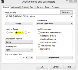

Ok here is the point: Most of my roms and CD based games are all 7zipped to save disc space. Now, the problem comes when you launch a GameCube, or PS2 game or any "big" CD game. It takes ages to uncompress by HL. I saw that the new HL2.0 has a nice loading bar when unzipping your game. This helps you to wait without asking yourself: "Is it still loading?" but waiting sometimes 1 to 2 minutes before you can play your PS2 game is simply too much...
I decided to look back to the old WinRar and learned today that WinRar 5 was beta and available to download. So I decided to give it a try and measure it against the previous WinRar version which is 4.20 and 7zip 9.20.
As you can see below, the time to uncompress WinRar 5 archives is simply amazing! Take the first example: 53 seconds to launch Alone in the Dark DreamCast if the iso is 7zipped. I takes only 7 seconds with WinRar 5 and 11 with WinRar 4.20. Now some people might say WinRar is faster but does not compress as well as 7zip. That was true with previous versions of WinRar. If you check my last test, you see that WinRar 5 compresses as well as 7zip 9.20.
For me WinRar 5 clearly beats 7zip because of it's great performance speed while keeping very efficient compression ratios.
On thing to pay attention though is that WinRar5 uses a new archive format and older WinRAR versions are not able to decompress RAR 5.0 archives. So if you plan to send an archive to other people, it is necessary to take the compatibility issue into consideration. You can select "RAR" instead of "RAR5" option in archiving dialog to create RAR 4.x archives compatible with previous WinRAR versions.
Here are the results: (I just picked some random CD games.)
(Tests done on a SATA3 HDD Core i5 Sandy Bridge 4 core 3.2Ghz)
7zip 9.20 64bit version used default settings.
WinRar 5.0 64bit default settings.
WinRar 4.20 bit default settings.
