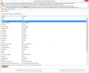

djvj Posted January 2, 2014 Posted January 2, 2014 I was hoping to have the tables launch individually with their own videos from inside hyperpin, what I've read here and on the vp forum it all sounds a bit too hacky (is that a word) for me. I'll just add it to HS as a PC game, much cleaner Spent a couple hours last night creating a proper method to do this in module form and it works great: This can, of course, be adopted into FPLaunch as their current method can't do specific tables. "Computer games don't affect kids; I mean if Pac-Man affected us as kids, we'd all be running around in darkened rooms, munching magic pills and listening to repetitive electronic music."RocketLauncher's Official Home If you appreciate my work:My Apps:Window LoggerIdle Volume AdjusterExplorerRestorerRom Folder CleanerModule UpdaterMy Guides:How To Mod Guncons with Aimtrak
connorsdad Posted January 2, 2014 Posted January 2, 2014 Nice work djvj Look forward to the release, very tidy. Could be used for individual tables via HP or individual tables via a Pinballfx2 wheel. Top man. Sent from my SM-N9005 using Tapatalk
