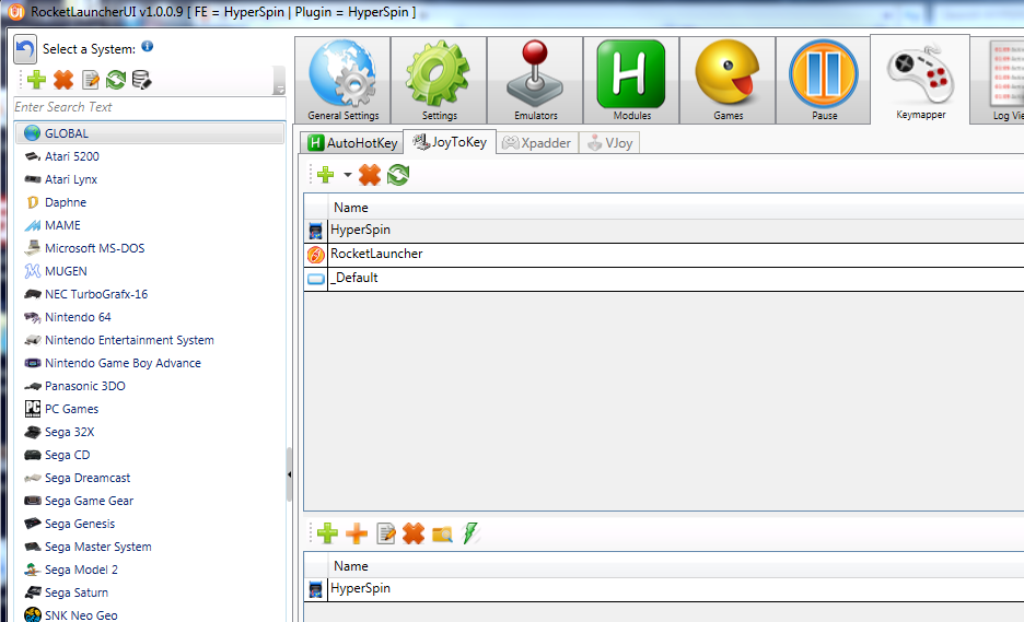

Spawk Posted January 10, 2016 Posted January 10, 2016 I am at work now so cant check mine. But in that global screenshot I don't see _default or rocketlauncher profiles... yes they are needed. The RL portion of my tutorial should still be relevant to xpadder users. Please read it! I may have to just break down and buy xpadder to see why people are having such a hard time with it. Sent from my SGH-I337M using Tapatalk
Spawk Posted January 10, 2016 Posted January 10, 2016 Did you get this sorted then? This is what I meant in my last post: xpadder does not need the RocketLauncher and _Default profiles??? You posted pics so I am just pointing out what I see... if you get it sorted please share for the rest of the xpadder users!
mccorkled Posted January 10, 2016 Author Posted January 10, 2016 I tried that but it is still not switching profiles. Aeon Nox XIII Themes Minted Cases w/ Reflection : Minted Cases : Minted XMLs
sirk123au Posted January 12, 2016 Posted January 12, 2016 You have to enable Keymapper in global settings.
