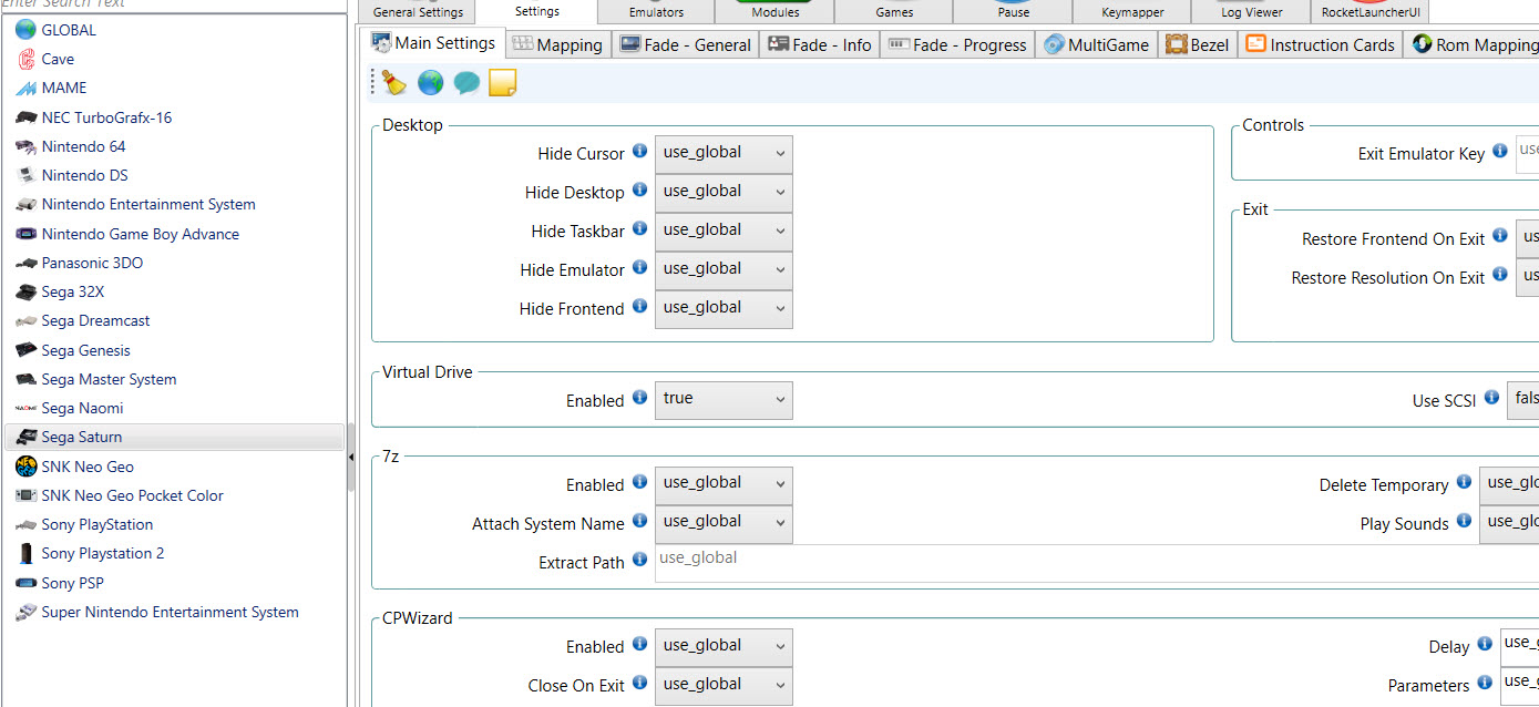

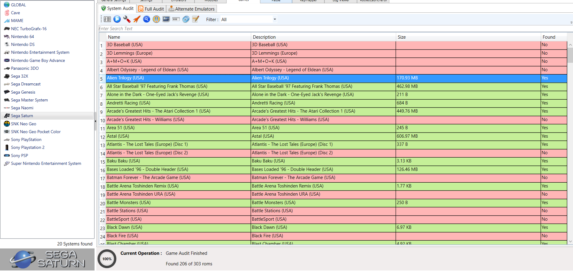

Lucius_Bundy Posted January 18, 2016 Author Posted January 18, 2016 Hey Spawk, Yes RL can find my saturn games just fine. As a test I removed the rom path and re-added and it was once again able to find my roms so that seems to be working. Everything seems to be setup how I had it working previous. I'm trying to see what differences in system configuration we may have if any. Are you using Windows 10? I recently updated and think something fishy is going on with it. I included a few screenshots to give you be better view of my settings.
