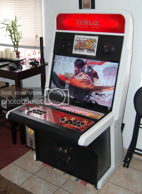

I drew a marquee and a control panel strip that I got printed at a print shop. Real simple stuff inspired by the Taito Vewlix artwork. glued on the artwork onto the control panel and put the sticks and buttons back in:

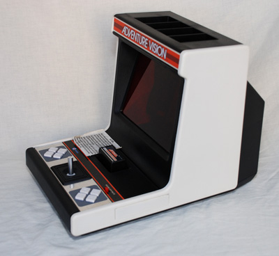

Nice, makes me thing of the 'bastard' child of these two systems:
