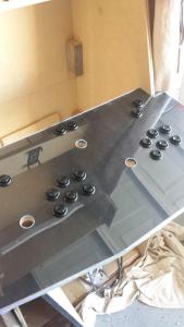

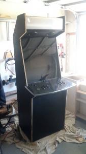

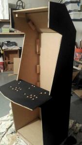

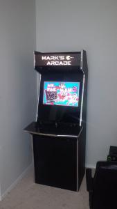

hobohunter2316 Posted March 23, 2016 Posted March 23, 2016 I finished building this cab a few months ago. Just started messing with everything again because im wanting to add light gun games and sega model 3. If you have any question about how i did stuff please ask!. -Its built out of 3/4in MDF. - black gel stain for the color -plexi glass bezel. I spray painted around the screen.looks very slick. Which is a 25?in 16:10 monitor i got off ebay for about $80. -"smart" power strip so everything powers on when the pc does but off the rest of the time. Learning Hyperspin/rocket launche setting up all the emulators was a hugeeee pain. But thats mostly because the PC i used is very old and runs on 32bit XP.(not as much support for that OS) I got dreamcast working to play MVC2. It actually works very well with the old PC. - PC SPECS- Amd athalon 64 x2 3.0ghz 8gb ram. idk the graphics card but it cost about $50. THE BEST THING YOU CAN DO IS GET AN SSD!!!! All the artwork and animation worked SO much better after transferring by build onto one. I see some people who want to use the x-arcade tank stick as opposed to building their own CP. I seriously recommend making your own for two reasons. 1- its very satisfying 2 - you can make it yours! it will be customized to what you want(I wanted a 4way joystick for pacman so i got one) and will look sooo much better.

hobohunter2316 Posted March 30, 2016 Author Posted March 30, 2016 I attacked all mine with wood glue and a nail gun. Just let it sit for a while with the clamps on and its rock solid.
