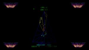

gigapig Posted April 2, 2016 Posted April 2, 2016 Hi score is working if the plugin is selected so that's good. I do like the points where the lines converge on the vector games, that is now pronounced but the overall image is just not bright enough for me, so I will need to figure that out.
Metalzoic Posted April 2, 2016 Posted April 2, 2016 I think the notes say they will be updating the Vector stuff.
