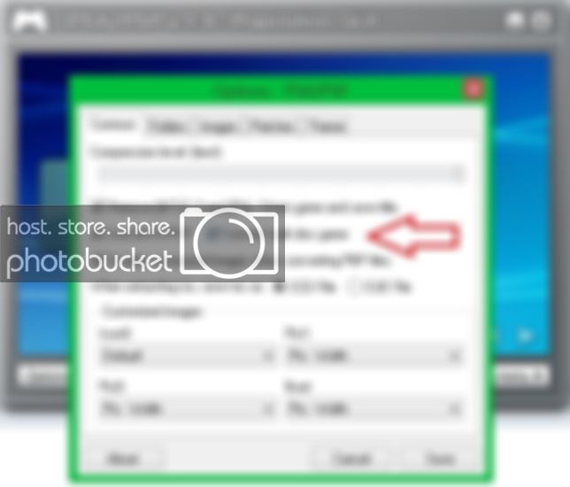

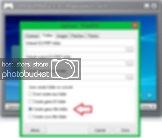

Aorin Posted May 23, 2016 Posted May 23, 2016 I'm actually having some issues with the batch process. For some reason, the program keeps freezing up after the first game is converted. If PSX2PSP is freezing, check if you're using version 1.4.2 which is the latest version, if so, find 1.3 instead as 1.4.2 has bugs in its batch process. In 1.3, check the highlighted options: Also make sure you're converting a single Bin+Cue game, if your game has multiple Bin tracks, you should make it become a single file using the batch process that Iggy shared with us some time ago, I'm sure you'll find such files in the first page of this thread. After you check the above, try the batch again and let us know if it worked. PS: The cue files aren't needed, PSX2PSP will only convert the Bin file to PBP, so you can even remove the cue files for single Bin+Cue games, even those that were multi track bins. One more thing, I assumed you were talking about PSX2PSP when you mention "the program keeps freezing up after the first game is converted", so I'm not sure if it's PSX2PSP or the batch process that converts multi track games into single track games. Aorin

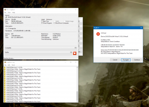

OneBadVeggie Posted May 24, 2016 Posted May 24, 2016 Alright, I've got that all figured out, but now I'm having an error with IMGburn when converting some discs from multi-bin file to a single bin file. I just want to see if any of you guys have seen/fixed/know what this error is. It doesn't happen with every game, and I don't see a correlation either (Other than a few are from the same series, but other games in said series worked fine). Anyway, attached a screen of said error.
Aorin Posted May 24, 2016 Posted May 24, 2016 I don't have any idea of what this error could be, probably an internal IMG Burn error, broken Iso, but probably not a iso problem at all. Anyway, I want to ask you, why don't you use the batch process that make use of Iso Buster instead? I used Img Burn for some games, all worked fine, but in the most part, the batch process I mentioned worked fine, you could try that if IMG Burn isn't helping with some games. Aorin
