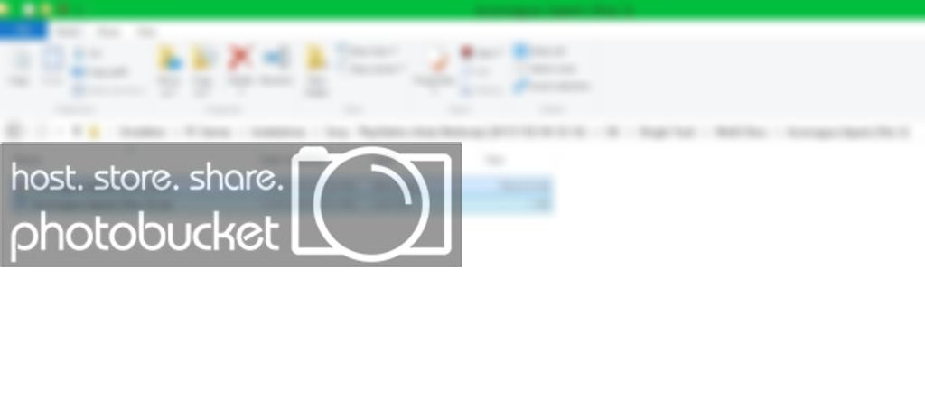

Take, for instance, the Japanese game Aconcagua, this is the size of the game before I compressed it to PBP:

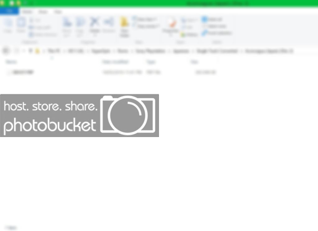

Now, look at the size of the compressed game, basically 1/3 of its full size, surely, as any other iso, the more music the game have, the less compression it will take, but Aconcagua seems to be a game with lots of data, that's why it compresses really well, it almost rivalizes with 7z in most cases, but remember, PBP files don't need to decompress like 7z, so the advantages of PBP over 7z are great.

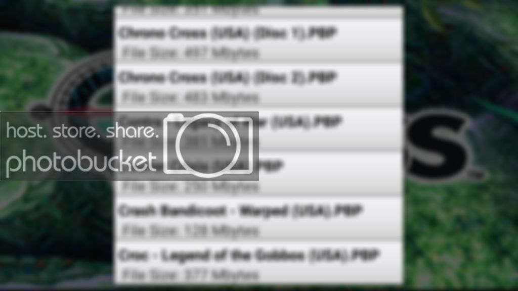

This is a screenshot of EPSXe for Android, just for you to see that PBP is getting support every day, since it's also a great advantage for mobile devices, it saves a lot of space, obviously.
Screenshot_2016-03-20-12-44-12_zpshpm8dm

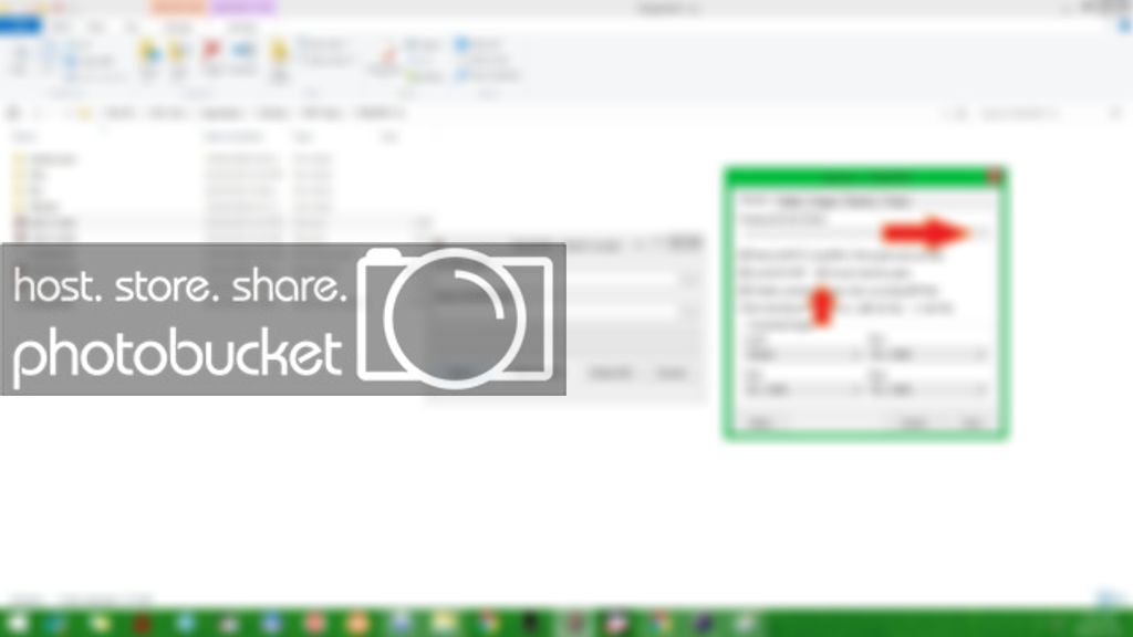

So, now that PBP file is known, I'm going to show how to use the program that also have the batch process to turn the PSX Bins into PBPs, this is the PSX2PSP program 1.3 (Never use v1.4.2 to batch process bins to PBP), you'll see why soon:
Check the highlighted options:

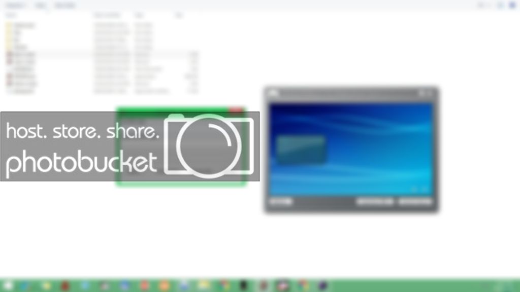

More options to check:
This is what you'll get:
This is what we get, because this program was intended for use in the PSP in mind, so the PBP is inside each folder, so each folder has the game name and its serial code, then inside we have an "eboot.pbp", if we rename this eboot.pbp to something like Chrono Cross (USA) (Disc 1).pbp and put it in the PSP it won't recognize the file, but well, for our use in HS and our emulators, that's what we'll do, rename each PBP file according to our database, just like we do to any other game.

For our use in Hyperspin, each CD should be a separate PBP, so a Chrono Cross game, will have Chrono Cross (USA) (Disc 1).pbp and Chrono Cross (USA) (Disc 2).pbp, so Rocket Launcher will also recognize them.
