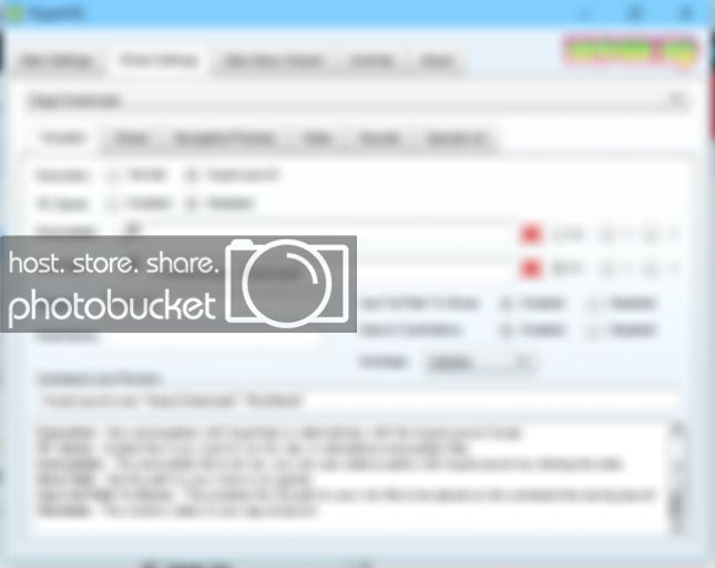

If you want to be able to use the HyperHQ "roms only" function successfully without being booted back to the HyperSpin main menu or crashing HyperSpin follow these instructions:

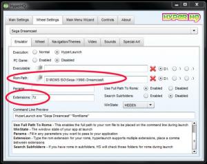

Open HyperHQ > Wheel Settings > [console name] > Emulator;
Execution:	HyperLaunch
PC Game:	Disabled
Executable:	[leave this field blank]
Rom Path:	[your rom path]
Extensions:	7z,zip,cdi
Fill the rom path option then set the extensions of the roms or isos HyperSpin should be checking for by listing them, comma separated, in the extensions field just like in the above sample. Set everything else however you need. Next, go to

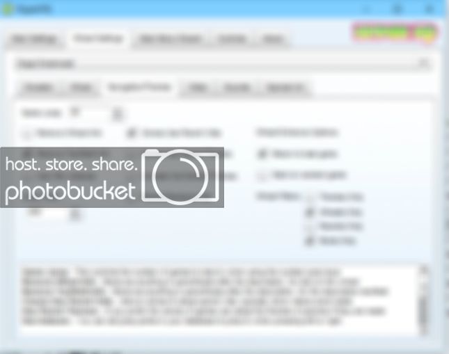

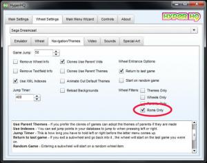

HyperHQ > Wheel Settings > [console name] > Navigation/Themes;
Wheel Filters:	Roms Only
Other users were getting a crash or boot back to the main menu because the extensions were not set. HyperSpin was not knowing what to look for. The error is not related to searching subfolders nor to the rom path set by HyperLaunch. You can fix this entirely within HyperHQ.

I have attached a sample for those of you that need a visual help.

For anyone else having same issue open HyperHQ -> Wheel Settings -> Sega Saturn -> Navigation\Themes -> Wheel filters = uncheck all.

You need to put the extensions in the Extensions filed, not the Params field! :-)
