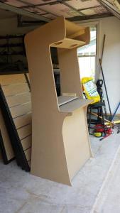

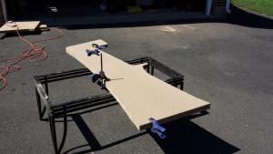

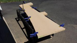

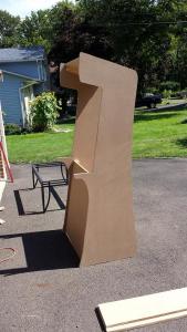

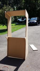

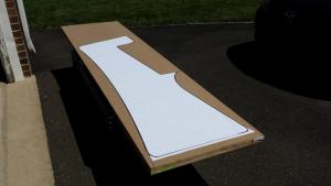

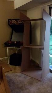

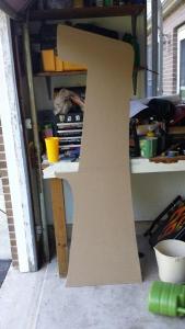

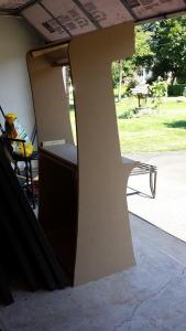

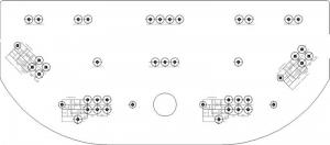

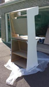

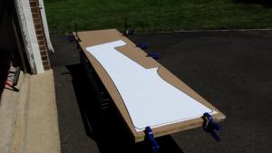

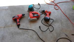

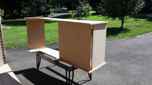

tkropp17 Posted August 26, 2013 Posted August 26, 2013 I decided to start a new full-size cab since my last build. I went with a 6ft version of RidicRick's ArchAngel build. His build and MK9 coming out on PC are where the inspiration came from for this cab. 32" LED Insignia TV xbox 360 MK9 control panel i5, 4gb ram HP laptop Special Thanks RidickRick for his build plans Jumpstile for helping out with MAME builds and random questions Mockup Basic Tools Printed $4 layout (FedEx printed this from a pdf) Clamped Down & Screws added to keep it in place First Cuts Cut out the control panel base to a nice curve instead of that box Sides are done! Build - Had Home Depot do three 30 inch wide cuts in a sheet of MDF So Close!!! My Builds Apartmentcade Custom Mortal Kombat Hyperspin Arcade Build Half-Top Arcade Build

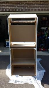

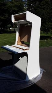

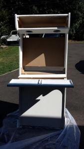

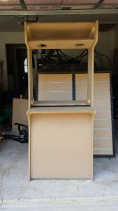

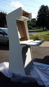

tkropp17 Posted September 15, 2013 Author Posted September 15, 2013 Some updates from this weekend My Builds Apartmentcade Custom Mortal Kombat Hyperspin Arcade Build Half-Top Arcade Build

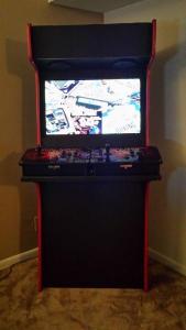

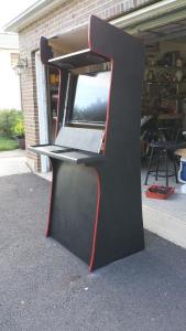

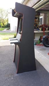

tkropp17 Posted September 20, 2013 Author Posted September 20, 2013 Just needs a few minor touches (like a real marquee) then it's done! My Builds Apartmentcade Custom Mortal Kombat Hyperspin Arcade Build Half-Top Arcade Build

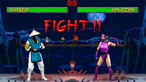

tkropp17 Posted September 26, 2013 Author Posted September 26, 2013 I need some help for Marquee ideas. I'm thinking about keeping it simple, maybe a black marquee that in red says FIGHT!! or FINISH HIM!! in MK font. I can't find this font though. If you can help, let me know! Thanks! My Builds Apartmentcade Custom Mortal Kombat Hyperspin Arcade Build Half-Top Arcade Build
Pyramid_Head Posted October 16, 2013 Posted October 16, 2013 Tried any of these? http://www.mortalkombatwarehouse.com/site/fonts/
tkropp17 Posted October 16, 2013 Author Posted October 16, 2013 I did, but none of the F's are the same and the fonts are a little different. I found Fight images for MK9, so I think I'm going to go with one of them. Picking up a Jtagged 360 this weekend so I can get MK9 back in here. Who knows if I can get it to launch through Hyperspin though... Seems like A LOT of work! My Builds Apartmentcade Custom Mortal Kombat Hyperspin Arcade Build Half-Top Arcade Build

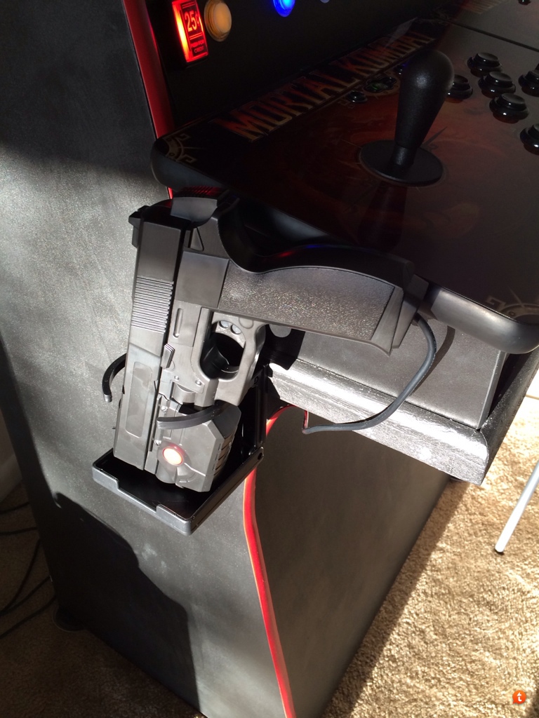

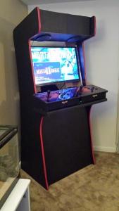

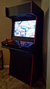

tkropp17 Posted January 27, 2014 Author Posted January 27, 2014 Wanted to post a few updates. This was a learning experience for me. Eventually I'd like to rebuild to incorporate my learnings and use the same hardware. Now includes a JTag 360. I have two 360 controllers and kinect in addition to the MK controls. I have a rocksmith cable, thats why there is a pic of the bass Aimtraks are next. When they come in, I will relocate the kinect and aimtrak sensor to be above the monitor, behind the glass. 14/01/27/jede8uga.jpg[/img] Sent from my iPhone using Tapatalk My Builds Apartmentcade Custom Mortal Kombat Hyperspin Arcade Build Half-Top Arcade Build
lukensteinz Posted January 27, 2014 Posted January 27, 2014 Very nice! Quite clean. What do all the glowy buttons do? Do they get annoying? (I'm a welder by trade so I naturally shy away from bright lights in my peripheral vision) Sent from my LT26w using Tapatalk My Mortal Kombat, Vewlix style build. [sIGPIC][/sIGPIC]
tkropp17 Posted January 27, 2014 Author Posted January 27, 2014 Very nice! Quite clean. What do all the glowy buttons do? Do they get annoying? (I'm a welder by trade so I naturally shy away from bright lights in my peripheral vision) Sent from my LT26w using Tapatalk Thanks! Those are Hyperspin and MAME controls. Green is Start, Red is Exit, etc, I'd like to get labels on them. They're actually not as intense as they look in the pictures. I think if I had better lighting you could see there is much less glow. My Builds Apartmentcade Custom Mortal Kombat Hyperspin Arcade Build Half-Top Arcade Build

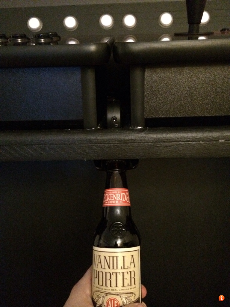

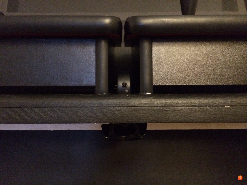

tkropp17 Posted February 8, 2014 Author Posted February 8, 2014 My latest addition. Black Plain STARR "X" Wall Mounted Bottle Opener http://amzn.com/B0049NH7OQ Sent from my iPhone using Tapatalk My Builds Apartmentcade Custom Mortal Kombat Hyperspin Arcade Build Half-Top Arcade Build
AshuraX Posted February 8, 2014 Posted February 8, 2014 Good idea! My WIP Projects :Bezel Project Mame Horizontal : https://imageshack.com/a/auM4/1 Mame Vertical : https://imageshack.com/a/jEM4/1 Cave full pack : https://imageshack.com/a/7eJ4/1 Capcom : https://imageshack.com/a/eIM4/1 Themes Neo Geo Full Theme Pack : https://imageshack.com/a/oeJ4/1Mega CD Boxart : new thread will come....My First Cab Build : http://www.hyperspin-fe.com/topic/1221-ashurax-mon-projet-ghouls-ghost-arcade-cab/
JFlash3785 Posted February 9, 2014 Posted February 9, 2014 How did you get the t modeling done without a router?
tkropp17 Posted February 9, 2014 Author Posted February 9, 2014 I bought one from lowes then returned it later Sent from my iPhone using Tapatalk My Builds Apartmentcade Custom Mortal Kombat Hyperspin Arcade Build Half-Top Arcade Build

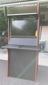

tkropp17 Posted September 19, 2014 Author Posted September 19, 2014 Sneak peak My Builds Apartmentcade Custom Mortal Kombat Hyperspin Arcade Build Half-Top Arcade Build
