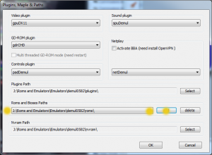

gigapig Posted October 26, 2013 Posted October 26, 2013 No, I have it working. Changed my paths in HLHQ then set the usual in Demul. Did you set your path to the Roms and bios? The bios being in your Rom folder.
JoeC3109 Posted October 26, 2013 Author Posted October 26, 2013 Yea I did. I have them in separate folders, but I added both folders. Now when I load a game, I get the bios screen, and when I hit play it says please insert game disc. I'm not sure which step I am missing
JoeC3109 Posted October 26, 2013 Author Posted October 26, 2013 Got lucky and figured it out. I just changed my bios for dream cast. It worked somehow

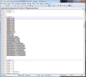

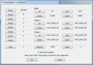

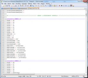

gigapig Posted October 26, 2013 Posted October 26, 2013 I too use 360 pads. I set buttons/analogue/digital, in the controls section of demul for jamma_0 & jamma_1. I then transfered the data from the Demul pad ini into the Demul 57 ini, which is in the modules folder. Just copy and pasting each one for each control system. So HL will inject the controls directly into the Demul ini Why aren't yours showing up?
JoeC3109 Posted October 26, 2013 Author Posted October 26, 2013 I'm not sure. I semi follow what you're saying. Is the Jamma O and Jamma 1 in the module section that you can edit? I believe I understand the part about transferring the info to the modules folder Demul ini. I will try what you're saying, but admittedly I'm not sure I completely understand, I'm not very tech savvy.

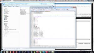

gigapig Posted October 26, 2013 Posted October 26, 2013 So how are you setting your controls? This is arcade Joy 1. That gets written in to the padDemul.ini I then copy and paste that into the Demul (v0.5.7).ini Demul (v0.5.7).ini is located here Once added will show up in HLHQ Whatever _JAMMA0_0 relates to player 1 Whatever _JAMMA0_1 relates to player 2 I will put my ini's in my ftp for you to have a look at.

JoeC3109 Posted October 28, 2013 Author Posted October 28, 2013 I figured out my problem. Again, just oversight on my part. I didn't set the S1 Up/Down/Left/Right buttons. Those work in game for me, for whatever reason. Thanks for all the help again

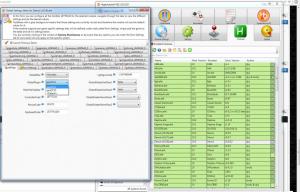

yeseye Posted January 15, 2014 Posted January 15, 2014 Hi All sorry to hijack this thread but can anybody help me in adding extra gpu settings to the video plugins? i can only get this running smoothly using gpuDX10 but it is not supported when using the Demul (v0.5.7).ahk, so when starting hyperspin it defaults to gpuDX11 which on my setup doesn't use h/w only s/w. thanks
PiraHC Posted January 15, 2014 Posted January 15, 2014 I had no problem using 56 module to Naomi and 57 module to Atomiswave in 582, but I'm on HL2.25c
gigapig Posted January 15, 2014 Posted January 15, 2014 Hi Allsorry to hijack this thread but can anybody help me in adding extra gpu settings to the video plugins? i can only get this running smoothly using gpuDX10 but it is not supported when using the Demul (v0.5.7).ahk, so when starting hyperspin it defaults to gpuDX11 which on my setup doesn't use h/w only s/w. thanks Have you thought about upgrading to Demul 0.58.2? You can then set yours to DX10.
Sir Cyrano Posted January 15, 2014 Posted January 15, 2014 Demul sucks, is a shit. There isn`t better emulator ?? I think Demul is the emulator more hate.
yeseye Posted January 15, 2014 Posted January 15, 2014 Have you thought about upgrading to Demul 0.58.2? You can then set yours to DX10.[ATTACH=CONFIG]37085[/ATTACH] Hi gigapig I am using demul0582 but where do i find the right .AHK as i haven't got this in my hyperspin setup. thanks
gigapig Posted January 15, 2014 Posted January 15, 2014 Hi gigapigI am using demul0582 but where do i find the right .AHK as i haven't got this in my hyperspin setup. thanks If you don't have it then your not updating your modules and Hyperlaunch via GIT. It's very important to do so, for starters having the modules updated will have bugs fixed and added features. Secondly asking for help if your using an outdated module, will get you on the naughty step I did resist setting it up myself for a while, but like most things Hyper related, I was very happy I did. It's very easy to setup, just follow the guide very closely, and if in doubt; ask. Lets not forget the link. www.hyperspin-fe.com/forum/showthread.php?27528-HyperLaunch-GIT
