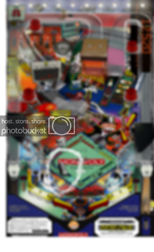

Guest rossicomputers Posted August 18, 2009 Posted August 18, 2009 BBB, Everyone experience slow motion ball and flippers.... I Have power machine.... Change the Yield settings to 0( DO NOT WORK) As you can see below the ball chops! Any help welcome Rossi.
