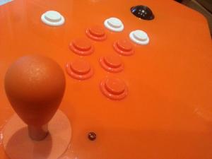

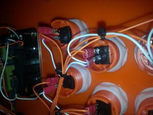

gigapig Posted December 5, 2013 Posted December 5, 2013 I bought these in Orange to match my CP. Fantastic for the price and very quiet. I did have your type (Microswitches) but gave them to someone else. Arcade shop doesn't stock these, they have similar but you need to buy the leaf separately. Arcadeworlduk ship anywhere. For the price of these it may not be worth buying grease and messing around. Give you idea of the connection type.

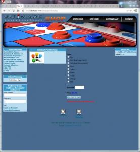

gigapig Posted December 5, 2013 Posted December 5, 2013 Looks like Ultimarc have dark blue Leaf switches to match Happ.
mono Posted December 5, 2013 Author Posted December 5, 2013 gigapig said: Looks like Ultimarc have dark blue Leaf switches to match Happ. Many thanks for the effort you are spending in this thread. I checked the link you provided, but all i could find was "Classic Pushbuttons from Happ Controls" (dark blue, but basically the ones I already have) and "GoldLeaf Pushbuttons" (discussed before, great but their blue is light-blue). I also googled a little. Still I cannot really find the kind of button I want, but I found out that I should maybe switch to convex buttons according to this site: http://www.slagcoin.com/joystick/attributes_brands.html said: I tend to prefer flat convex buttons. Concave buttons can feel a bit awkward because you can bump the edges of the buttons as you move your fingers around. And worse, when you press a more sloped part of the button, the button pushes into the side of the cylinder adding more friction. Convex buttons do not really have these problems.
gigapig Posted December 5, 2013 Posted December 5, 2013 The Ultimarc Website could do with a big overhaul with more detail. When I clicked the gold leaf option and added it to my cart, it gave the option for Dark blue (Happ Match?) The only way to find out is to email. They are very helpful by all accounts. I prefer the concave button, purely because of nostalgia. They must have been on the early arcade machines. So that's your cab is it, the Fire & Ice one?

mono Posted December 5, 2013 Author Posted December 5, 2013 gigapig said: The Ultimarc Website could do with a big overhaul with more detail. When I clicked the gold leaf option and added it to my cart, it gave the option for Dark blue (Happ Match?)The only way to find out is to email. They are very helpful by all accounts. So that's your cab is it, the Fire & Ice one? Thanks - you are my hero of the day! I clicked the item, but I did not think about adding them to my cart. I will mail them in the evening asking for a color sample/picture of the dark blue ones - What a pity to order from USA - 27€ goods + tax&delivery = 51€ Yes, Fire&Ice is my custom build - I love it @Polemicist: Thanks for your detailled explanation - I think I already decided for new buttons - and I guess I'll stick to old school-non-illuminated buttons

mono Posted December 6, 2013 Author Posted December 6, 2013 Just received an email from Ultimarc. They assure that "Dark Blue" and "Red" variants will match the Happ/IL/ILSA button colors Also the button diameter is matching. I will place my order as soon as I manage to convince my wife that spending even more money on the cab is worth it.
