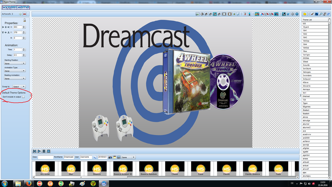

Kortoga Posted April 21, 2016 Author Posted April 21, 2016 One question, I am trying to add Artwork for 3D Boxes. I added the 3D Boxes to Artwork 3 folder in the relevant system's Themes/Image/Artwork3 folder. I then added Artwork 3 to my HyperTheme and pointed it towards a 3D Box in the Artwork 3 folder. But when I run the Theme in Hyperspin the 3D Box art does not change, it stays the same box artI choose when creating the theme in HyperTheme. What am I doing wrong? Thanks...
Black Hazor Posted April 21, 2016 Posted April 21, 2016 there is a default theme option on the left u have to click
Kortoga Posted April 21, 2016 Author Posted April 21, 2016 Wham Bamm, Thank you Man! Check it, you wreck it, lets Begin Party on, Party people, let me here some noise... Thank you, didn't know what that selection did, and was afraid to ever use it because of the warning it pops up when you click it.
